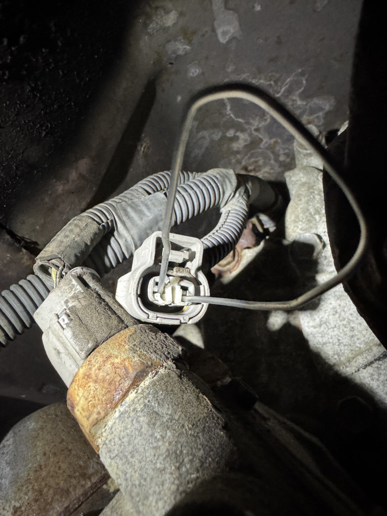

    So we need to check the 4wd Detection Switch circuit, unplug the 4wd switch on the back of the Transfer Case Actuator and jump the pins with a small wire or paperclip (careful not to spread the terminals) then verify 4WD (B22) goes to 0v at the 4wd ECU.

    So I THINK I did what you said and I still have 11.4v at B22 on the ECU. I say I think because I wasn't sure which side I should jump. I jumped the two pins on the wire. Is this right?

    If your on the right connector (should be the one with the Red/Blue wire), looks like an awfly big wire your using.
