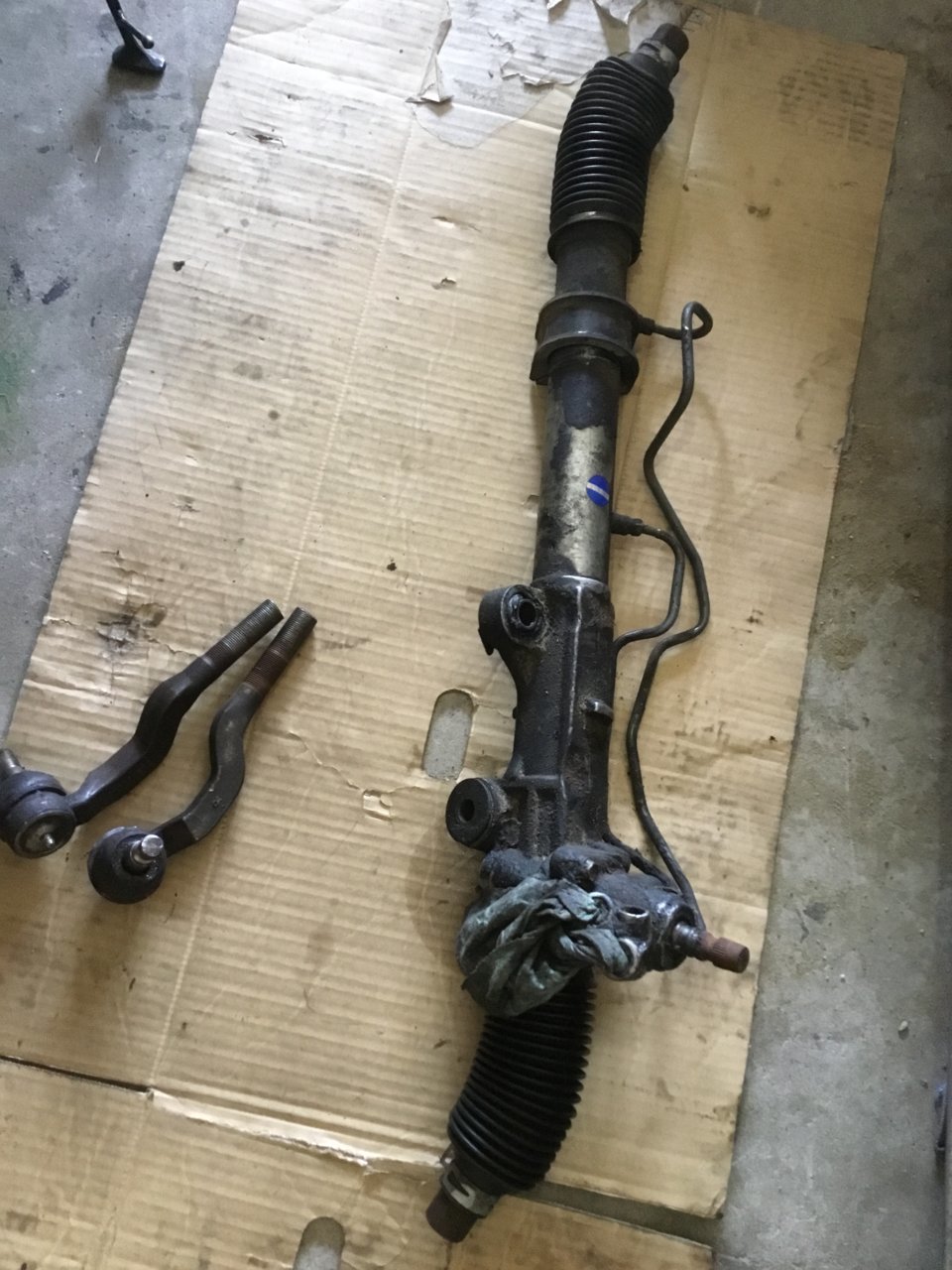

    Thanks guys. Yea the job took me a bit longer than planned of course as usual but got it done and now the steering is way better.
    For the inner fluid line going into the rack, DEFINITELY easier getting the flex head version of the flare nut wrench. I didn't have the flex head and was kind of a bitch but still was able to get the line loose (had to point the wrench vertical). I should've bought ahead of time, it's hard to find, and since bought this one for any future jobs: https://www.ebay.com/itm/332745988678
    Also, the rag joint was kinda stuck and rusted onto the rack, took a lot of pb blaster and slowly tapping on all sides to get it off.
    I did put in one of those magnefine filters per Timmah's recommendation, along with taking off the reservoir and cleaning the screen. There was still quite a bit on the inside on the screen I just couldn't get out but did seem to get some of the gunk out. Replaced the o ring too.
    FYI, another problem I ran into is the "3/8" return line hose toyota has is a different ID than like 2 other types of power steering hoses I got from oreillys. The Toyota one has a larger ID (I ended up replacing the whole return line from the metal line to the power steering pump, was really old). The packaged, precut "power steering return hose" was NOT the correct size at all and had to go back to the store, even though it said 3/8". The one they have to cut from behind the counter was much closer to the size I needed and worked. They all said 3/8" but all had different looking ID
    I was planning on trying to flush the power steering, but I figured when I disconnected both fluid lines from the steering rack, most of it should've drained out, so I didn't bother. I put in the regular valvoline dex 3 reddish power steering like in Timmy's video.
    I do have a diff drop and it's true, you have to take the spacers out, jack up the diff in order to get the long horizontal bolt out.
    Also, I'm not sure why, there is still a slight clunk I feel in the steering sometimes. When I took it to the alignment shop after, they said my lower control arm bushings are shot (I just replaced those with new arms like 1.5 year ago) so not sure if it's that or something from the rag joint above from the steering rack somewhere...?
    Happy Thanksgiving everyone
    Old rack and tie rods free to a good home
    TWJLee likes this.
