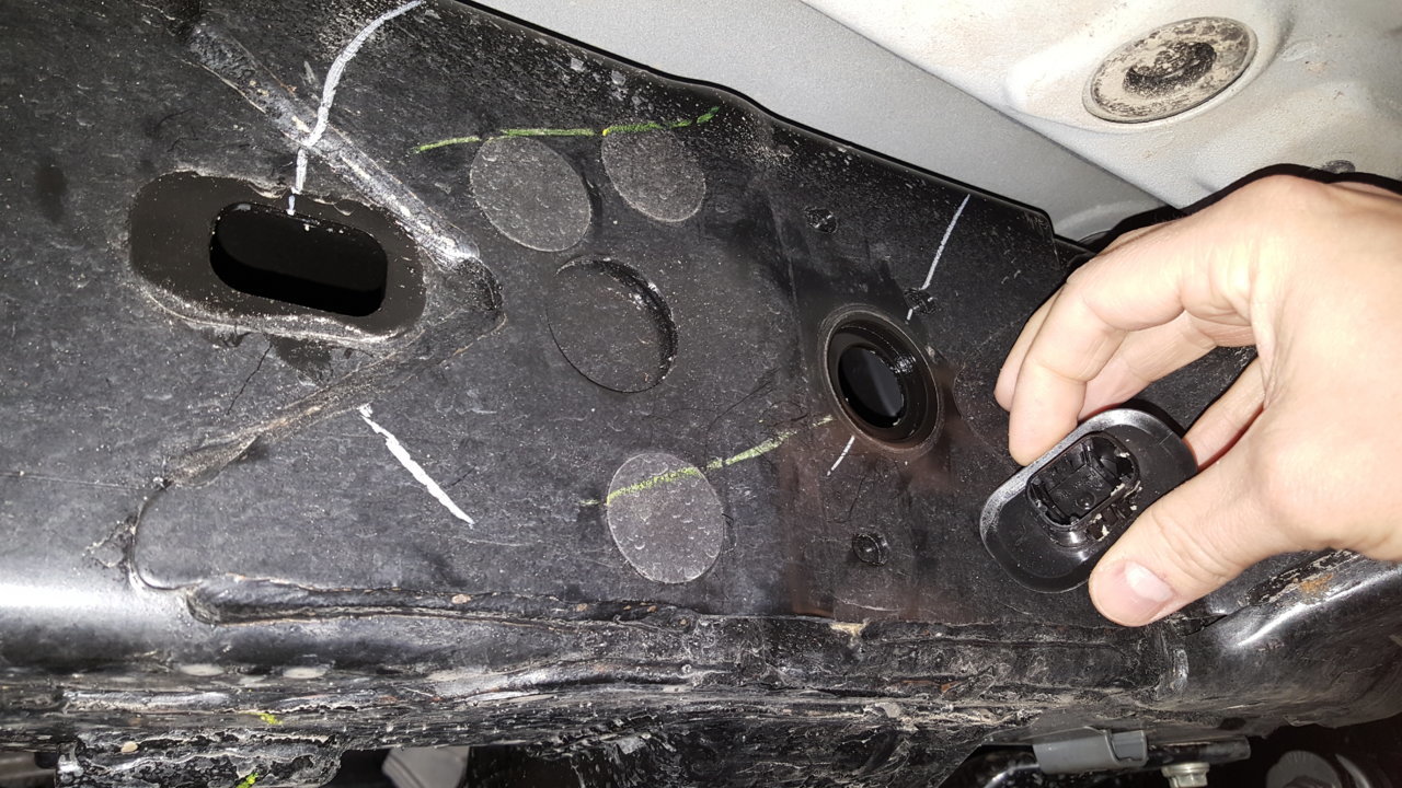

    2 of the mounting holes in the frame are obscured by plastic fillers that clip on through the frame. They are hard to see if the frame is dirty. The front-most filler cap has 4 clips in the back and is a real pain to get out.
    BTW, I wiped the mounting surfaces on the frame with a rag misted with some WD-40 to get the dirt off.

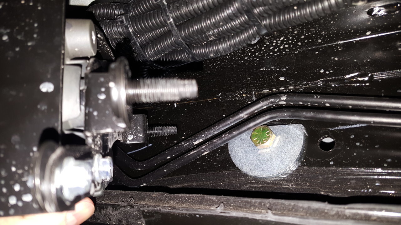

    The rear bolt on the driver's side comes out between 2 brake lines. It was a pain to get in. I wrapped the nut and bolt threads with some double adhesive foam tape to help prevent rubbing.20190216_184812.jpg

    In the middle of the driver's side there is a bracket on the outside that has to be removed and an electrical box on the inside of the frame (not mentioned in the instructions).
    The bolt would prevent the box from being re-mounted if I had left it with the threads pointing in as RCI's instructions said to do. I put a backer on each side and had the bold head on the inside of the frame so the electrical box would fit back correctly. Also put some foam tape over the bold head to prevent any rubbing on the brake lines.

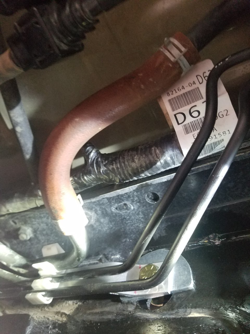

    Some photos of how I dealt with the brake lines.

    So in the above picture, I ended up cutting the bolt and making it much shorter as it prevented the reinstallation of the electrical unit that was there. 3 min with the dremel metal circle did the trick. I also added 2 washers to the bolts that pass through on the left and right and fits perfectly.
    However, I still am struggling with the driver side hole behind the above picture. I am VERY hesitant to "split" the brake lines or pass the bolt thru.
    Not sure how RCI will deal with this but on a 2019 DCSB OR...this is a struggle point for me.

    I put the bolt in as shown above then cut some 3/8 fuel line and tie wrapped it to the line to protect it. It wasn't touching, but reeeeeeal close, so I added the fuel line. I popped the white retainers out to get it installed and back in once tight.

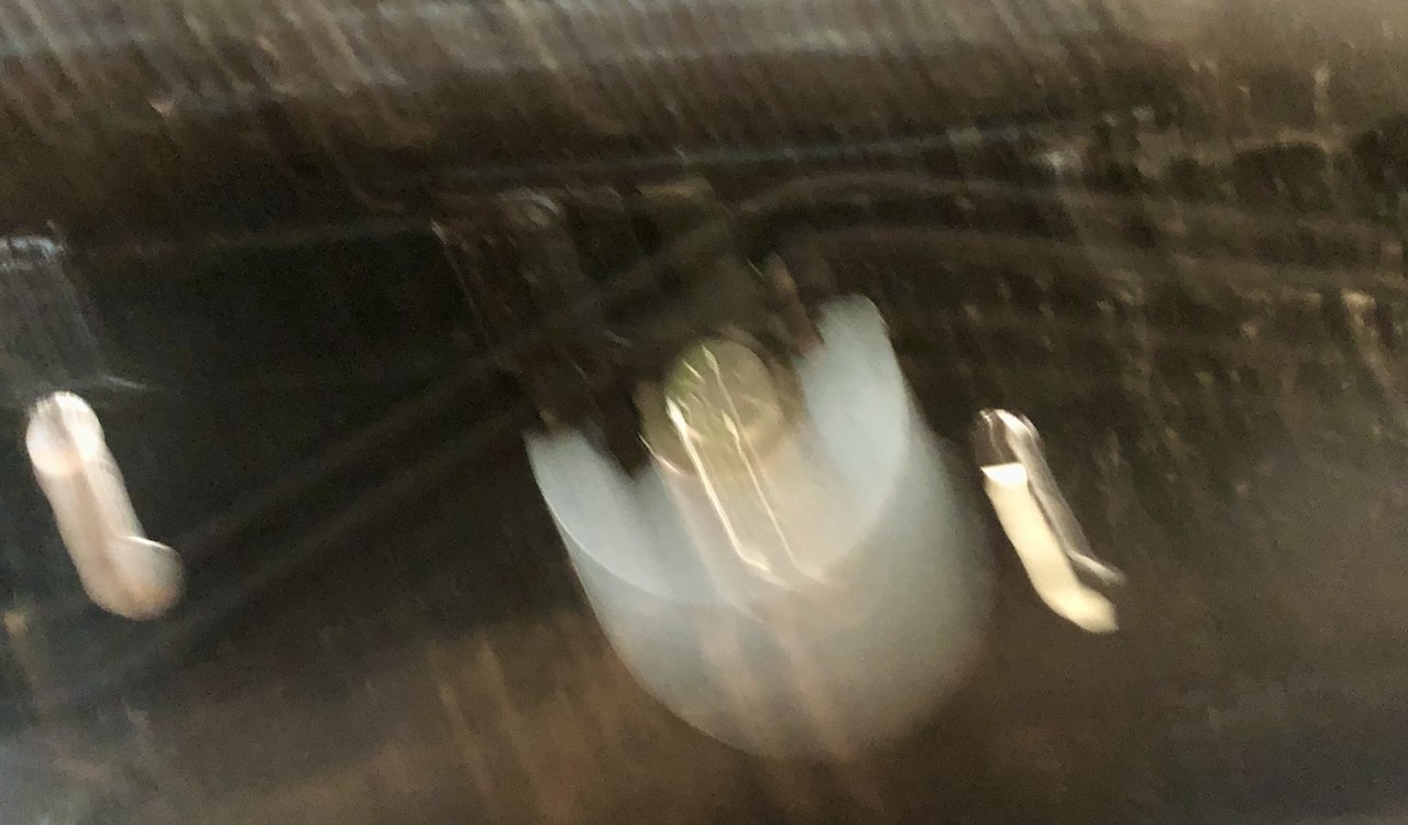

    I just finished installing these on my 2020 TRD Pro.
    On the driver side I had to put one bolt through in reverse like @BrokeDownSouth and @pinem56. I also had to skip a bolt in the rear because it came through right between the 2 lines and I wasn't comfortable splitting them apart with either a bolt head or washer. No issues at all on the passenger side.
    I tried to take a picture of my reversed bolt and rubber tubing wrap job but it turned out super blurry :/ I may redo this soon with a shorter bolt instead. Didn't have a cutting disc for the grinder yesterday.
