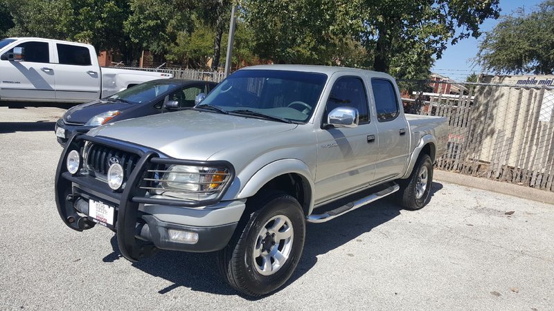

    image.jpg Just bought a 2001 Tacoma double cab 4x4 limited TRD. What a search it has been. I did not realize how rare these trucks are. Luckily I was able to get the color I wanted also silver. As of now I have purchased a 6" fab tech lift, 34" trail grapplers, and some wheels yes 20's. I know most of y'all don't like them but it's a pavement pownder with a few trips to the beach. This truck is auto V6 with stock 4.10 gears. I plan on keeping between 33" and 34" tire. What would be the best all around gear. This for mainly highway and around town driving. I've been doing a lot of reading. I'm thinking a 4.56. All input would be great help. Here is the truck.
