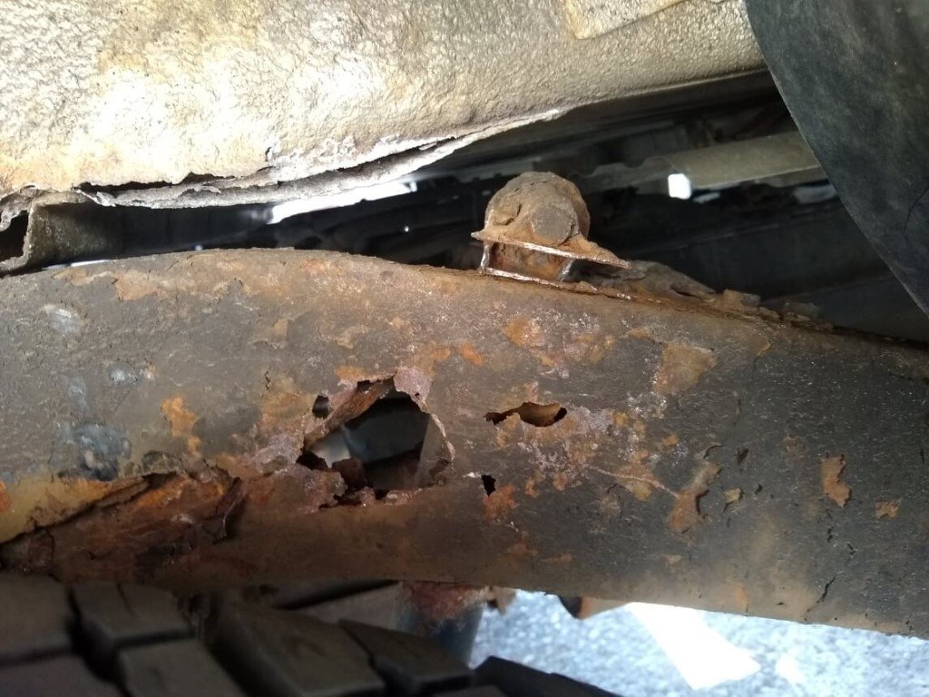

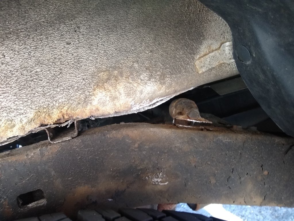

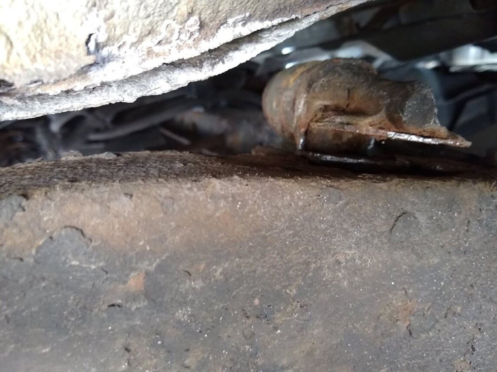

    My 2004 just started making a noise in the rear. I found my rear passenger side shock mount ripped out of the frame.
    My frame wasnt under the recall according to toyota when i checked a couple years back....
    Not sure what to do now. Truck doesnt even have 200k on it. Got new tires about a year go
    Is it garbage? I have to continue to drive it like this due to it being my only car.
    I cant beleive they can get away with this. I have never hauled anything heavy and never towed anything. IT has been a pretty light use truck over the years.
    I wonder if i welding/fabrication shop could weld a new sleeve/mount there or something.

    here is another angle.....and yet another after beating the shit out of it with a hammer....
    its fucked.

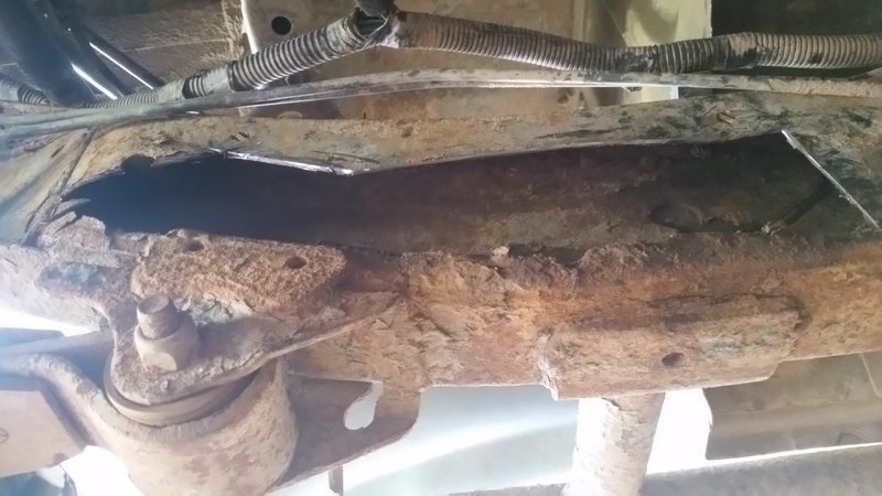

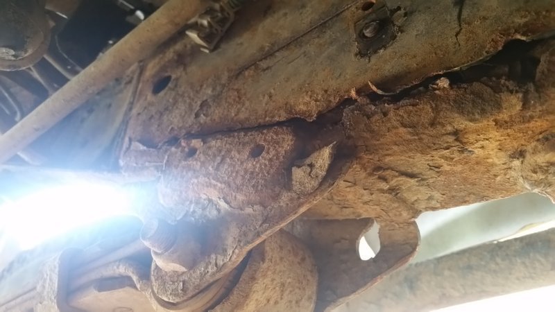

    Mine looked the same on the frame rail. I fixed it by cutting the frame rust out and welding some frame reinforcement plates over it from trail gear. I can probibly guarentee its rotted out down by the fuel tank on the inner frame rail as well. I would pull the bed off and make a scab plate and weld the shock mount back to the frame and put a plate over it. I'm thinking of building a whole new rear frame from the rear of my cab back this upcoming fall.
    Heres what your frame rail probibly looks like by the fuel tank:
