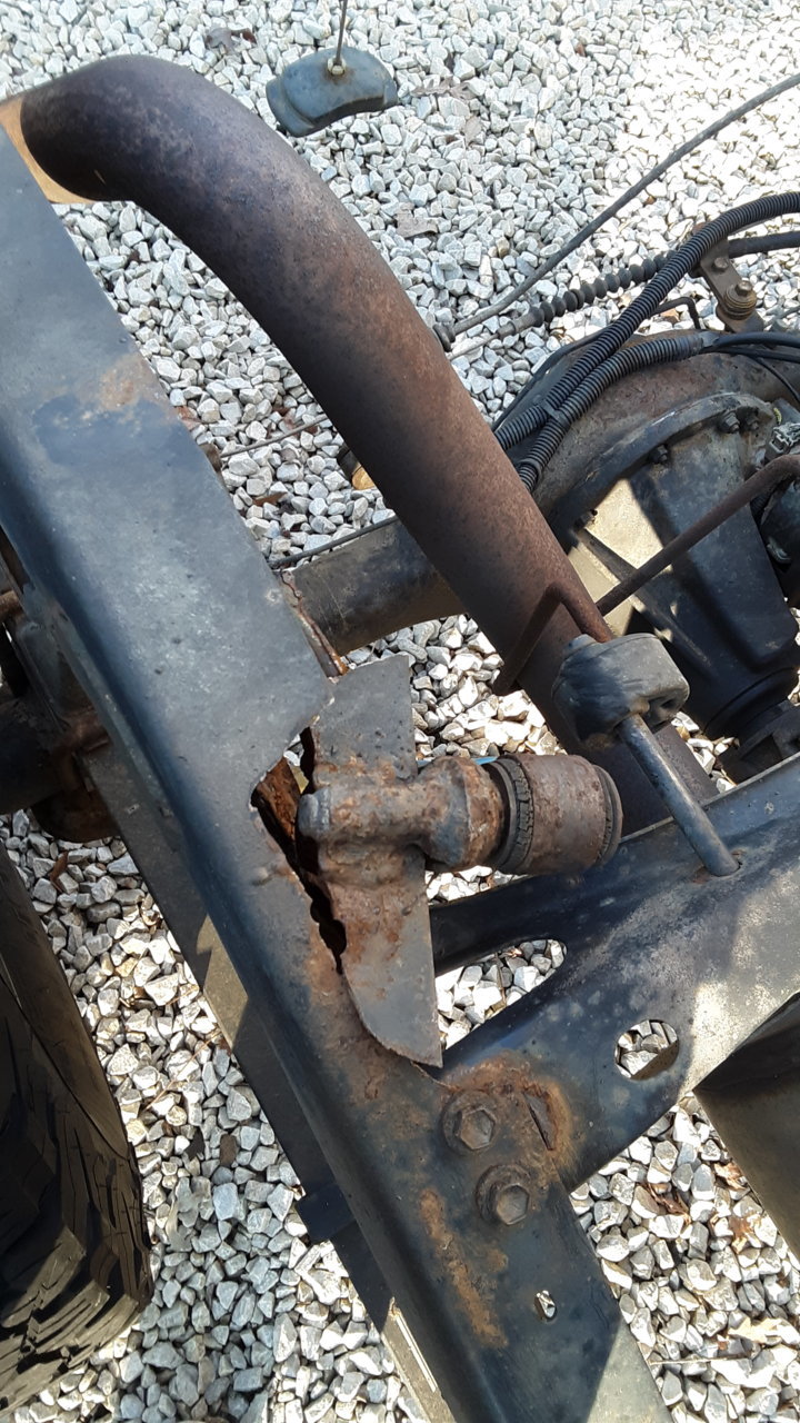

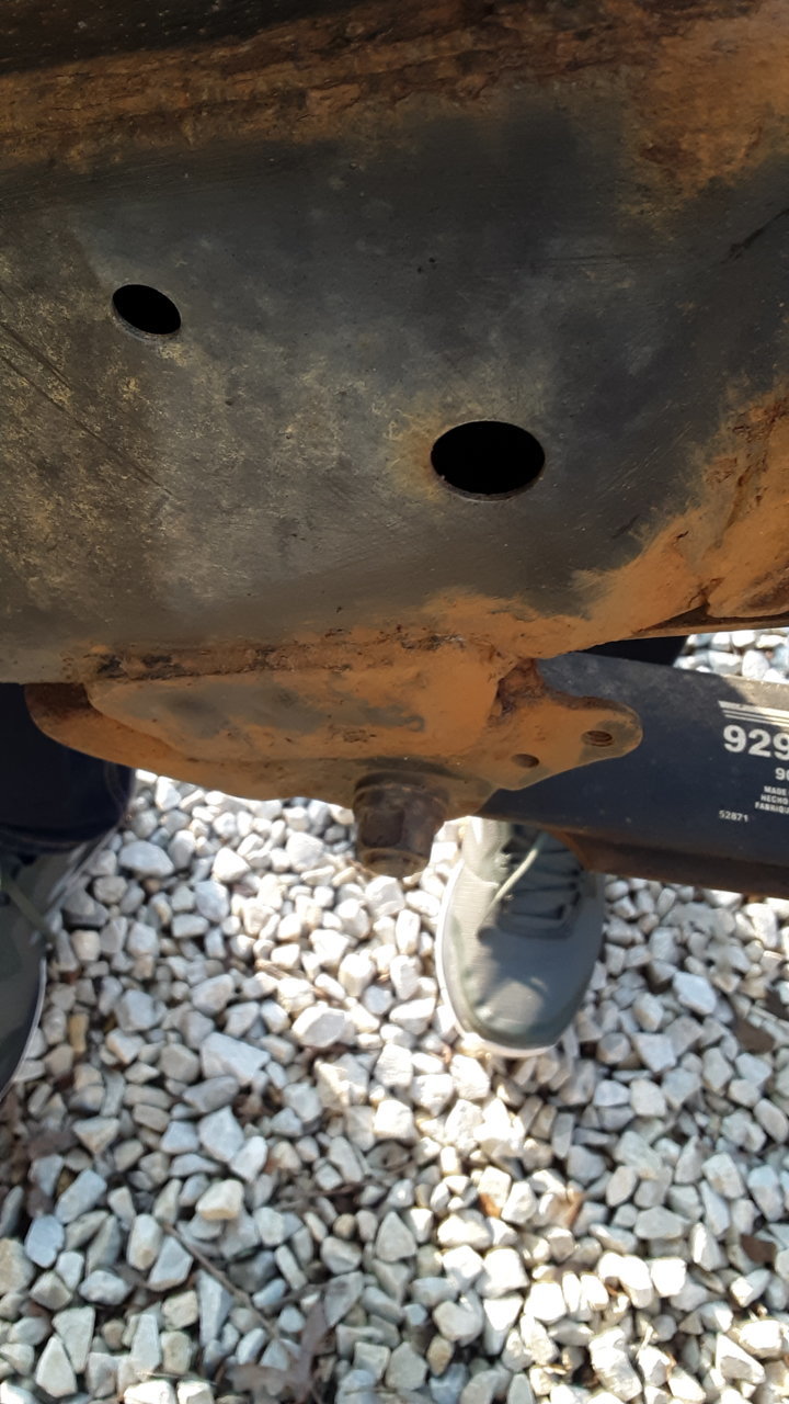

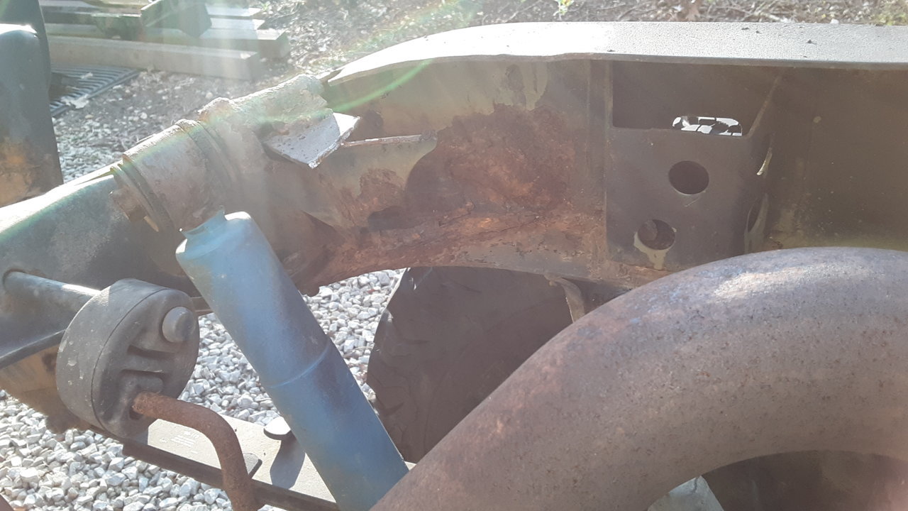

    1996 --- the reason I went out and bought a 2020. This 96 is my sons truck he was away for air force training for 6 months and asked me to drive it every week rather than just let it sit. I put about 1000 miles a month on it and then right before he came home I heard clunking coming from the rear passenger side. Crawled under -- frame snapped at the shock mount. I went out and bought a 20 sr and gave him my 02 so he had something to drive. Heres pics
    Pulled the bed to assess the frame. Drivers side seems pretty good. I'm wondering if I should get the autorust safe t cap? Anyone have suggestions. I'm also wondering if the leaf spring hanger in that last pic is the next victim.. any thoughts before I start trying to fix this mess????

    The trouble is you strike an arc and find out fast that you have no good metal anywhere near .

    Great.. wonder if I should do a reinforcement plate that is custom fabbed instead. I would like to get those safe t caps and be done with it. Seems like a pretty good option but I don't want to buy the replacement cap only to find out that I can't use it

    The rot really only seems to be concentrated in that one area. Drivers side looks and feels solid

    same here. Drivers side seems ok....but the passenger side is in the same shape as yours. Ripped completely out.
    Seems like an odd way to mount the top of the shock. its mounted thorugh the frame on the drivers side. The passengers side they welded it do the top of the frame.

    I'm probably going to get the safe t cap and shock mount and give it a try. I'll keep my fingers crossed on the leaf spring hanger section of the frame.
