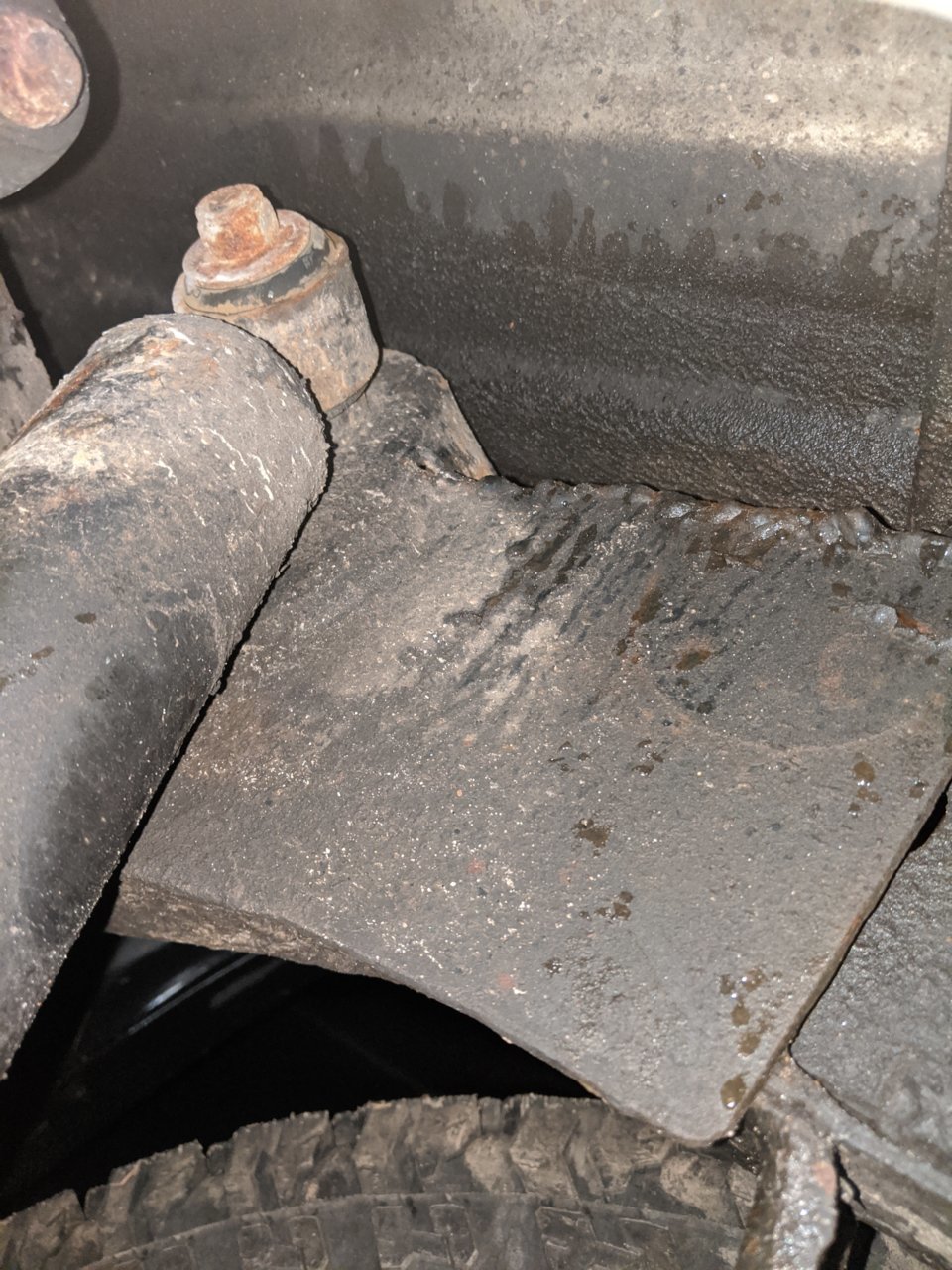

    Same thing happened to me, passenger side. I believe I got the autorust weld on bracket: https://www.autorust.com/product/upper-rear-shock-mount-passenger-side-4wd-tac-161u4-r/
    $300 for my mechanic to weld it on. No issues since, that was April 2019
    From finding out what it was to totally fixed was 2 weeks or so. Plus a week or two before of assuming the new clunk from my rear end was my exhaust, the rearmost hangar was gone so I assumed it was just smacking the leaf pack. Wowee was I freaked when I saw the shock just free. Took it off immediately and came here for advice.

    Yes the weld on shock mount, it's a plate that covers all that has been turned to Swiss cheese. I think that's the one I linked on autorust.com. If you're unsure about what to order send em an email, they were really friendly when I anxiously emailed to make sure it had sent.
    Here's a SHITTY pic of the thing, w a little extra plate my mechanic added. I did a shit job of undercoating this past year and so there's some rust rash, but this is at least an idea of the fix. IMG_20200426_215812.jpg
