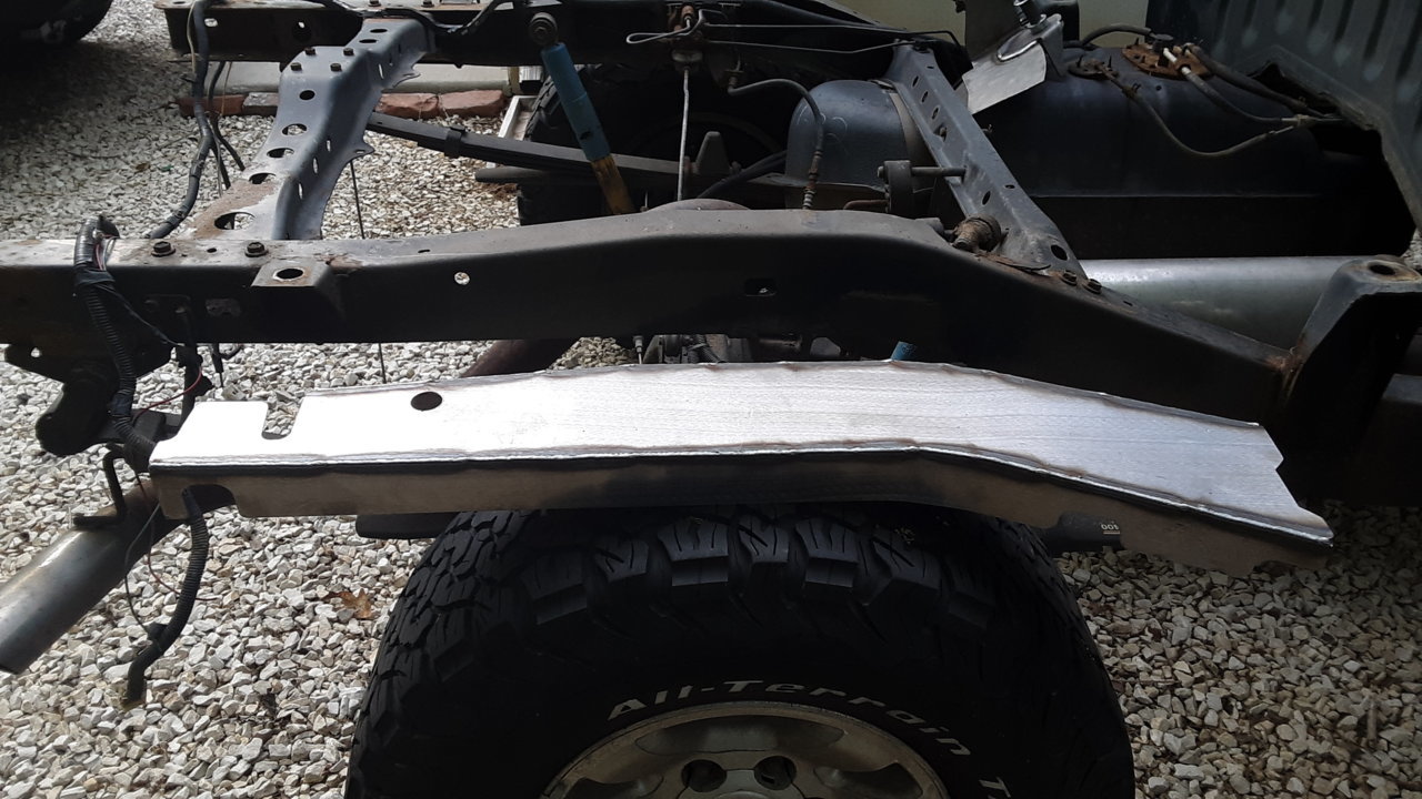

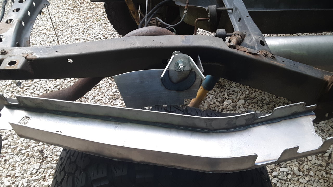

    Here are pics of what I bought. I have a feeling its gonna work out fine for my truck. I'd put the cap on fully, but it requires the bump stop to be cut and I didn't cut anything yet. The stuff appears to be good quality and it's just as thick as the original frame, so if you can make it work and paint it up you'll get some extra life.20200524_180628.jpg 20200524_180557.jpg 20200524_180436.jpg
    I'll be posting pics of my progress. Not sure if you got the cap or not, but it may be worth it to investigate. Hopefully these pictures help

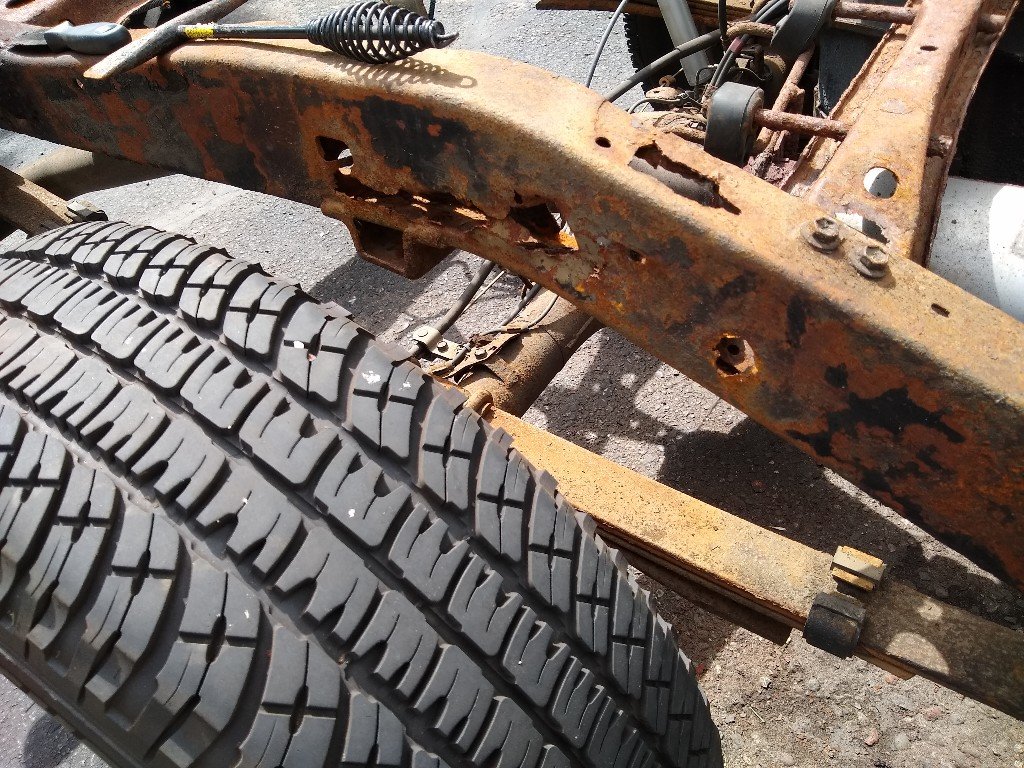

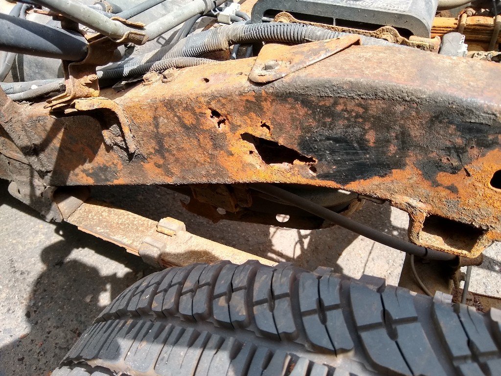

    finally found time to get the box off. The passenger side is the worst but the drivers side has holes as well.....
    I got the safe-t cap kit for the passenger side but not the drivers.
    I dont really want to drop the tank to do the drivers side and welding that close to the tank would likely fix all of lifes problems.
    I have been smackin the rust of with a welding slag hammer....and this is how it came out after about 3 hours.
    What a mess.
    This is what toyota calls a recall........my truck went back and was "coated" so i didnt qualify for the warranty work back when they were replacing frames. Pretty sad.
    i was really hoping to fix this but its ready for the junk pile. Damn it.

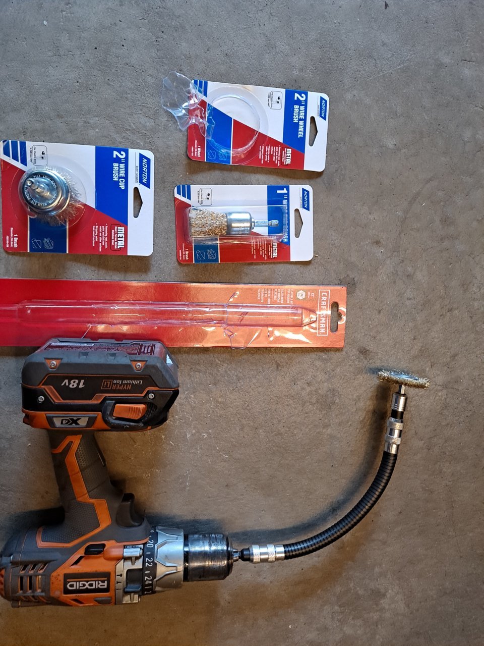

    I was walking through Lowell’s and found these wire wheels that are a HEX head, not a common round shaft that will fit on an drill extension that has a HEX fitting for those hard to reach
