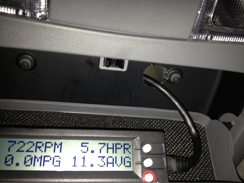

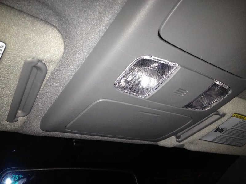

    I didn't like the idea of sticking the sg on my dash with an exposed cord laying about, and the small front sunglass cubby is useless in my opinion. Sooo.... Here's what I did:
    - I started by removing the front driver's-side pillar/ oh-sh**-handle.
    - Next, using a straightened-out coat hanger, I guided the sg cord up through the dash and out the openeing at the top where the pillar panel meets.
    - Then, pulling up all of the slack, I routed the cord along the front post.
    - Next, I (gently) pulled the headliner down near the front corner and tucked the sg cord underneath. I continued working the cord in until I had hidden the cord for the full length of headliner between the corner post and rearview mirror.
    - Next, I removed the overhead console. (There are existing threads on how to do this, but its one screw located in the larger cubby and pulling down from the windshield side.)
    - Then, I disconnected the two wires and drilled a hole in the back of the console. Drill on the right side somewhere near the rubber bump stop thing. (Be sure to use a large enough hole for the cord to move freely when opening and closing the cubby.
    - Next, pull the headliner down by the rearview and push the cord all the way under the headliner and bring it out the hole where the console fits.

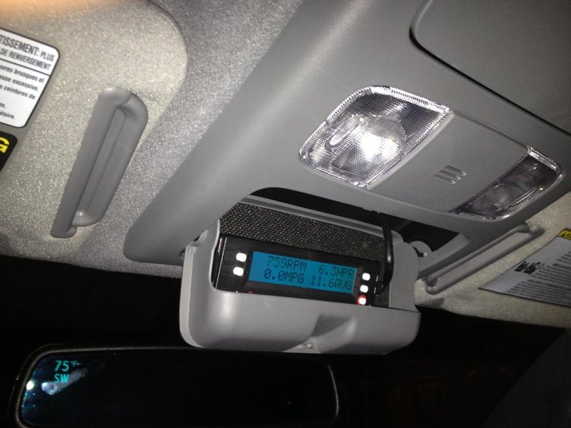

    - I cut out a piece of the rubbery padding that is inside the cubby and placed the adhesive velcro pad, making sure that the sg would sit in a good level position. You'll also want to put the sg as far left as possible to allow room to plug in the cord.
    - Next, all was left was the reassembly. Pull the cord through your drilled hole, put the console back in, and put the pillar panel and oh-sh**-handle back on. Connect your sg and voila!
    This was super easy to do, hides the sg cord completely, and provides a nice mounting option as well as a use for the smaller sunglass cubby.
