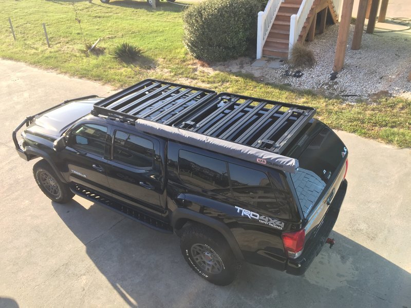

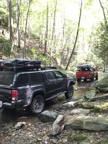

    Basic overland stuff...
    This is a common question on here. They'll hold up just fine. The bedliner spray is not going to add any strength and will likely look bad after a few years of fading.
    ARE z-series
