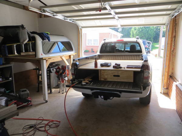

    I just finished this, and I thought I'd share what I came up with in case anyone else can use any of my ideas. I hope it helps.

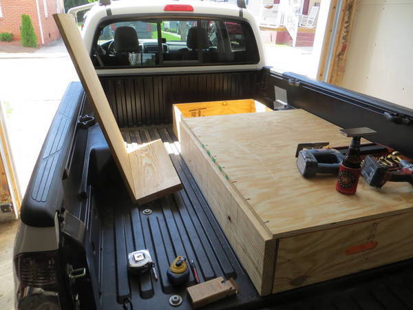

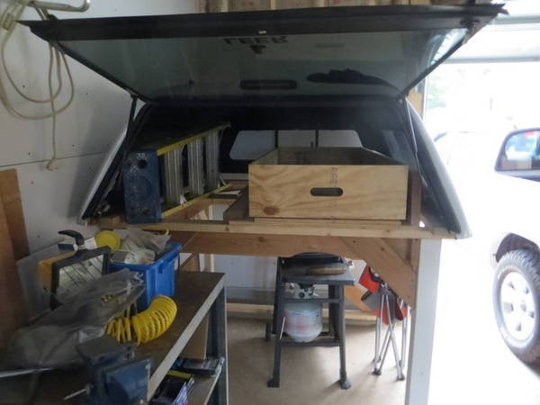

    I made it strong with 3/4" plywood, because I'm kind of heavy.:eek: It took 1 sheet of 3/4" plywood and 1 piece of 2x10x8' for the platform and 1 sheet of 1/2" plywood for the drawer (and of course nails, screws, and glue). The camper is the tall leer 180 (I think it's called that), so there should be plenty of room. I have a 5" thick foam mattress that will be used with it. As you can see from the pictures below, it comes apart for easy storage. It is made up of 4 pieces and the drawer that interlock into place and, when removed, all fit under the camper shell and out of the way when not in use. I may add another drawer in the future, but I'm not sure yet. I'll try this out for a while first.

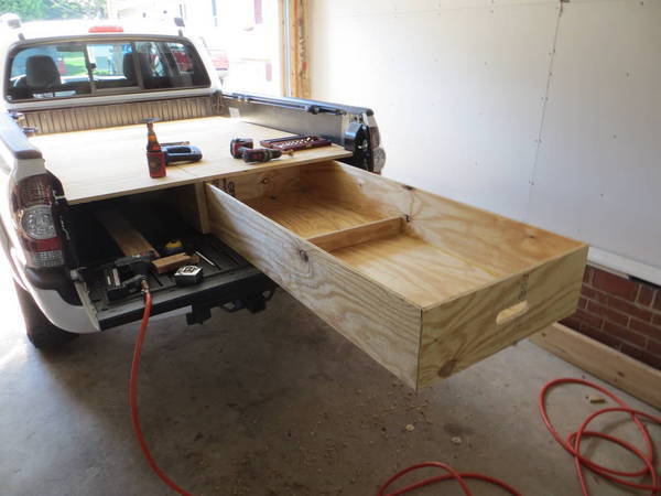

    What keeps the drawers from tipping when fully extended and loaded ?
    Is the platform anchored down ?

    I'm thinking heavier stuff up front. I haven't used it yet, but the tailgate holds it well when extended and empty. It's not anchored down at all. It should be fine, but I will do something about it if it is a problem. Completely untested at this point.
