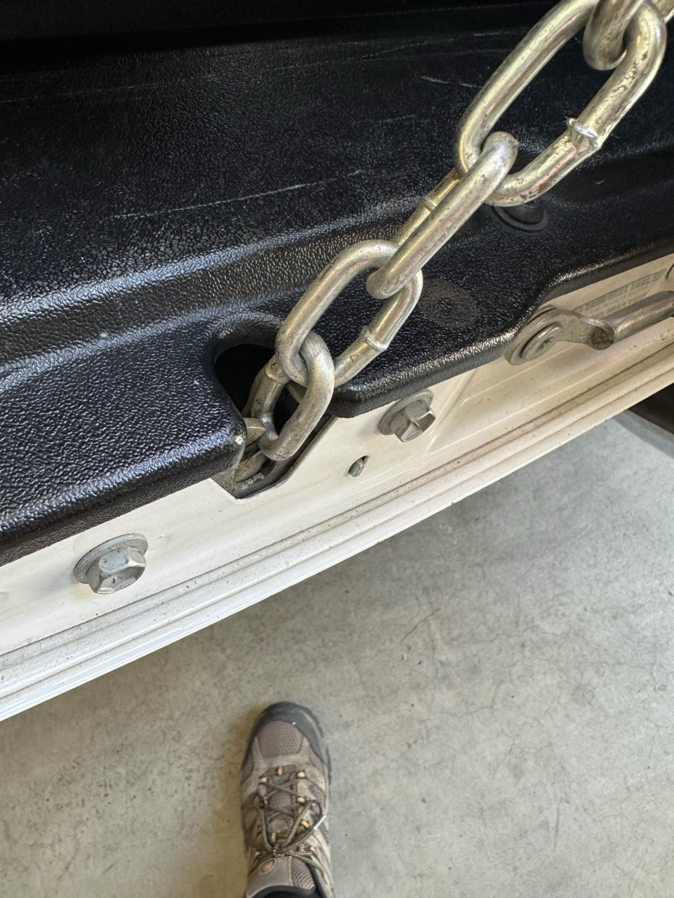

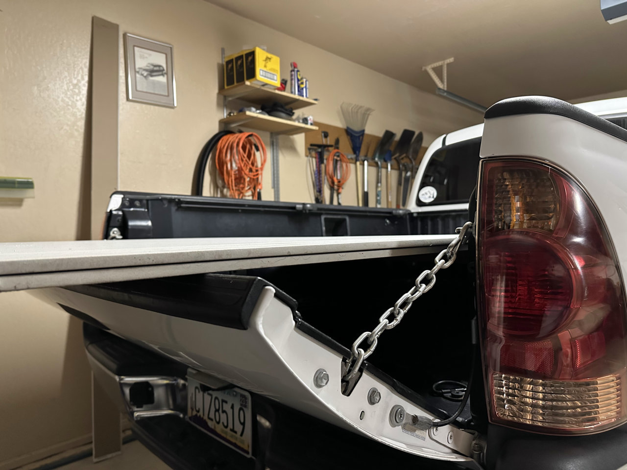

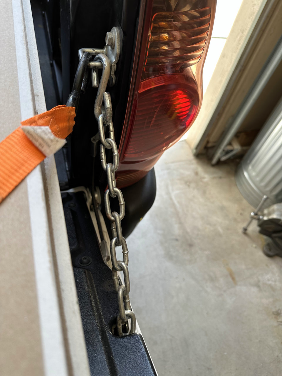

    6863B3E3-2153-4A6F-B1A8-AB3530CB200F.jpg 95AF3260-982B-4EAB-ABF2-396C1E73B3FA.jpg 8AB07E3A-7585-4FB5-9AE0-8D05CABA4988.jpg There's a previous thread for a mod to make it easier to carry long material but here's my quick and dirty solution

    As long as it’s not heavy, these tailgates are weak. Bed extender works good and are cheap

    That’s good as long as the latches lock.
    I know a guy that used WD40 to lube his latches, thinking he was doing a good thing.
    The stuff gummed up and wouldn’t latch fully unless you really slammed the tail gate.
    Point is, the latches can look locked, but aren’t.
    Give the tailgate a good “lift and drop” to make sure the latches are locked.
    BTW, that guy was me.
    I used rubbing alcohol to clean up the latches, and then used dry lube.

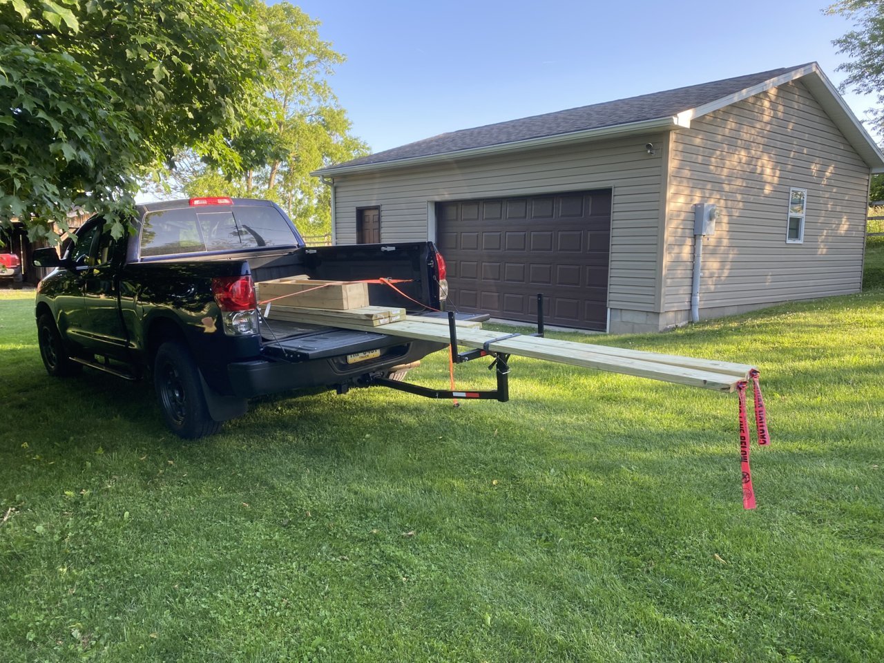

    Kayak rack found on Amazon for $50. Yes those are 16' boards.
