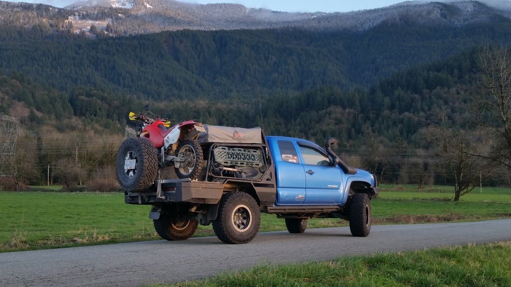

  3. Nov 7, 2015 at 6:12 PM
    #83
    speedwaygonzalez
    speedwaygonzalez [OP] Well-Known Member
    Apr 15, 2014
    #127751
    172
    British Colombia Kanada
    06 speedway blue 4x4 6 spd
    flatdeck

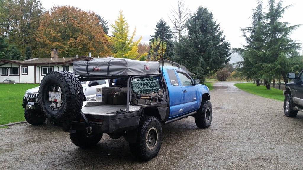

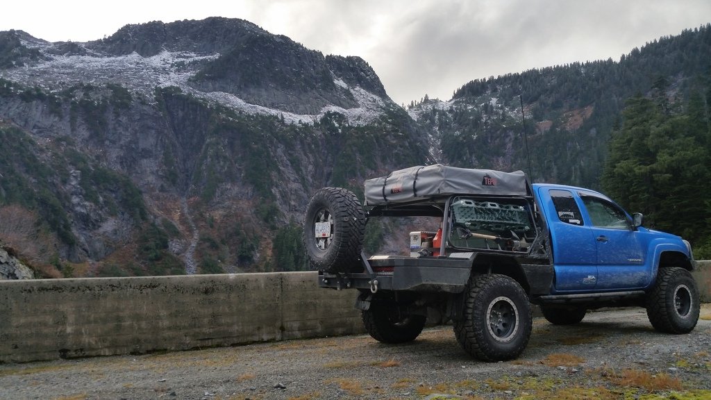

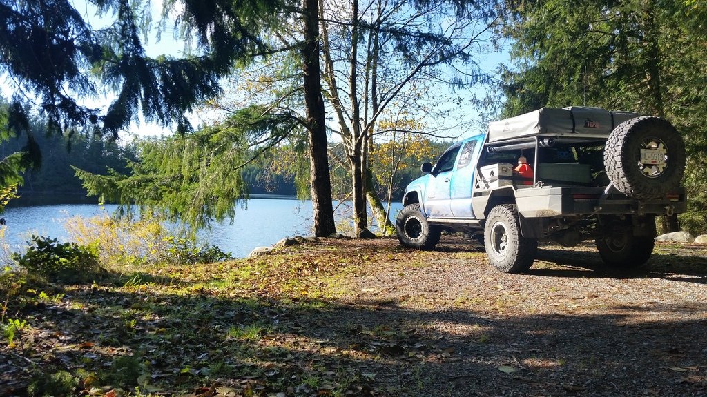

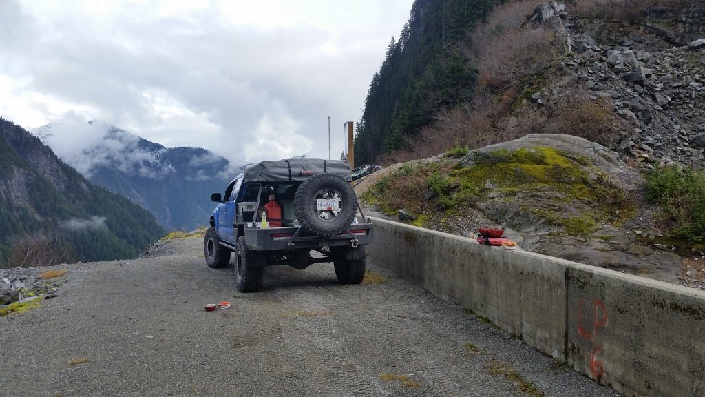

    Getting ready for a trip somewhere on the west coast this week mounted the rtt and went for a little run up mt cheam was a little snow 20151107_114004_3fb084f653f2e6f8d4c81b9b62ff5efa42045020.jpg

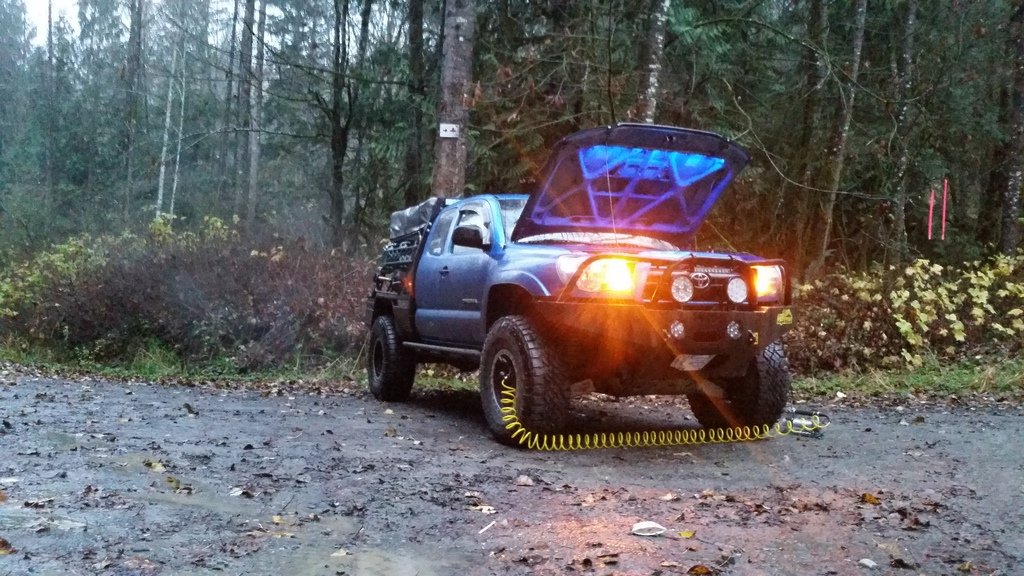

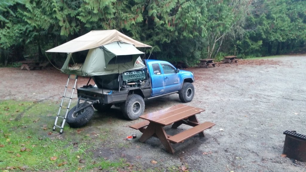

    Went on a little trip to the sunshine coast was beautiful so many places to explore

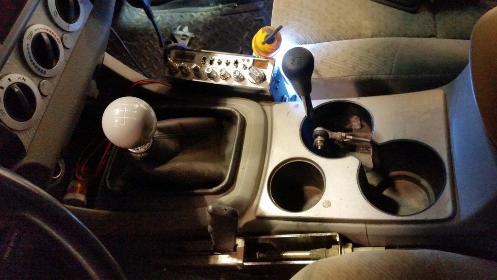

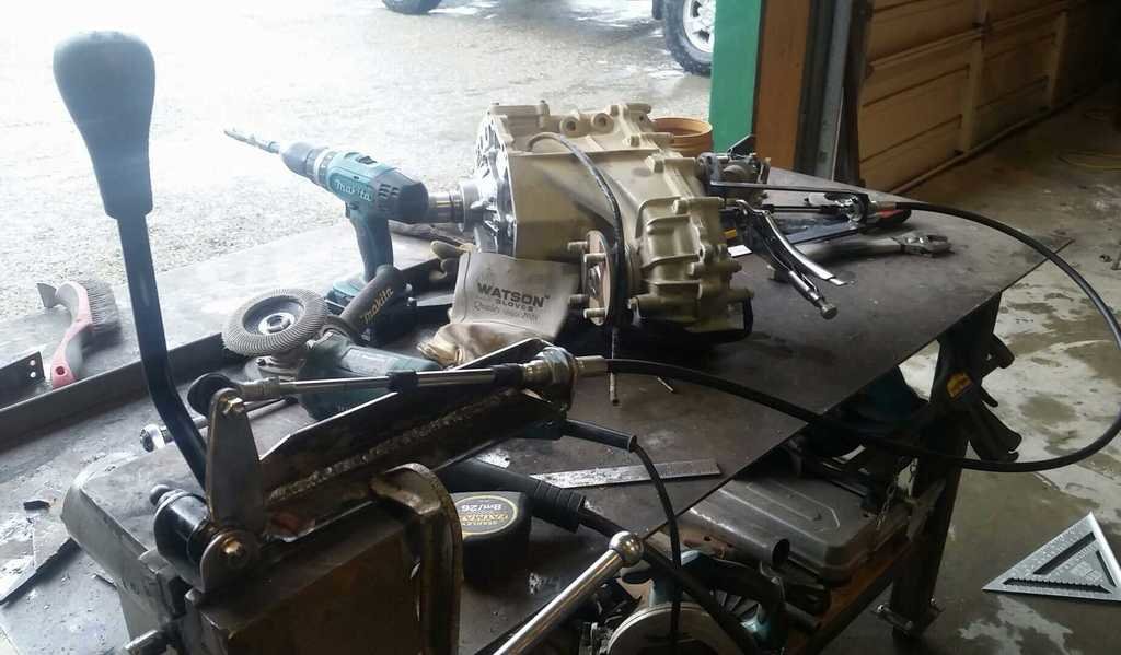

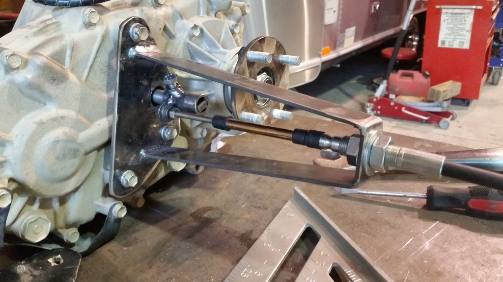

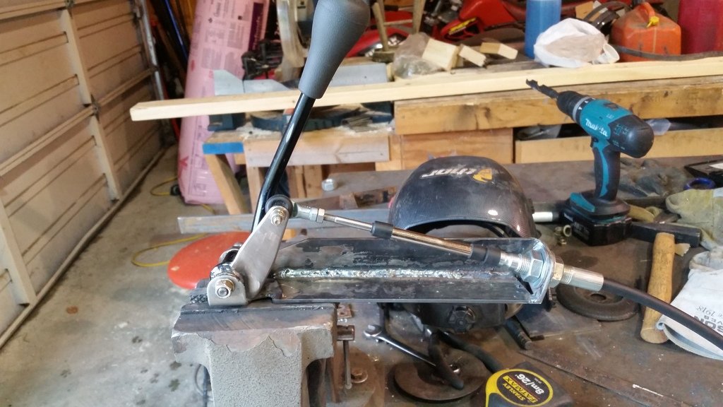

    So my actuator went out on my transfer case decided to make a cable shifter seen one on here on someone's build but not really much info so I went at it got a 6 ft cable from some dump truck controls and shifter from a Mitsubishi delica added a bit to it to accommodate my cable
    Then I made the plate and stand off for the cable on the transfer case with a little sleeve and set bolt to hold the cable to the shaft with out drilling any holes
    Then went about bench testing it on a borrowed transfer case worked like clockwork

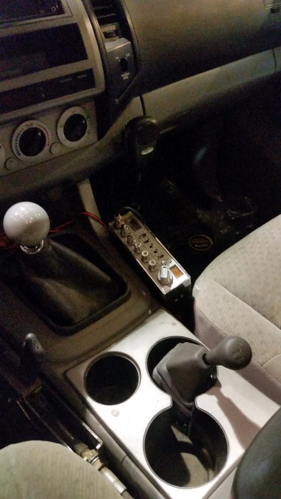

    Then I had to go about mounting it somewhere in the center area Decided to use the further cup holder less interference with my hand and other shifters
    Then I just put the Mitsubishi boot under the cut cup holder for now until I figure something else nice 20151204_164336_2ee5b5cf9e7c84c995e848ee65462a93e6915c63.jpg
    Now to wire a switch to engadge my front diff so it actually works
    So far it works awesome

    Should post up the seal number for the tcase shift rod.

    It was black and round fit right in the hole

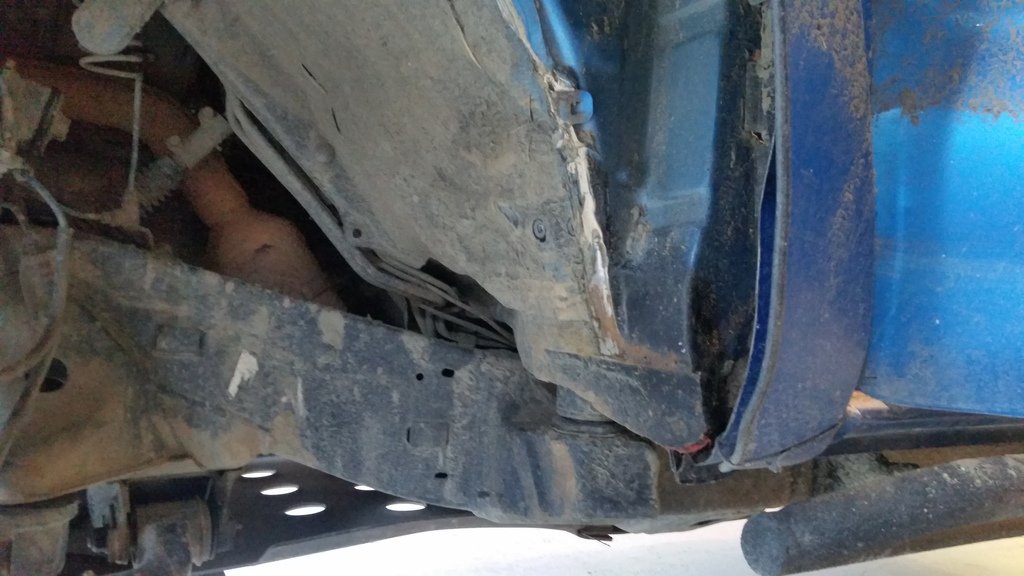

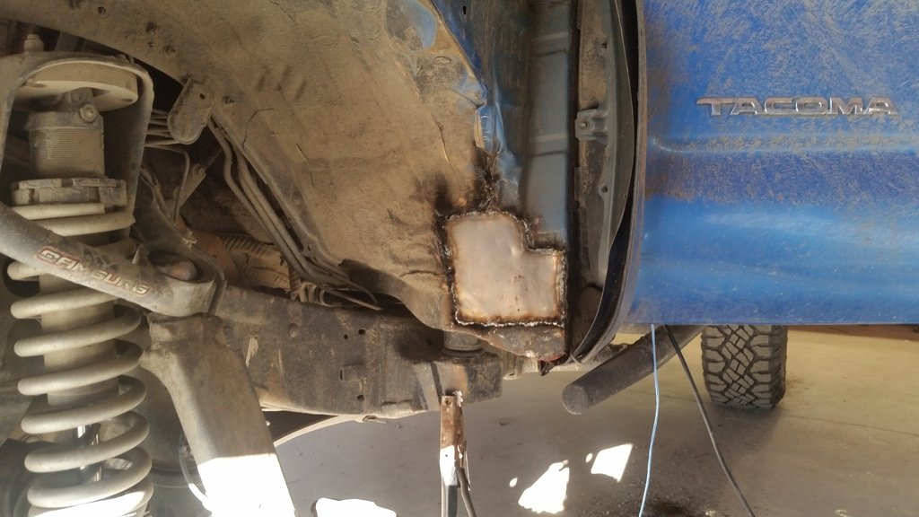

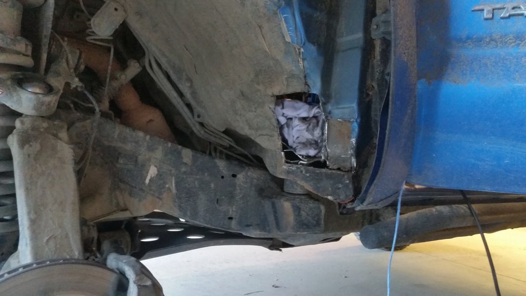

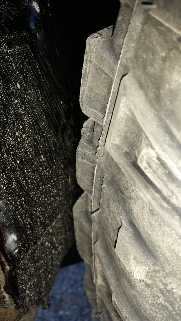

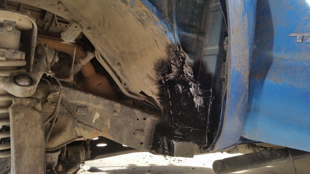

    Did some tubbing for the rubbin Today
    here's what it was like to start with my little notch
    Then layd some wet rags under the carpet and moved the computers put of the way cut out the rubbing area
    Then apply the patch peice tacked the few lawers of cab together under be for the patch
    ground down and added seam sealer
    Finished product 20160106_124054_e5c95b844aeab5b790d4d4fabb1160f3f8540539.jpg
    Shouldn't rub now :)

    About a inch or more cut out of the way No more rubbing

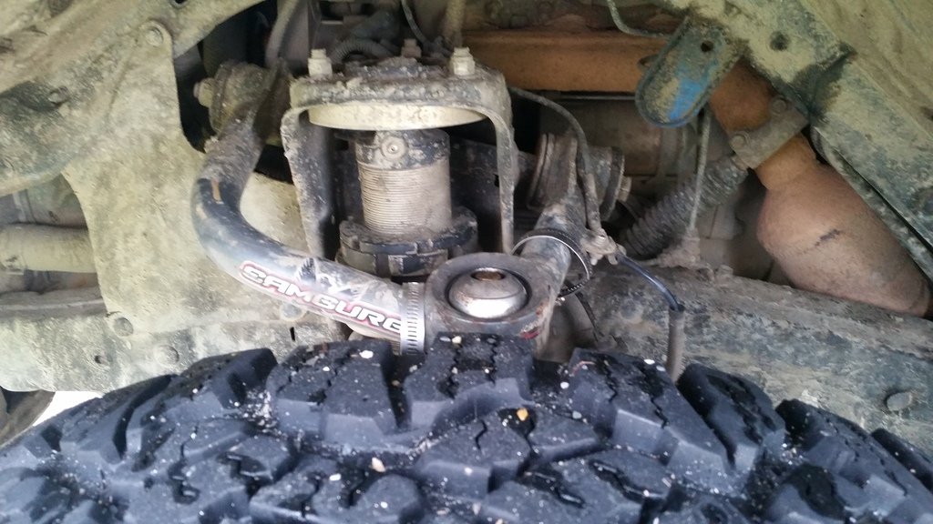

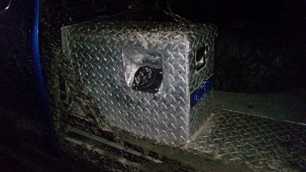

  12. Jan 18, 2016 at 2:35 PM
    #92
    speedwaygonzalez
    Apr 15, 2014
    #127751
    172
    flatdeck
    Wrapped a few things up today
    Finished my filler hole out of the tool box
    Also I finished the caps for my uniballs before
    After
    Now I added a grease nipple to the top and filled with silicone grease :) my next set of uniballs should last more the 3 or 4 mths

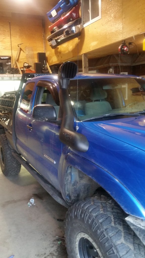

  13. Feb 20, 2016 at 5:29 PM
    #93
    speedwaygonzalez
    Apr 15, 2014
    #127751
    172
    flatdeck

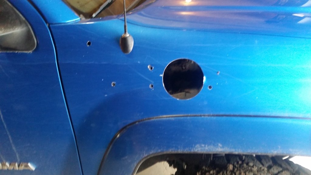

    Got a snorkel
    Pretty simple install
    Some of the holes were a little off but it all worked out
    Absolutely love the airflo snorkel
    3pooches likes this.

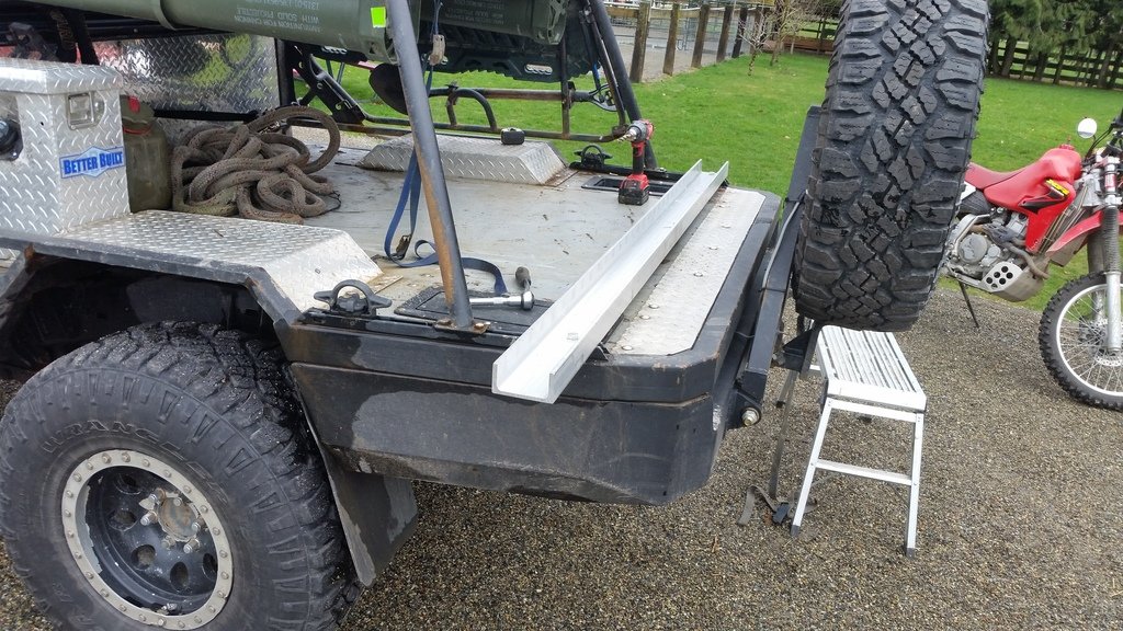

  14. Feb 20, 2016 at 5:48 PM
    #94
    speedwaygonzalez
    Apr 15, 2014
    #127751
    172
    flatdeck

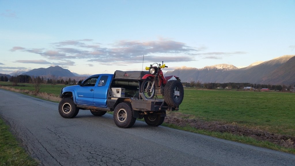

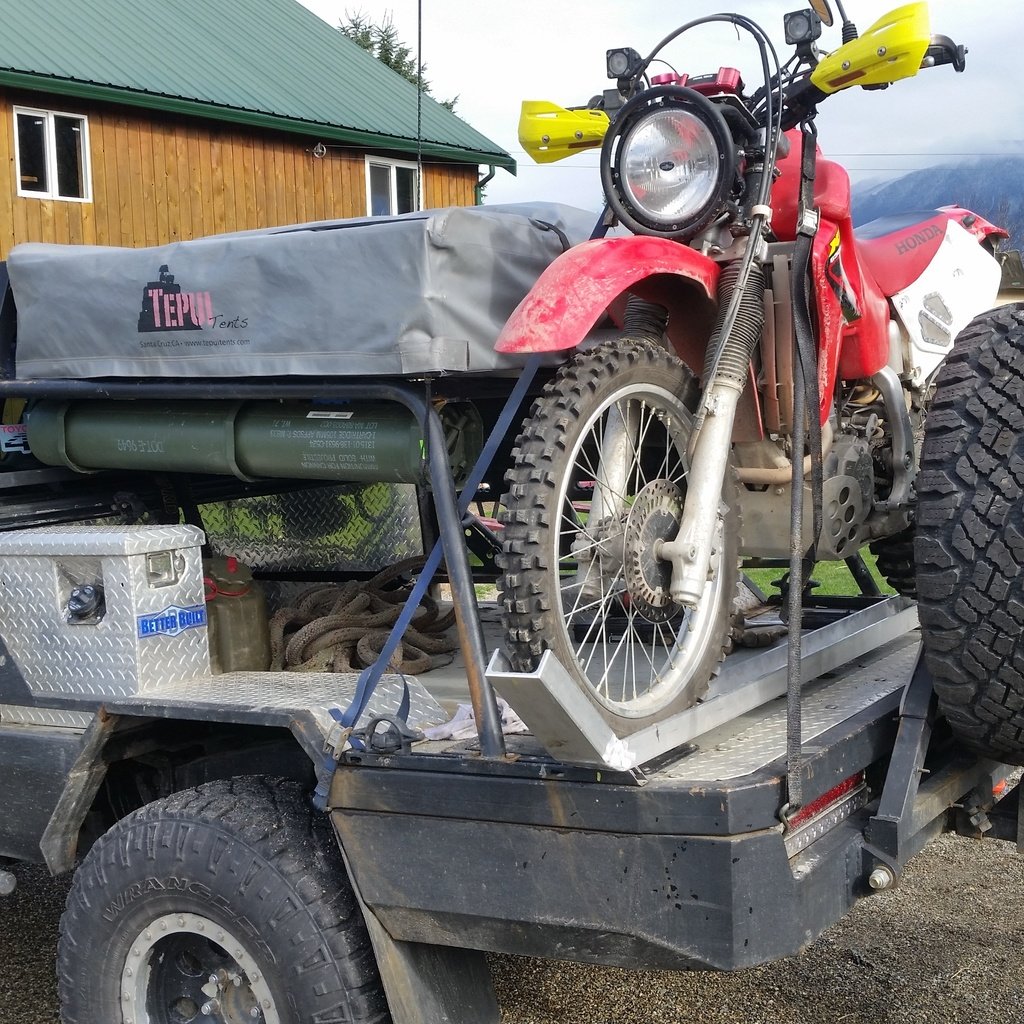

    Then in preparation for the dunes I built the tray to hold my dirt bike on the back of the deck
    The start 3" aluminum c channel
    Then I added a lip to hold the front wheel
    A few straps aand it was ready to go
    Can't wait try on the dunes and camp on the beach :)
    3pooches, overado, mtnbike247 and 8 others like this.

    Do you have any pictures of the snorkel under the hood? I've been thinking about getting one and like the look of the airflo.

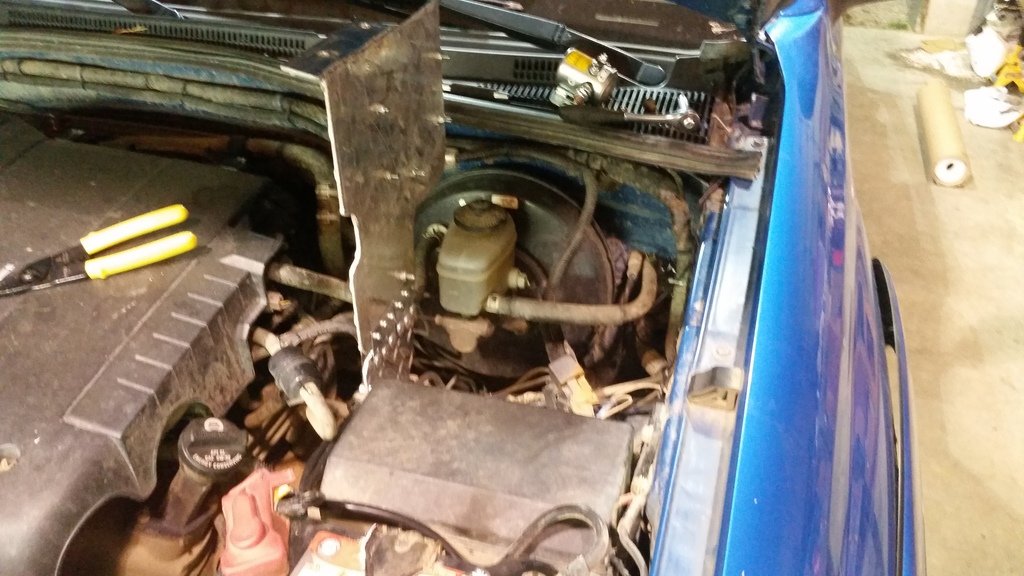

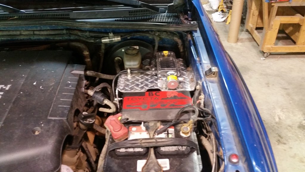

    Started on my dual battery aux power
    It flips open to revel the soon to be nice pile of relays
