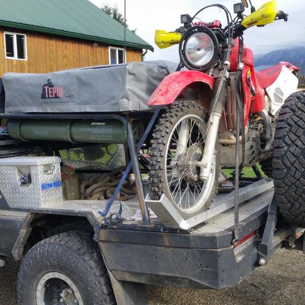

    What's in the green military/ammo tubes? I saw ones similar to yours for sale in a warehouse I was visiting the other day... Curious to know what you use em for?

    I carry straps and my camping chairs in them works awesome

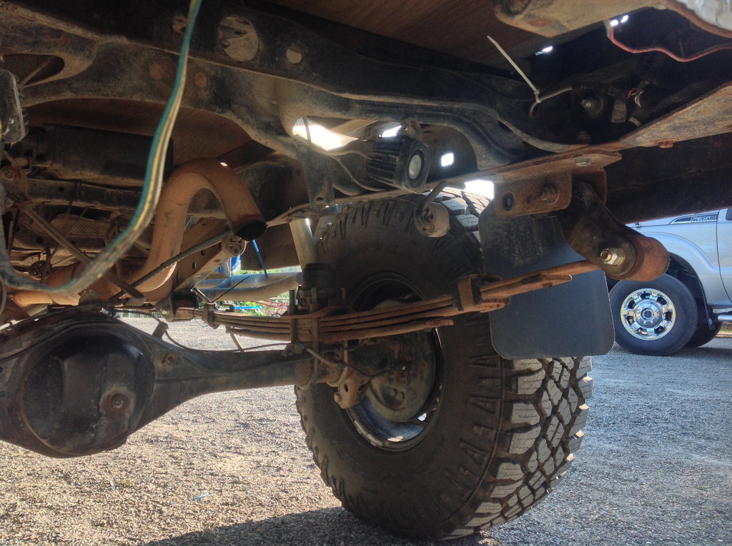

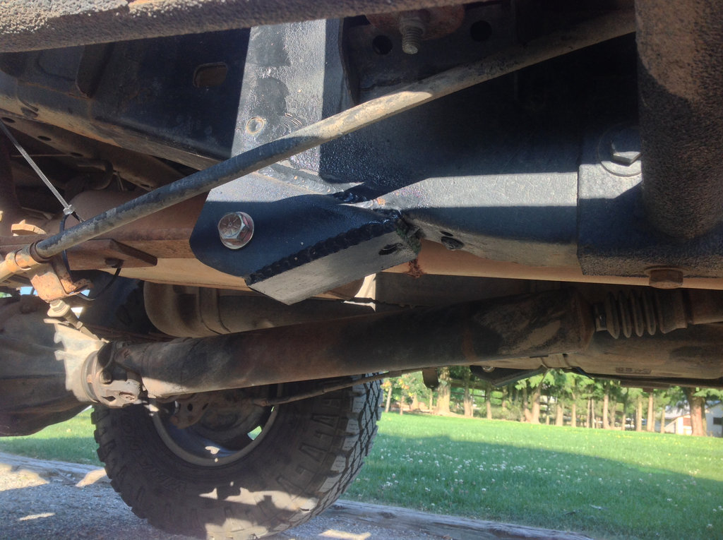

    some closer pics of my Chevy 63 swap
    here's the front hangers I made out of some 3" square
    from the rear still need to play with the shackle angle it's at about 47-49' at ride height just moved the shackle to the rear hole in my shackle flip
