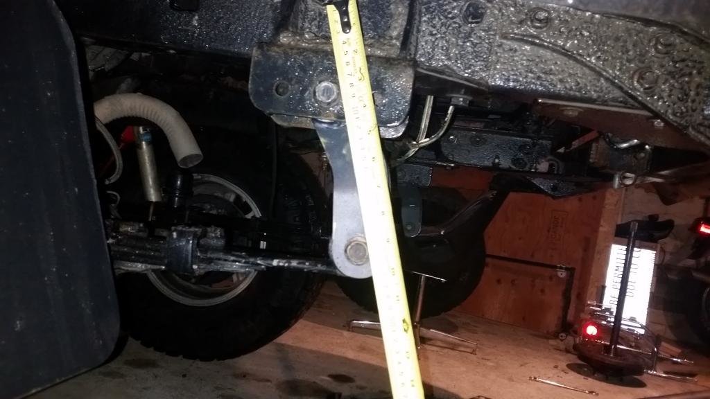

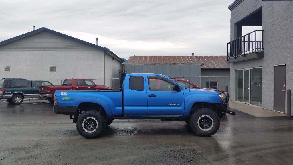

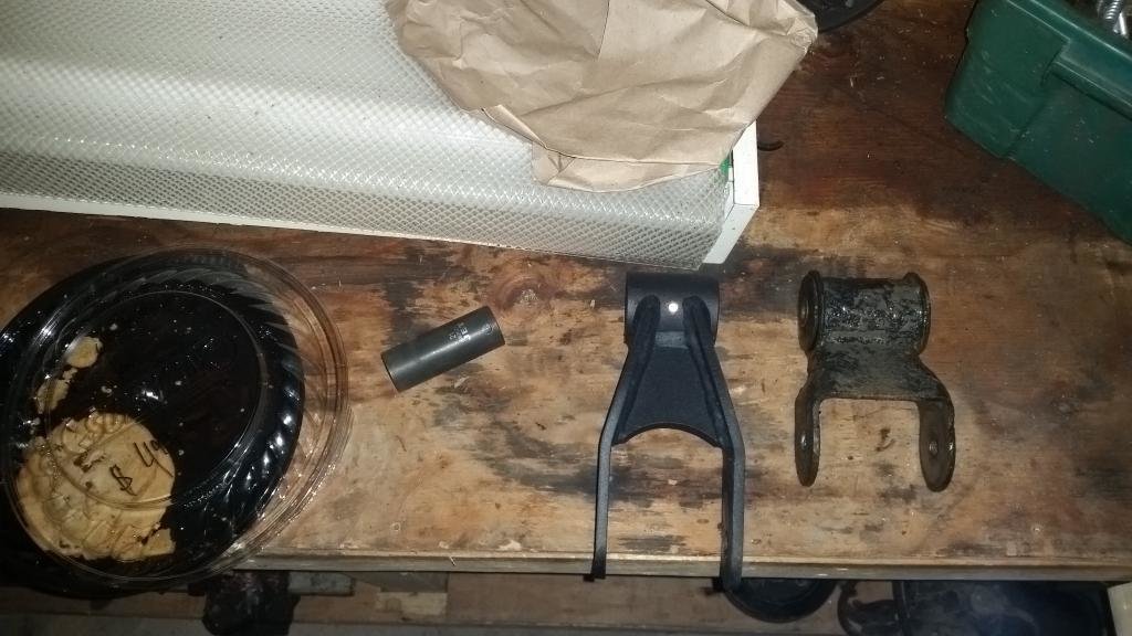

    Well I really missed the mad rake without my aal in the rear so I got some longer shackles from a xj jeep and there greasable
    Gonna play with the mounting yet not to bad
    Almost full droop

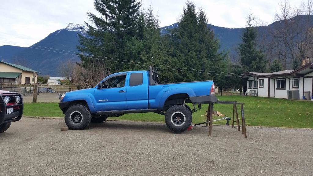

    and moved my shackles one home forward waaaaay better angle using my big jack stands

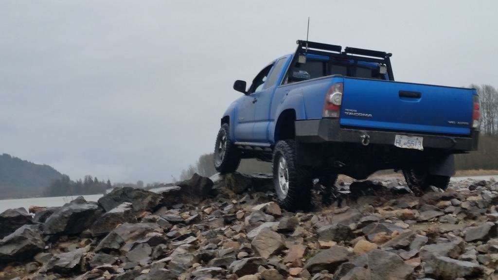

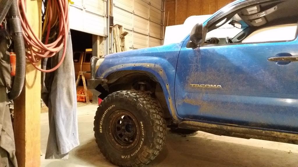

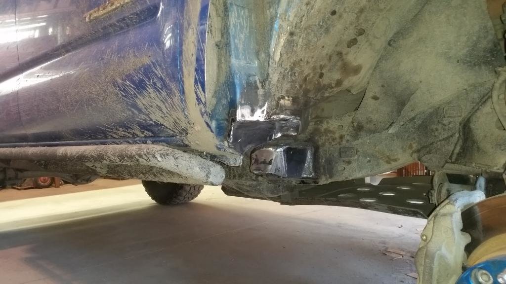

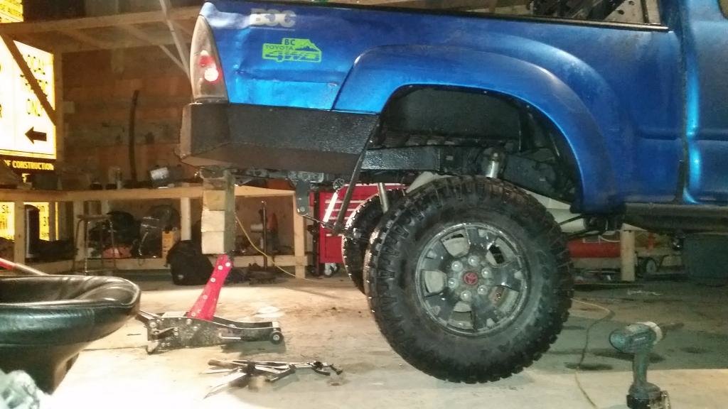

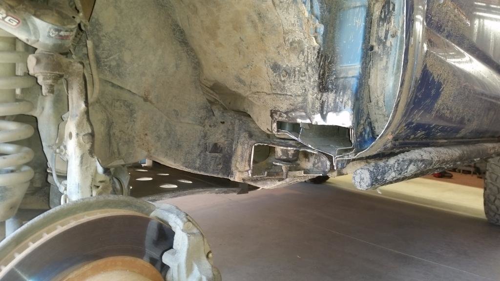

    So after reading some builds on friday it inspired me to do some trimming
    First insert borrowd 35s then remove flares and trim fender sheet metal 20150227_202224_a097099688263dc6bf7e134245e2dc60178b99c0.jpg
    Then I did a lot more cutting on the cab mount and a but to the inner fender 20150228_111032_e95571c73b49991d7c471b761c6a6083ca7e42ce.jpg
    And fill in with metal and make it look pretty 20150228_150711_81107767e4b833b91b42216f601bb1344ee785d6.jpg
    Make it look pretty 20150301_205553_94a5e5655be76a1442d3387ba77d1f26ff767718.jpg

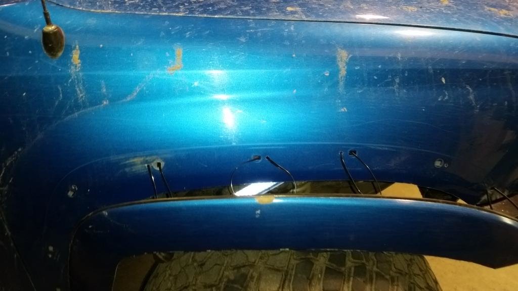

    Next I cut the fenders and attached then with my tacomaworld first signature zapstrap fastening . Just drill a hole beside each original then use zapstraps 20150301_192240_b3a26b52475fade3f82d55f43c66847cf48c7cc4.jpg 20150301_193008_165ae27ed9d707f7326fd8ff5cc139330f18cc2f.jpg
    And repeat for the other side 20150301_195801_487d6f92a38409dadfbce5cabe0eb40ccb94fb7e.jpg 20150301_200130_727535bbffbd5e64ab33f486c8c0285841897263.jpg
    And I also took some off my bumper to match took off 2.5 inches all around just need some black trim to go on then all good

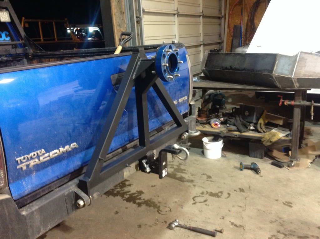

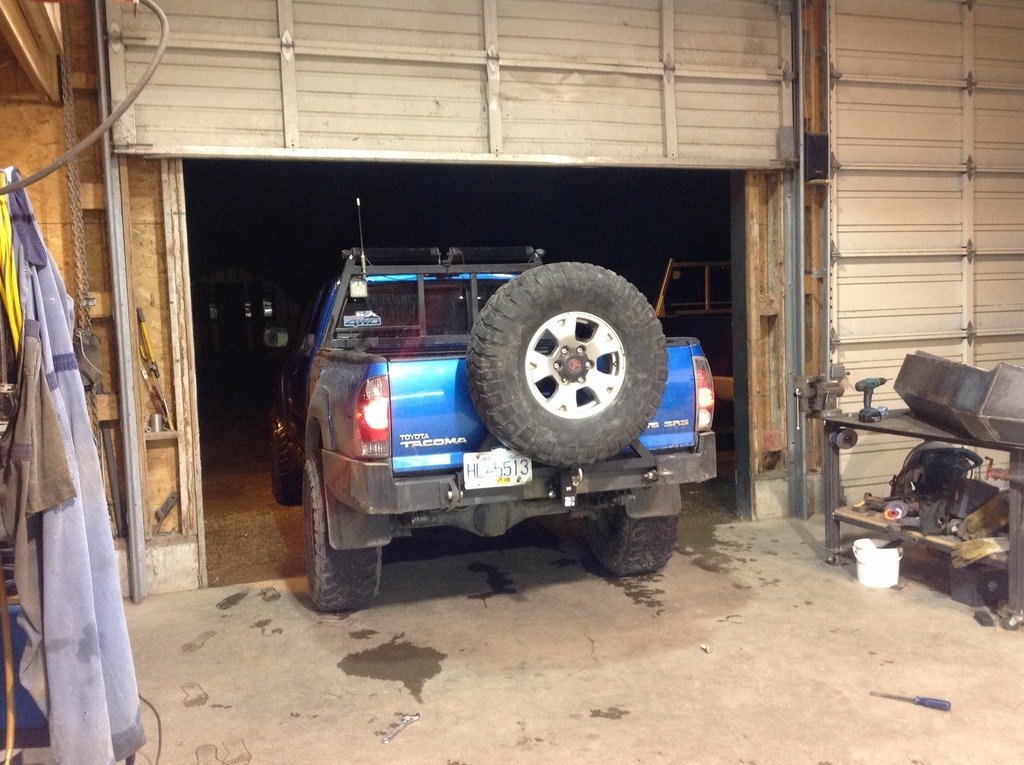

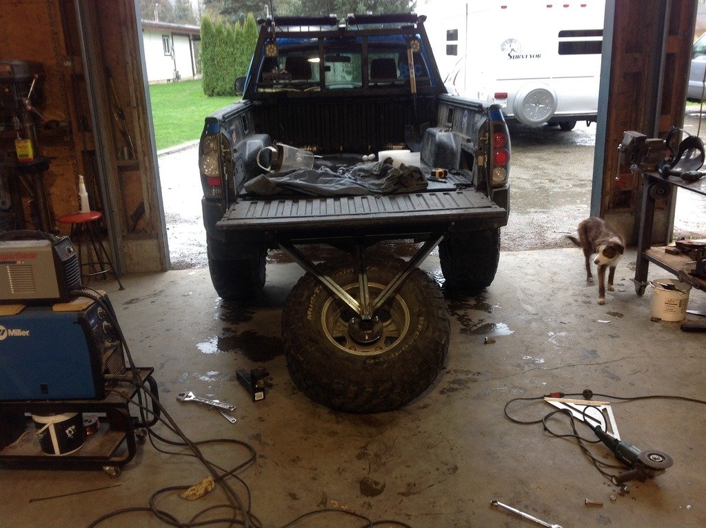

    image.jpg1_540ac498537cb68ad8d3aa7d1e0c7a023cc04a71.jpg built a swing down tire carrier

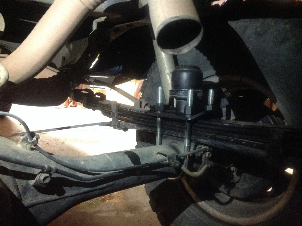

    did my ubolt flip and welded by bumpstops back on image.jpg8_2_7517e31094bc09cbf3ee403184497588dcd8df92.jpg

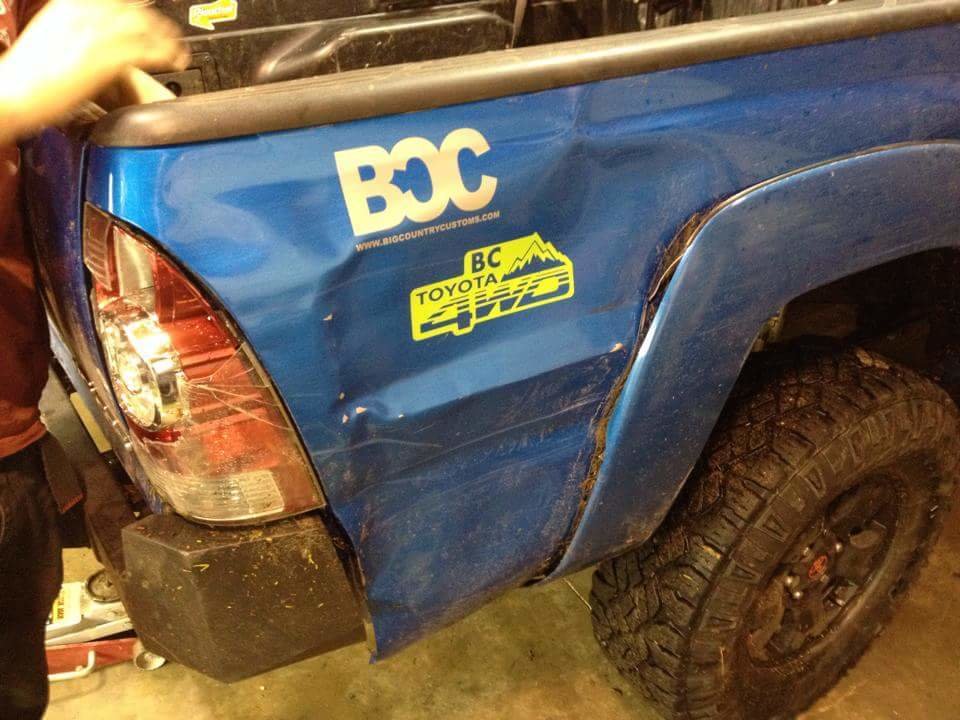

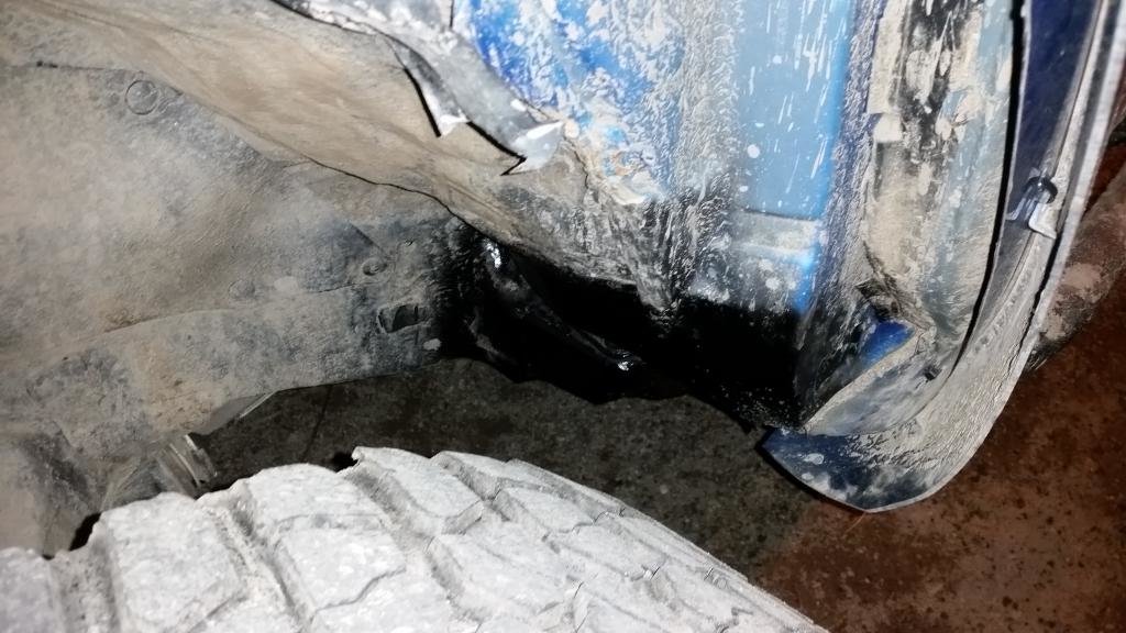

    I know you said you didn't want to talk details but I would have throttled my "buddy" for running me off the road like that. Was the bedside damage from that accident?
    shitgoose06 likes this.
  17. Mar 29, 2015 at 9:07 PM
    #37
    speedwaygonzalez
    speedwaygonzalez [OP] Well-Known Member
    Apr 15, 2014
    #127751
    172
    British Colombia Kanada
    06 speedway blue 4x4 6 spd
    flatdeck
    yea we all make stupid mistakes it used to look like this IMG_59492146501114_bda4c8cc8bf65c54cd0a63cd6a49d5c6989e1ae0.jpg
    but my flatdeck will fix all that :)

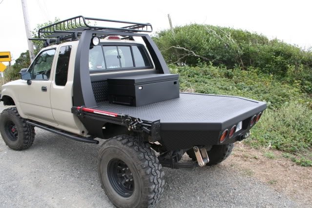

    should end up similar to this one image.jpg1_5_f5ec59e3a6e18d2e0b9768932861b1a1a9dd512e.jpg
