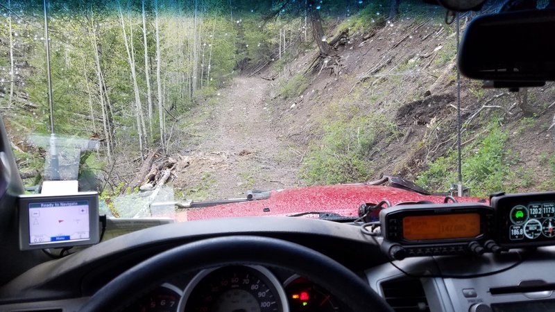

    Kenwood TM-D710 tied to a Garmin Nuvi 350, through a Diamond SG7500.
    The newer TM-D710G has the GPS on board the detachable face......mine is older, so needs an external GPS.
    The Kenwood is typically the preferred choice for those running mobile APRS. It's ideally suited for backcountry 4x4 use.20160530_171705.jpgLeft to right: GPS, radio, OBD2 gauge cluster (Bluetooth through Torque app on an old phone). You can see the antenna behind the GPS, through the reflection. (The antenna on the right, near my Hi-Lift, is my CB). (Those are my sunglasses sitting on the dash behind the radio).

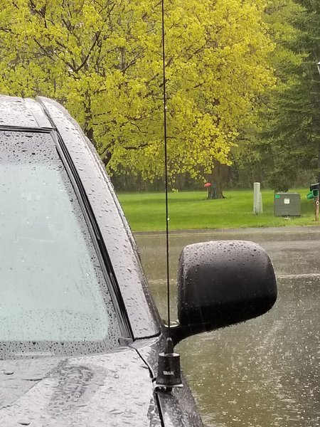

    What mount are you using for your 2 meter antenna? I'm debating switching to a roof NMO with a 1/4 wave for a better GP. My 1/4 mag mount on the roof outperformed my 5/8 wave fender mount in all aspects. However I like the look of the fender mount.
    I took the mag off because of constant condensation forming underneath it.

    The odd positioning problem discovered on this trip, via this thread, developed into a permanent situation.
    Figuring it was the radio, I tried changing all kinds of settings, which frankly only made problems worse (exponentially with each setting change). Finally reverted my radio settings back to a time of known flawlessness, and started to suspect maybe it was my GPS unit.
    About the same time, my Garmin Nuvi 350 lost all ability to locate satellites, and no amount of refreshing, resetting, tapping, repositioning, etc would solve it. Suspicions confirmed.
    Turns out the little flip-up GPS antenna on the back of it went kaput. I never did like that stupid flip-up antenna. Thankfully, it has a connector on the side for attaching an external antenna.
    Got the Gilsson magmount GPS antenna off Animalzon, hooked it up, and all is good now.
