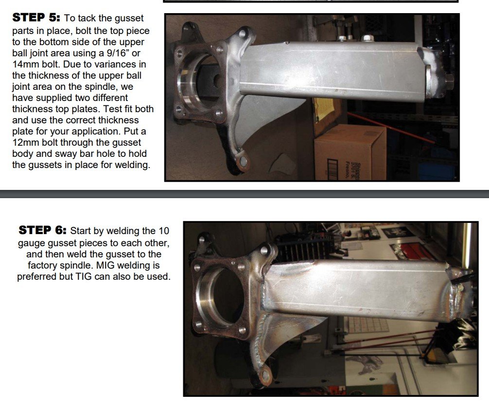

    Just curious where you saw that the spindle needs to be heated? The spindle is forged, not cast. Instructions I've read never mention pre or post heating.

    @jberry813 is correct. Pre/post heating is not required. I do some pre/post heat due to a convo I had with someone in the “know” but prior to that I did not have a process for heating them. Hell the ones on my truck were not pre/post heated. I think the important take aways are:
    • don’t run non-sway bar gussets unless you have a good reason. I don’t sell that style unless the customer gives me a good reason why he can’t run the newer sway bar version. Definitely don’t run the non-sway bar version without atleast an added tie rod gusset, that seems to greatly reduce the chances of the cracking.
    • don’t buy spindles from someone learning to weld. A lot of guys have been trying to get into welding spindles lately. One guy was still learning to weld and hasn’t realized if your gonna tig weld spindles you gotta fit the gussets a lot better than the way they come from TC (and yes we could all see how fucked up the tie rod end gusset welding came out. Can’t fill 1/4” gaps tig welding) and if your gonna get them from someone mig welding them look at the welds. A lot of the mig welded ones are welded too cold. Look at the toes of the weld. If it wasn’t hot enough to tie in at the toes of the weld on the spindle material you most likely didn’t get good penetration.
    • if you are running non-sway bar gussets without any added reinforcement then I’d check them ASAP and add gussets
    • if your non-sway bar gussets are cracked I’d recommend replacing them since a crack may already be forming in the spindle itself, at the minimum drill a hole in the end of the crack prior to rewelding.

    Great info! I know this is a common debate, but I respect your opinion on the matter.
    Are you an advocate for Tig welding the spindles over MiG or can it be done either way with the proper prep work? I have seen conversations on both but I don’t have enough knowledge to form an opinion on the topic.

    I think your fine with either method of welding. I can tig weld them, but I will spend more time prepping them so the cost will atleast double. The weld is only gonna be as good as the prep. I’m just saying if someone pops up trying to push tig welded spindles for cheap I’d take a close look at if it was properly prepped and correct rod was used.
    I’d say if you had two master welders tig would be better. But I’d take mig welded from a good welder over tig welded by a novice. Most guys learning to tig weld don’t add enough filler. They generally just lay wire which mostly turns into an autongenous (so) weld. Either way both processes are more than up to the task of gusseting spindles. It mostly comes down to esthetics.
