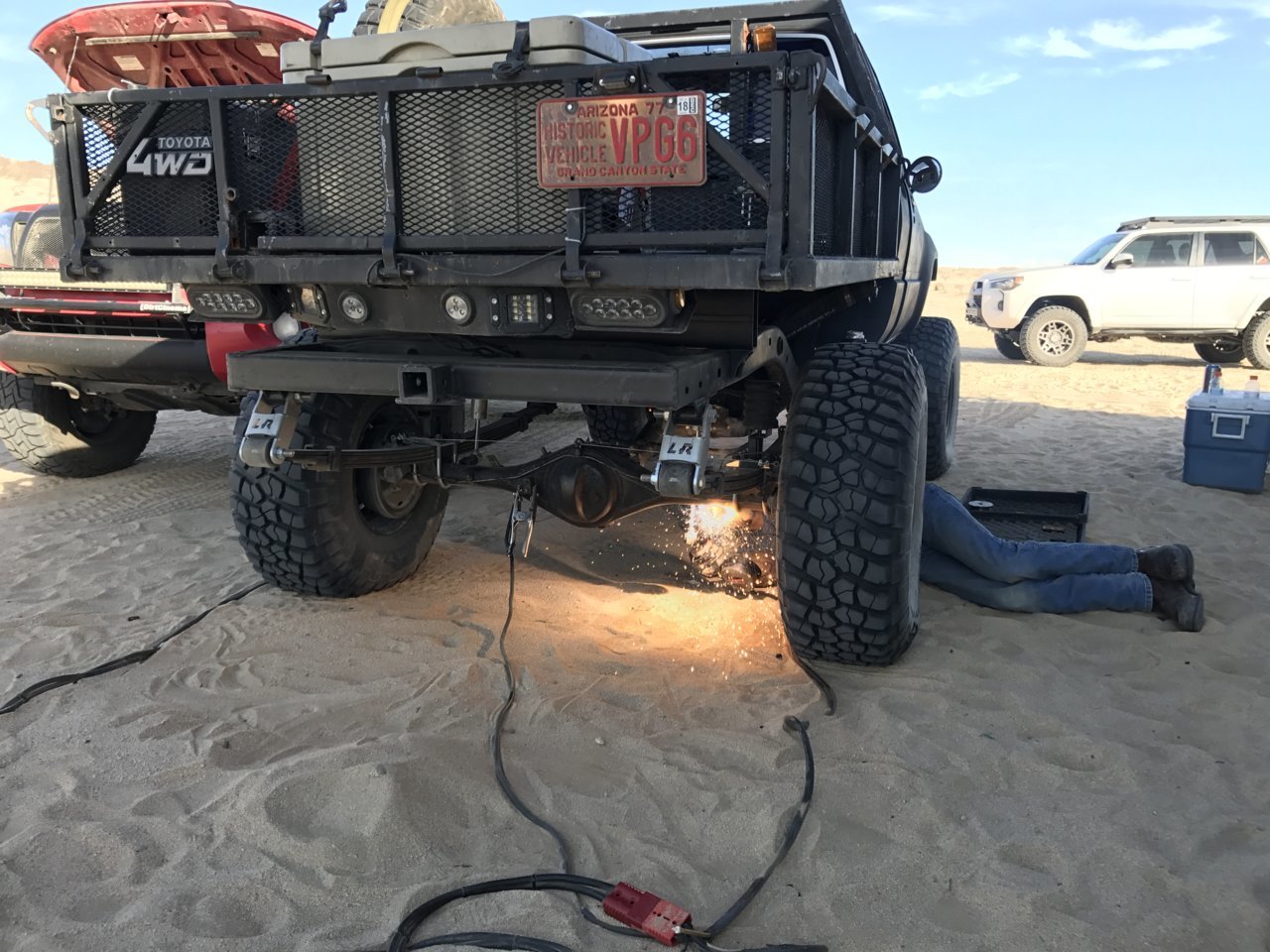

    @YumaTRD has a trail welder. Used my battery and his and fixed a broken shock mount. Very cool little kit and compact.
    climbhigher23, Marc70, Zam15 and 8 others like this.

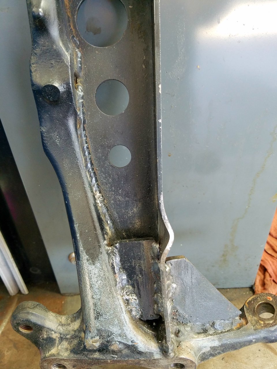

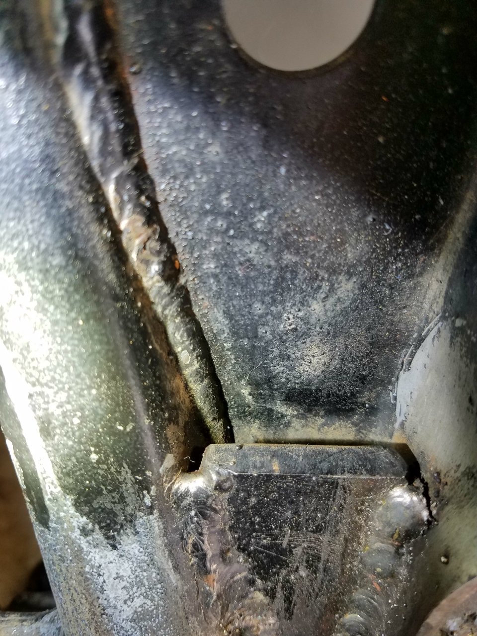

    And for shits and giggles and since I never posted it in this thread, here are my "The Truck Shop" gussets that I cracked after a year or so of use. One of the cracks was in an area I had to grind down to make room for a BBK adapter. Other one is straight through the side.
    Maybe I should stop being a dick to my truck. :annoyed:
