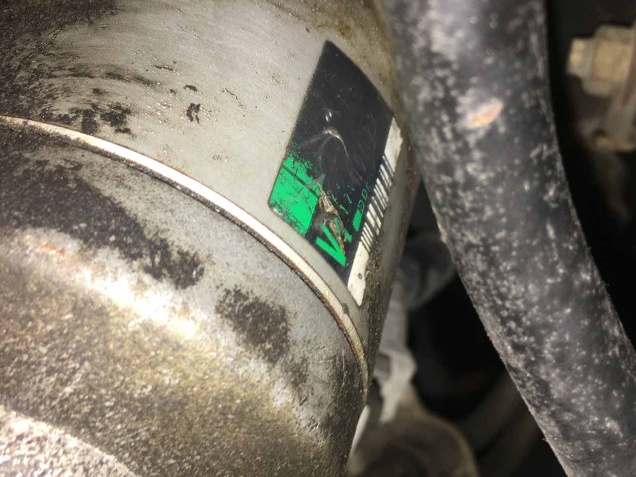

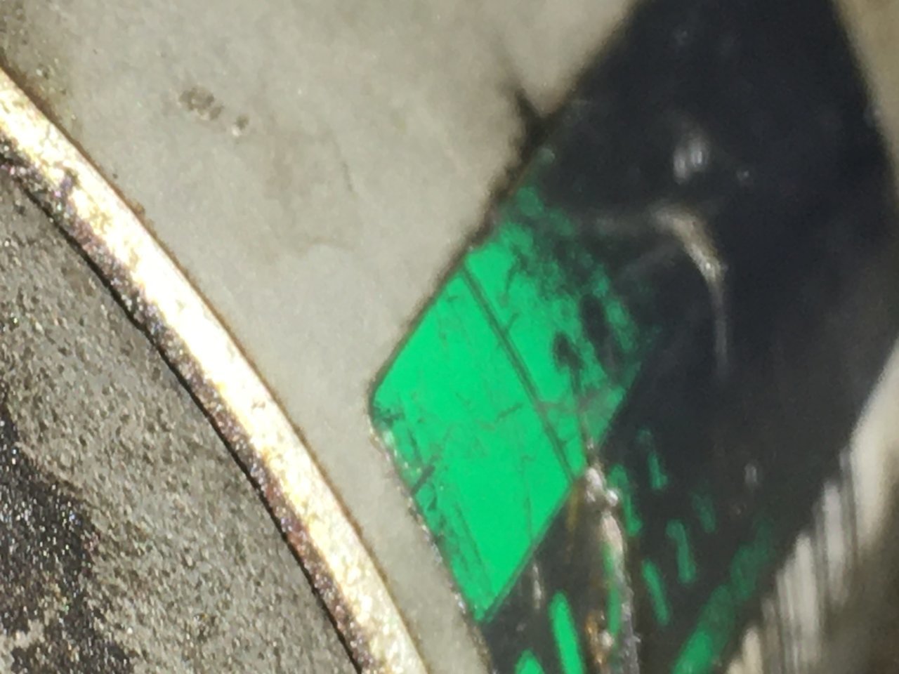

    9BE7976A-D6AB-493B-ADBB-2E6B1E63642D.jpg 58CD0B0D-EAFF-4F85-9A72-D3BD1612374D.jpg Hey folks I have tried everything to determine if this a standard or cold weather spec starter other than remove it because it’s my only vehicle. Now unlike most folks I can’t even determine by the starter itself because the part code is somehow wore off! Can anyone tell by these pics which starter it is so I can order the contacts? There seems to be a V4 or 1/4 symbol kinda legible but probably means nothing? Toyota shouldve just put the cold spec one on all Tacomas!

    The cold spec starter has a much longer body and is much more of a pain to change.
    The Automatic Starter is the Cold weather manual Transmission starter .
    No clutch to disconnect the trans and case higher output starter
    That is a Reman starter those numbers only have meaning to who rebuilt it and sold it.
    I looked for one to measure I think it is Hiding .

    Well it says Denso on the label? I noticed newer Tacoma’s have a red label, but mine is a 96.It, is what came on it,never changed it. I can just start to make 2800- out on it but then the crucial part of the number is just not there. Heat from the manifold has dry rotted it so bad. Ive been told everything that only autos have the cold spec one and only manuals, and then the location of your window wash reservoir will tell you if it’s cold spec truck. I guess I will just have to either buy both 1.4 and 1.8 kit . I have heard the 1.8 is longer, I wish I knew measurements. Thanks man

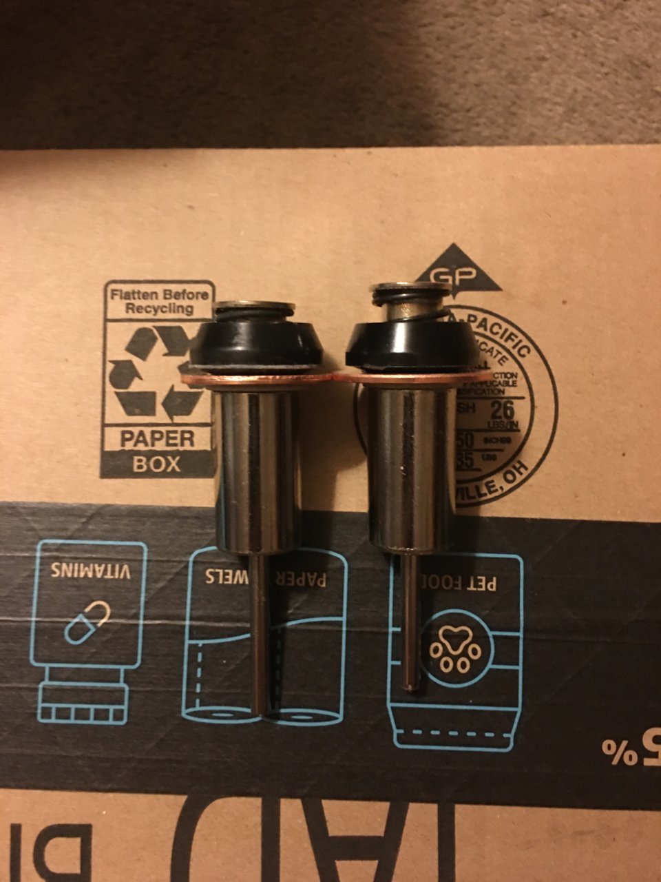

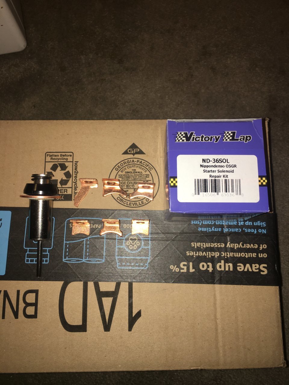

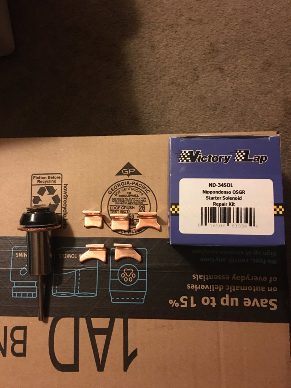

    96’ Tacoma DLX 3.4 V6 4X4 Auto
