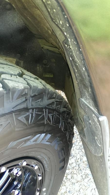

    I just posted this on another discussion too but I have the 5100's at the 2.5 setting and just put 17"x9" rims with a -12mm (4.52) offset with 285/70-17 AT tires on. At full turn they hit the mud flap in the rear and the bump on the fender lining that sticks out towards the tire in the front. So I would say no on the 295's
    rear at mud flap
    front fender liner
