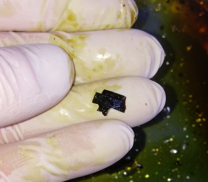

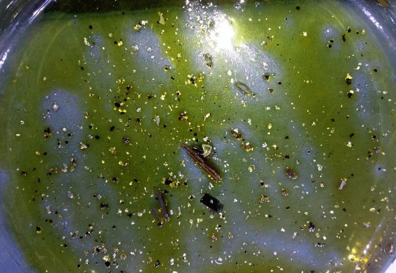

    I know the issue with the 3.0 V6 was not head gaskets, my point was sudden engine failure due to an issue Toyota is aware of, can be very dangerous!
    Anyway, this is what your oil looks like when a dealership machines your heads (which should never be done on these engines), fails to clean properly, leaving metal shavings in your engine and also failing to install the guides properly and the break apart.
