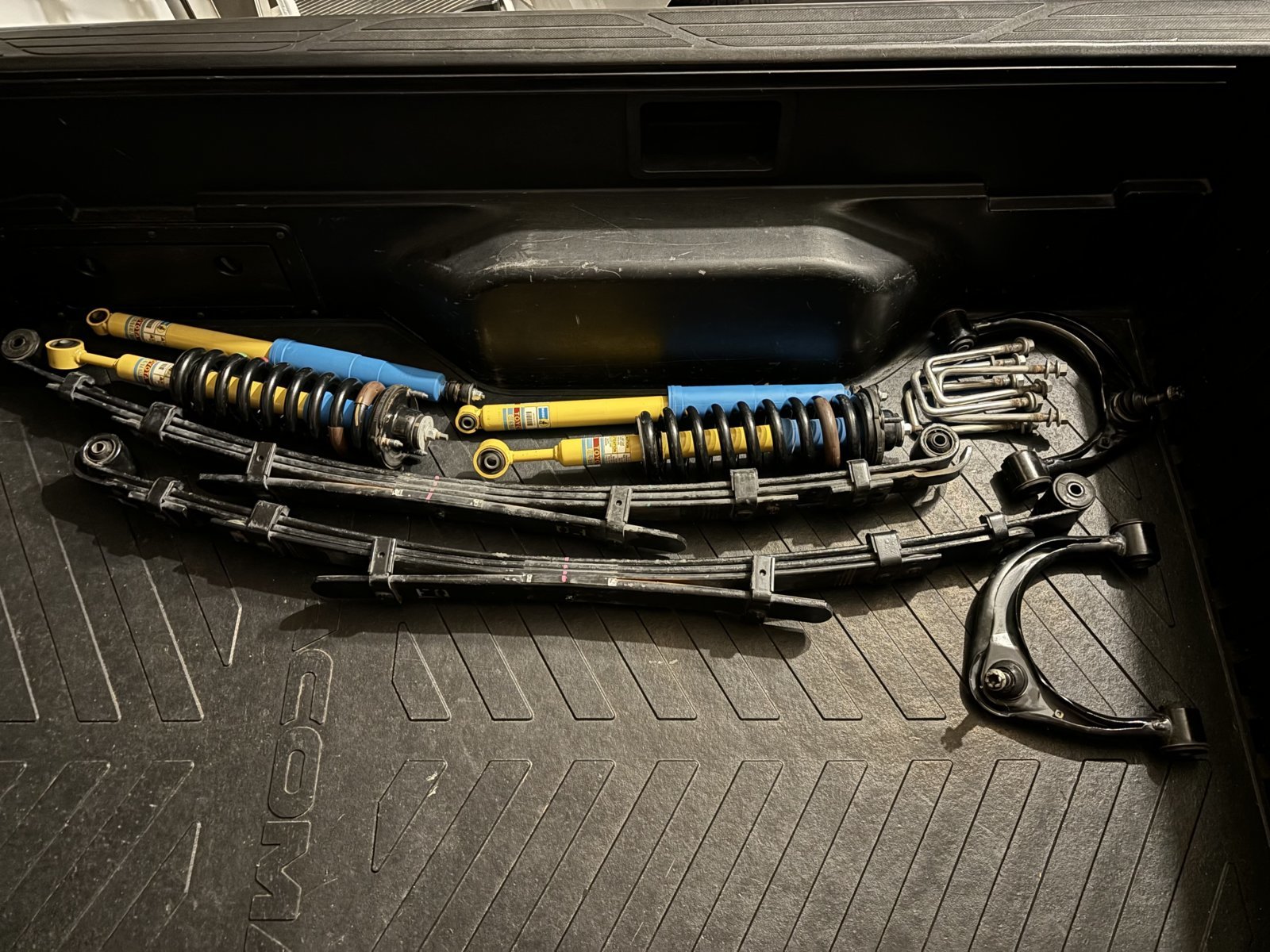

    I am swapping a complete suspension (picture) from a 3rd gen to my 2005. I know how to do the swap, but what I don’t know is what other parts I should replace (bolts, nuts, etc) while I’m in there.

    I would replace every bolt. Especially the u bolts. Im pretty sure when you torque each nut down it stretches itself or the bolt. When you loosen and use it again its not the same it once was so it wont stay tight for long.

    U bolts are the only bolts/nuts that you need to replace. Every other nut and bolt you will touch can be reused without any worry. I'm a mechanic and have lifted dozens of Tacomas. Replacing bolts and nuts is unnecessary.
    Proper torque is important though. And re-torque after 500 miles is a good practice.

    U bolts are fine IMO to reuse as long as threads are good....
    Torque everything thats a bonded rubber bushing at ride height with the full weight of the truck on the tires. (uca to frame, front and rear lower shock, front/rear leaf spring, leaf spring shackle to frame, lower control arm to frame).
    If those front strut assemblies have never been taken apart, you will know the driver side vs passenger side (they are different springs) by which one lines up with the upper 3 holts of the top hat AND has the BOTTOM of the coil that last coil ends at the very back.

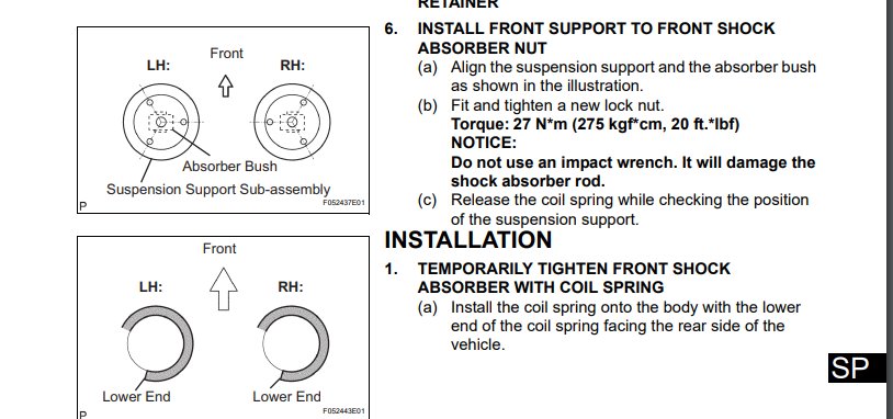

    Replace the u-bolts, the Toyota part number is 90117-A0005. Per Toyota, you’re supposed to replace the castle nut on the upper control arms,of course replace the cotter pin with the bolt. I’ve attached the documentation that outlines the torque recommendations. An impact gun definitely helps and spray all the bolts days prior with penetrating oil. Not a bad job and the ride and stance are a dramatic improvement. This is probably the most helpful video to watch for the front shock assembly replacement:

    The threads on the U-bolts doesn't look good. Do like others have suggested and get new u-bolts. The torque on those is 73 ft/lbs.
