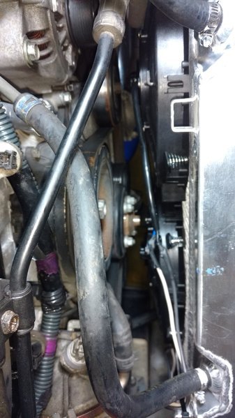

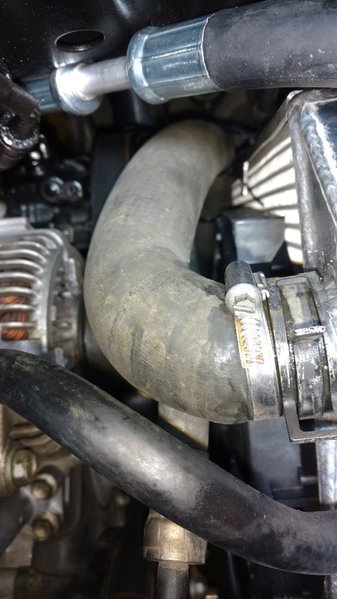

    Also, how are you running your lower radiator hose.
    One more thing, I assume you are using the transmission cooler in the radiator, anything else?
    Can you post a picture of your fan setup, and how tight it is to the accessories?
    I know, I'm needy, but not too many of us out here.

    Clearance is tight. Staggered fans.
    I used the stock Tundra hoses...It's tight but clear.
    Bottom hose pic
    Yes radiator trans cooler temporarily until I pickup a separate cooler.

    Yep, your fans have about as much room as mine. You should check the temp right at the thermostat. That's where the OE temp sensors are.
