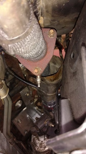

    How did you manage to get the heat shields in with the lack of room?

    I had to cut them in half to reinstall and sealed them up with high temp aluminum tape. It's very close to everything but not touching. In checking temps the manifold as 375 deg, with shields now 185 deg. Probably lower now with heat wrap tape on headers. That was tough to do.

    FYI, I did have to trim a few inches of the fire wall side of shields...

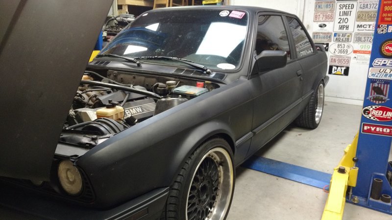

    Yep, 3.4. I've used TACH-ADAPT on my e30 V8 swap, worked perfectly.
