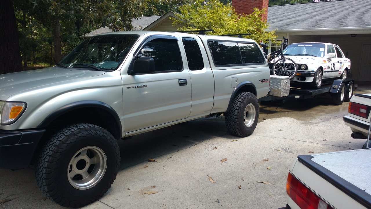

    Tow vehicle is working out good.

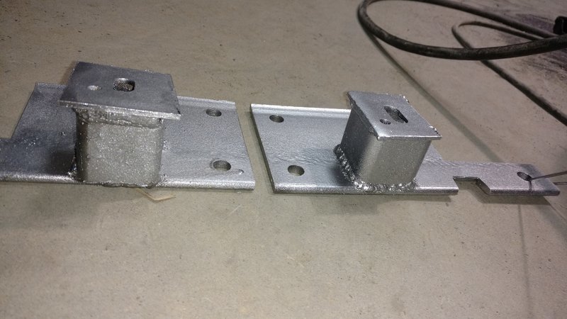

    Were did you get the motor mounts..i have a tacoma sr5 looking for motor mounts for a v8 swap

    They were easy to build, I'm not sure if anyone sells them..

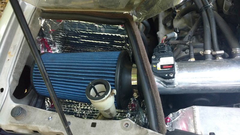

    So, intake temps were waay too high and I built a cool box. Helps tremendously! Tranny is acting odd, not downshifting correctly and after searching looks like the 1st and 2nd shift solenoids are going bad.

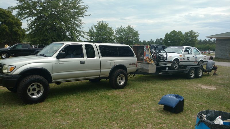

    Just hit 10k on the swap! Still running well, towed the racecar 4 hrs up to the NC/Va border with a/c on no issues IMG_20170901_131911040.jpg

    Update? How's the coolant temps look towing?

    No temp issues towing, I do experience temp creep in heavy extended stop and go traffic on 95+ days with a/c on. I put a heater core radiator with a fan in the front tire well that helps tremendously.
