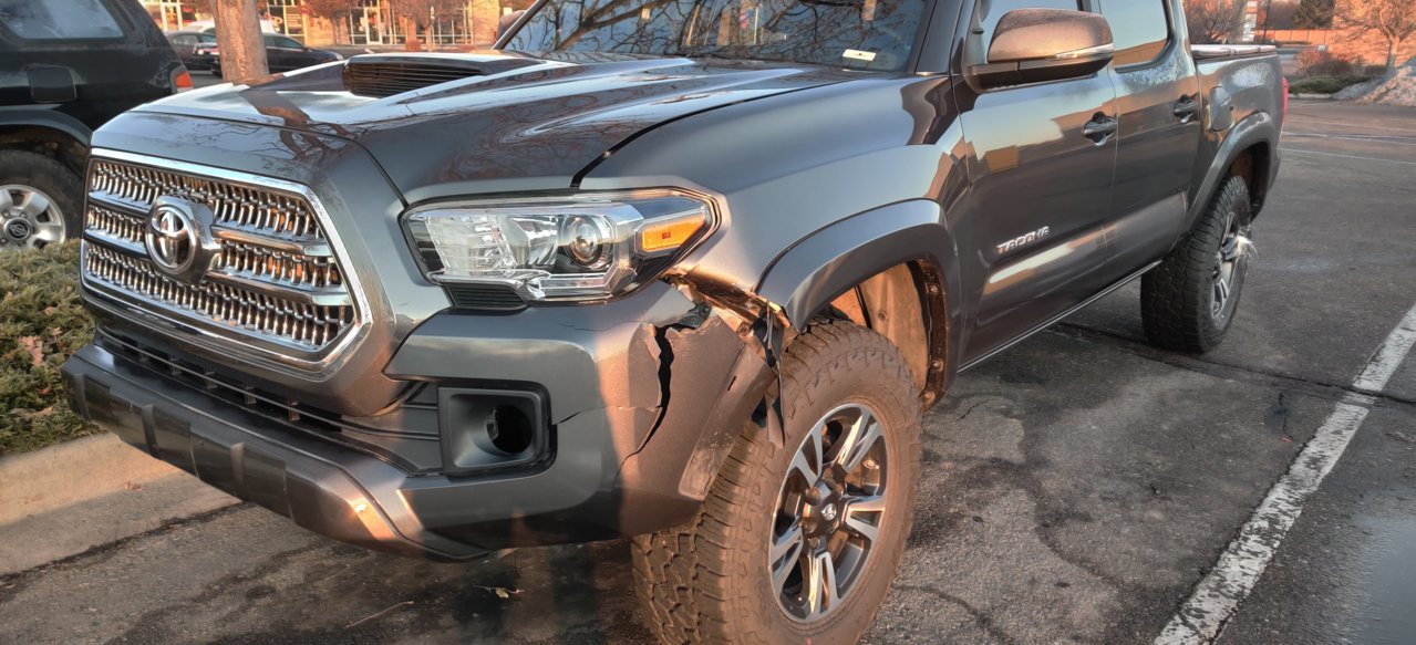

    Well it looks like I fell victim to a deer... He ran off and thankfully I saw him to where I was able to hit my brakes, but he still ran right at my truck. Could be a lot worse, but as of now the damage looks more physical than visual. The headlight assembly is broke and somehow ended up inside the headlight, my fog light is gone and the whole bumper is busted. The fender separated from the hood. We will see what insurance says I guess IMG_20191105_065136.jpg

    Is that fur in your back wheel ? GL .

    Yes, yes it is.

    $2200 but looks like you got sheet metal damage so add some more $.
    Guess how I know.
    Check the fender liner. Likely that it sustained damage from the various connectors getting ripped out.

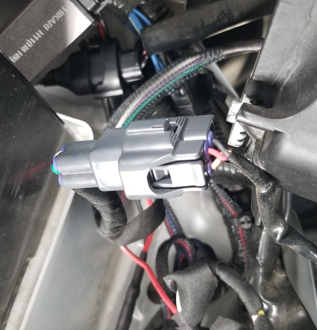

    Check the DRL wiring on that side of the headlight. Maybe the wire is cut?
    It is a connector near the bottom of the headlight, green, purple (maybe pink) and white/black wires.
    Should look something like this. Get a voltmeter or something and check the voltage with the parking brake off.

    That's all it was, the parking brake was on when I was looking around the vehicle making sure everything was good. Didn't know the parking brake disabled the DRL's
