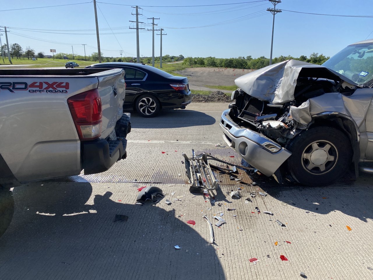

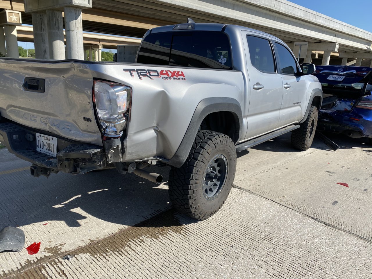

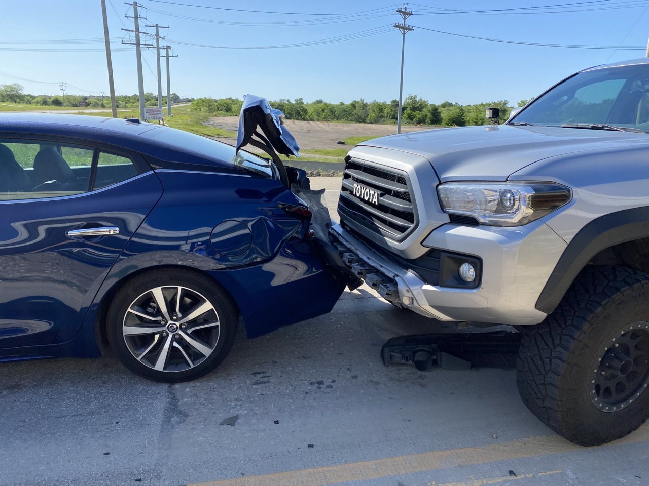

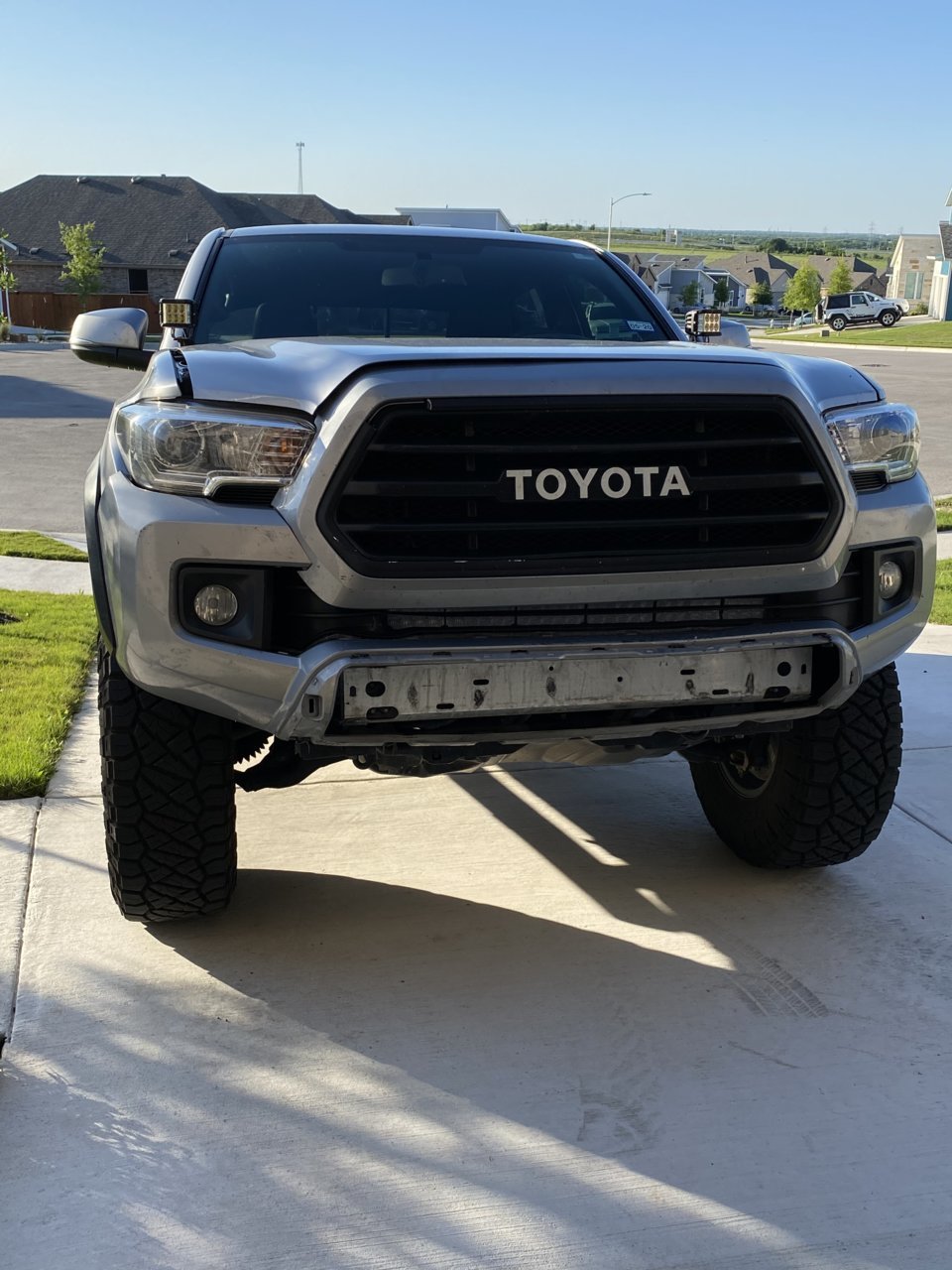

    Well another Taco takes a beating. Guy coming off the highway exit going about 60. Didn't even tap the brakes. Sitting at the stop light and he plows in the back of me and I slam into the car in front of me. Luckily I saw it coming and swerved just a little.
    Regardless, look at the damage of his truck and then look at the Tacoma. Considering the impact it is incredible that more damage wasn't done.

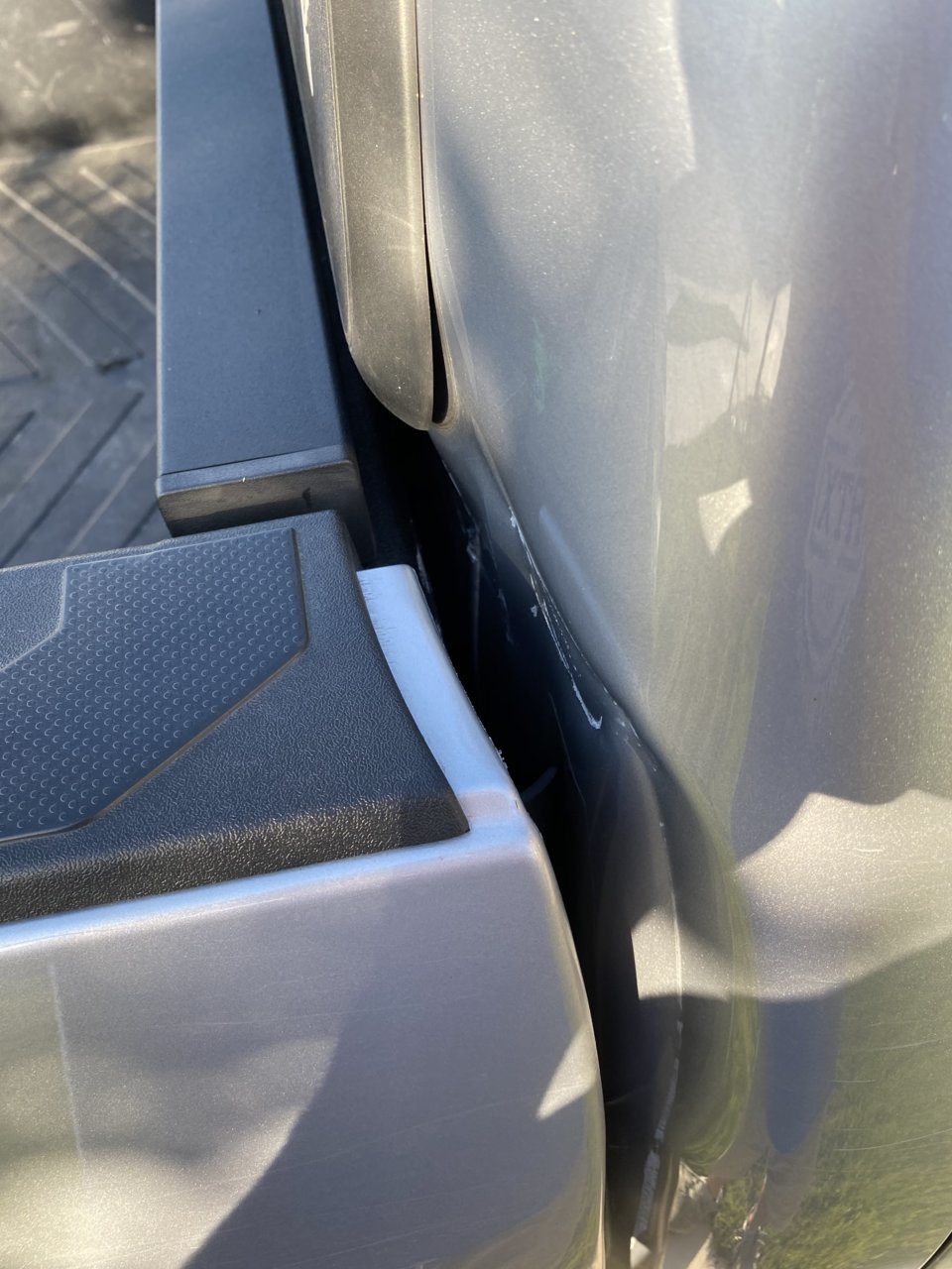

    Does cab damage increase the chances of it being totaled or is a cab repair fairly straight forward?

    Glad you’re ok. Since the bed hit the cab, there is a chance your frame is tweaked. Also cab repairs are expensive if done right, and frame super expensive. I’d guess you’re right up against the totaled mark. But that’s a complete guess going on pictures and making a lot of assumptions.

    Cab damage can be repaired depending on how deep it goes. They can order a side an rear panel of the cab, its welded on under the black trim on the roof, then in the door jambs under the seals, along the front and rear windows under the glass and then along the rear panel and rockers. While its a available part, most will just total it at that point.
    You need tailgate, bedside, composite bed, fender, bumper (front and rear) passenger headlight and tail light, grills, cab side.... pretty much the whole right side of the truck except the doors.
    There is a chance there is some frame damage back there too as the hitch on these take a good amount of the impact. If the airbags did not deploy and/or there is no frame damage, then there is a good chance it wont be totaled, but there is about 10-15k in damage, most of that is going to end up as labor.

    I'm surprised your airbags didn't go off. I'm gonna put one in the totaled column. Too much stuff needs repair on top of the almost certainly bent frame. It did take that whole situation like a champ though.
