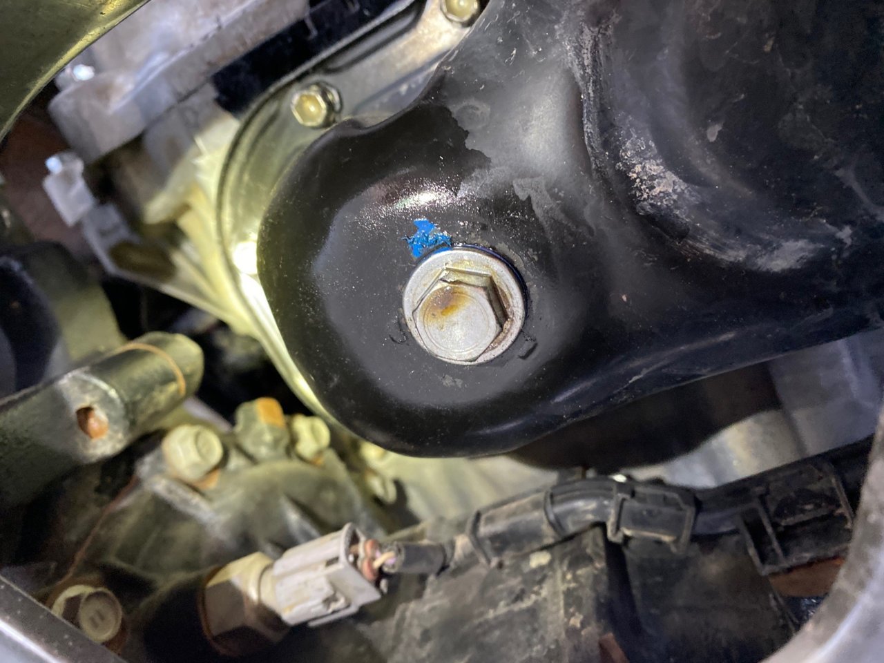

    Got my truck back this morning and tech hours for labor show 13.5. Crawled up under it in my garage and it appears they wiped it all down as well as made a small blue mark on each bolt once torqued. I can’t see any oil remaining that may form droplets but I’ll keep a watch out for the next few days/weeks. I’m working from home for the foreseeable future so my truck isn’t being driven much. If it drips, I’ll be able to easily spot it on the garage floor. Looking at the timing cover I can see new sealant that oozed out so hopefully it’ll hold for longer than the factory gasket.

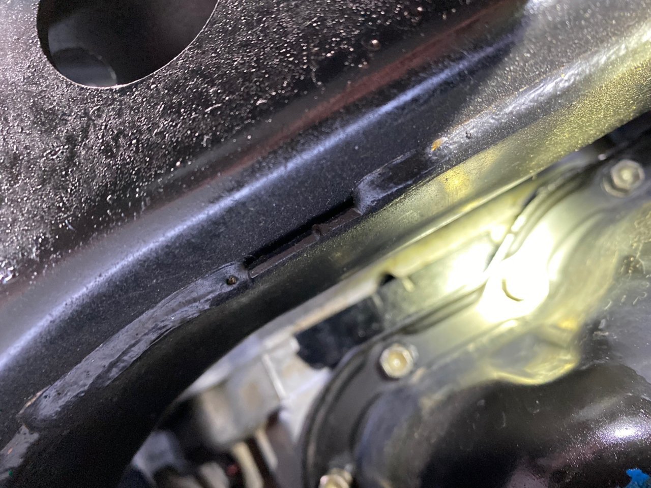

    Well I’ll add my 2016 4wd off road to the timing cover leaking list. So far this truck has been wonderful. It’s still runs like the day I drove it out of showroom. While the gen 3/ are unpopular with some, and I miss the low end torque of that 4 liter, I really have enjoyed this truck. It goes my lightweight camera perfectly. I’ve been all over the country with it. I’m a little insane with how I care for my vehicles. This one is my 7th Tacoma in nearly 40 years of driving. I just changed the oil at 130,000 around a month ago. Then 1100 miles later noticed an oil puddle under the drivers side frame where the box ends. Very strange. Figured since there are brakes lines there maybe a brake system leak. Put it up on my lift. Brake lines are fine. Did some more snooping around. Noticed the power steering pump case loaded with oil. Figured oh power steering pump failing. Ironically the powersteering pump always had a bit of a chirp since truck was new. And about 3 weeks ago I noticed the chirp had stopped. So figured sealnfailed and oil was now weeping out around the shaft. But then looked beyond the power steering pump. Oil leaking out all around the timing chain cover! Both sides and top. Headed off to the dealer. I know the service manager and dealer owner well. They are awesome. Took it in. Sure enough. Timing chain cover leak. He said they have seen a few leaks like on the gen 3. Said usually they only have to snug up bolts. But none as bad as mine. Said they have to pull the engine to get the cover off and replace the sealant and any seals. I could not believe it! 7 Tacoma’s all driven into high mileage 150k plus range, and never a leak like this. They age all run perfectly for me. Even the ok’d ones way back. The truck is not even 5 years old yet! Fortunately the dealer worked their magic with Toyota corporate. My extended warranty ran out at 125,000 miles. But corporate decided that they would pay for the entire repair minus a $500 share from me. I’m annoyed I have to pay $500. There should never be a pull the engine level defect at this young an age. No engine should leak like this. I’ve just never heard of this before. But I’m glad I only have to pay $500. And I do feel blessed that clearly Toyota stands behind their products. They didn’t have to give me anything. I could be out thousands for this. So I’m glad for their resolution even though $500 hurts coming off back side of Covid. Now all we have to do is wait for all the parts they ordered. Which obviously are all back ordered due to the world wide supply chain problems. Fortunately the truck is running fine. I’m watching the oil. It looks like it’s leaking a lot. But it’s not really losing much. It’s so strange that it’s dripping out the box end under the drivers side. It’s clearly being blown back. Just crazy it is traveling that far. And of course also leaking into the skid plates. Maybe this is Toyota’s way of solving their frame issues? Set the engines to leak into the boxed frame slowly and seal the frame on an ongoing basis? Lol. IDK. I’m glad they can fix it. I need 4 more years out of this truck. Still love it!
