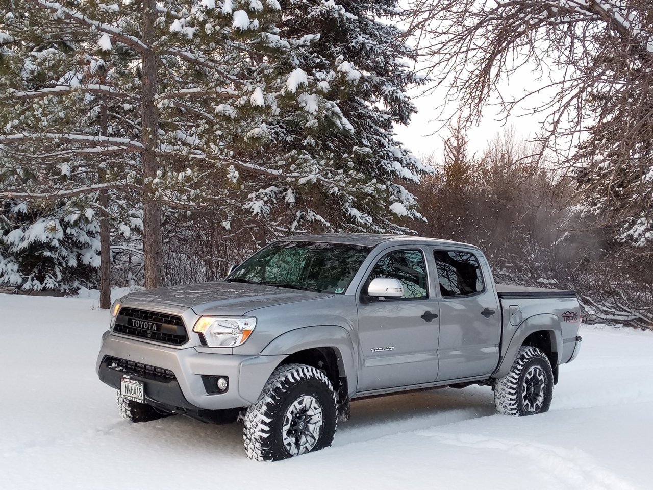

    I have a 2 1/2" lift in the front and run 255/85r16 KM3's. Only one place rubbed in the back -on the inner edge of the wheel molding at full deflection. 5 seconds with a sander and now there is nothing touching. Your mileage may vary, but this is one of the best tire choices I have ever made.

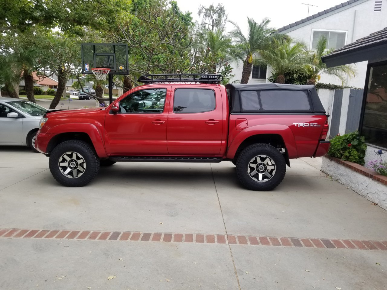

    I'm running Eibach pro lift kit 2.5in front lift with 255/80/17 Toyo OC AT3. Only rub on the front mud flaps while reversing so took those off and no more rubbing. From all the research I did, I think as long as you're running oem specs wheels you should be good to go.
