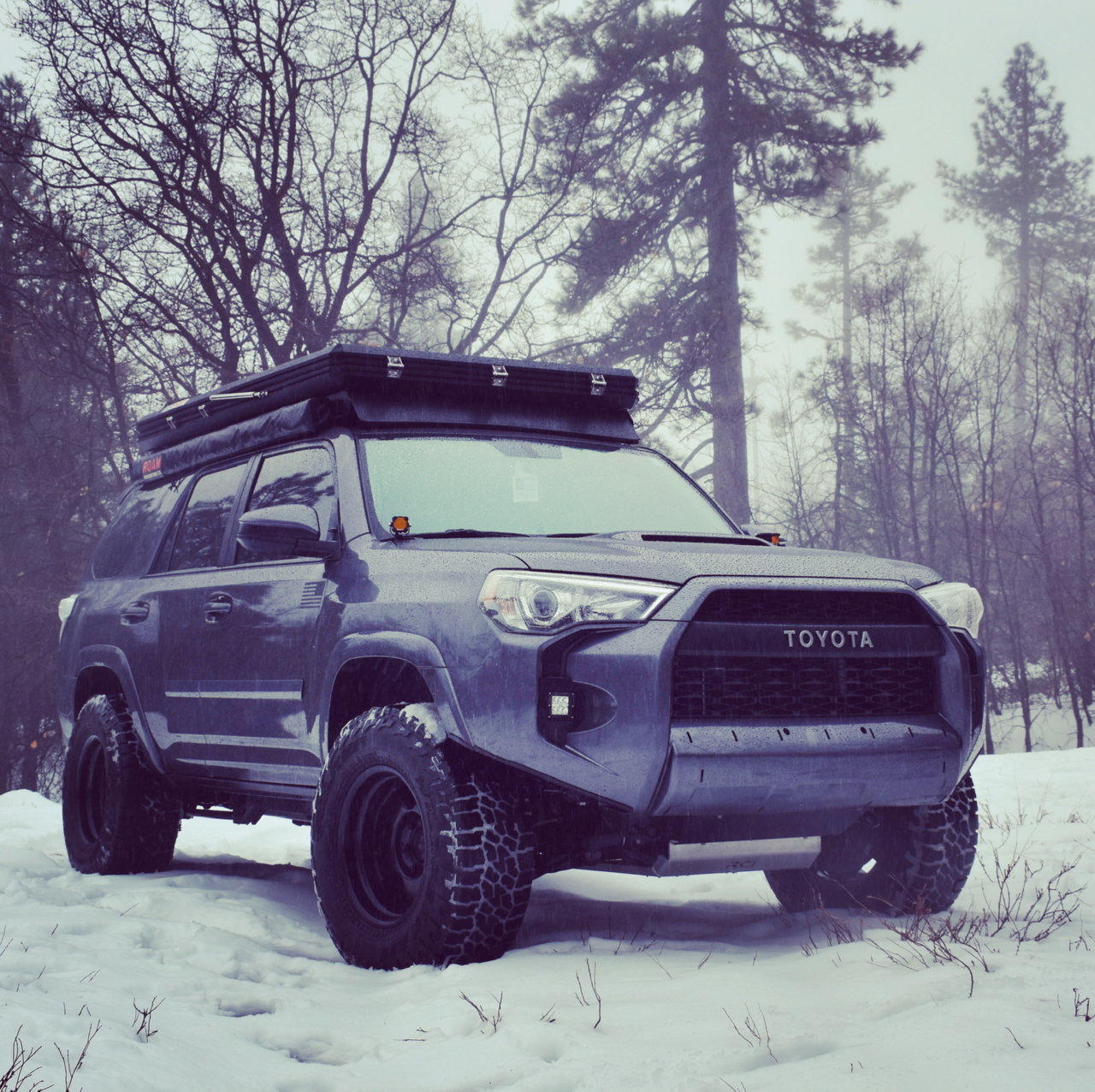

    I had Wildpeaks previously and now have the BFG Trail Terrain TA. Honestly, the Wildpeaks look more aggressive but the Trail Terrains seem to perform better. Granted, I haven’t tried snow yet, but they perform better on dirt, highway and slick roads. Trail Terrains are 3 peak rated for snow performance.

    Exactly the kind of input I was looking for. And a picture too! Thanks!!
