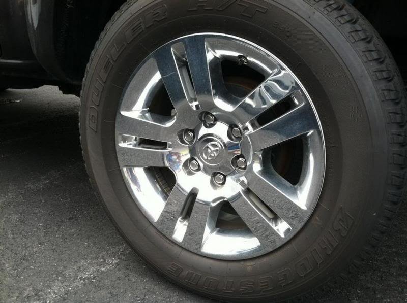

    I have a 2014 DC Limited with those chrome rims .They will fit your 4x4 with out a problem .I want to put TRD rims on mine with 18". I wonder if I can do that
