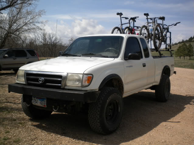

    These are 31's on 15x8 wheels
    This was with OME 880 springs on stock struts. I've since went with 32's, and they rubbed at full lock
    when I hit a bump, even after I did the usual trimming. I just put on Bisltein 5100's on the middle setting
    and have no problems.
