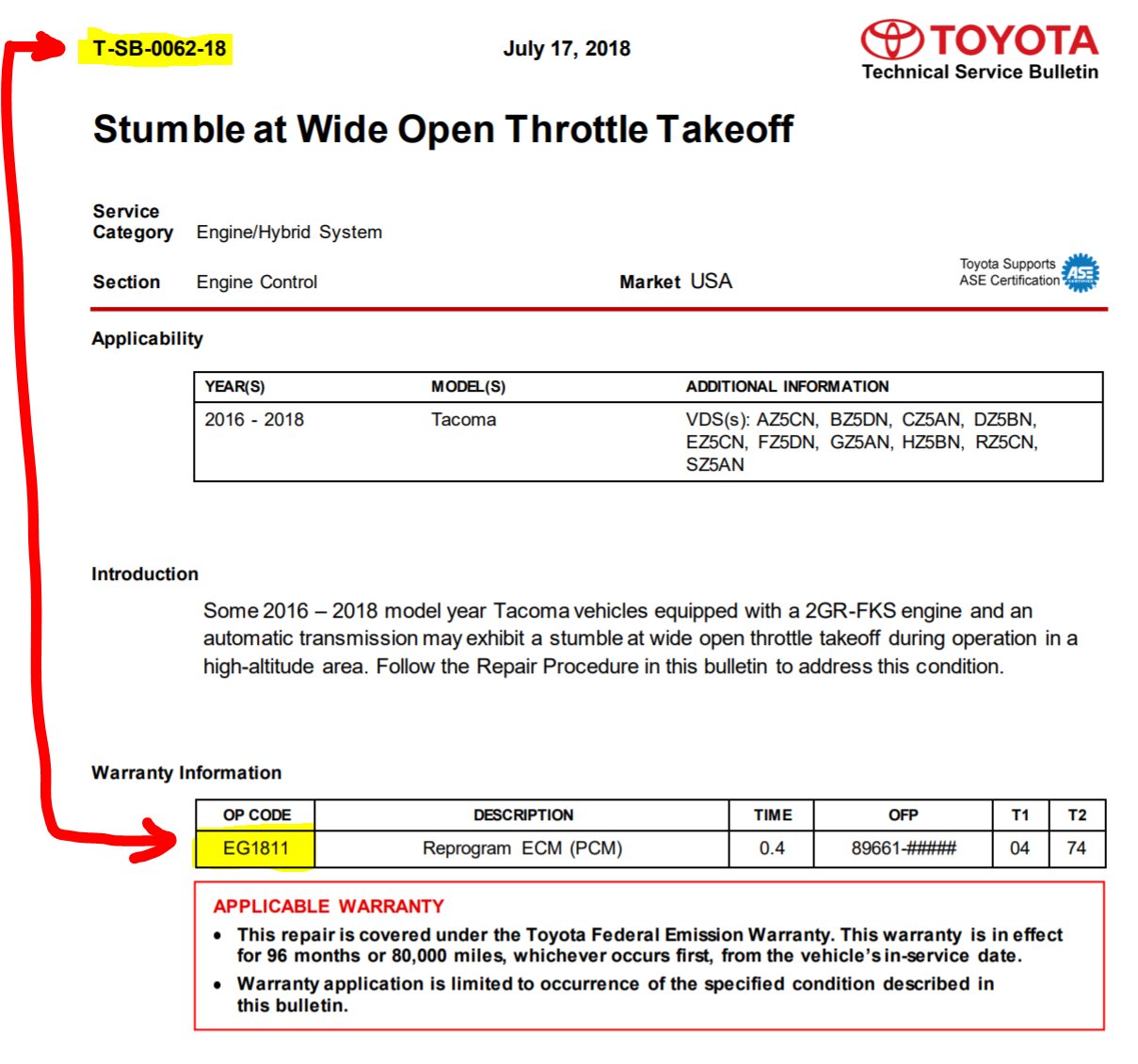

    Took my 2016 TRD OR in for a 30k service and made the complaint about the transmission. This is what it says on the print out they gave me when I picked up the truck.
    "Tech duplicated concern: Reflash per TSB EG-1811"
    Is this the correct latest and greatest software update for the hesitation and hunting for gears concerns?

    I believe T-SB-0062-18 is what everyone seems to be happy about.

    Likely he is quoting the Operation Code for reprogramming the ECM. 0058-18 using Op Code 1810, 0062-18 uses 1811 so it looks like they documented your issue as 0062-18. Doesn't matter since 0058-18 and 0062-18 both use the same update.

    Got mine done Monday, it’s like a new truck, in town and interstate.
