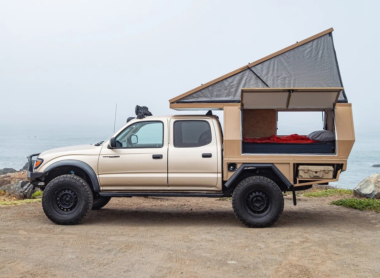

    Love the idea of a vertical pop up tent instead of the a frame style. Not sure if there is one on the market anyhow. Should be a fun/challenging project. Lookin forward to it. Are you going for a modular style system the can be dual function camper/flatbed then?

    I don't use my truck as a truck anymore. Really it's 100% pleasure use. If I drive it it is because I'm going on a trip with it or because I want to hear turbo noises on the way to work. So just being a camper suited to my wants/needs will be good enough. Don't really need a flatbed and I think building it as dual purpose will make it heavier than it needs to be. Building a floor frame just for holding me and the camper should let me build lighter.
