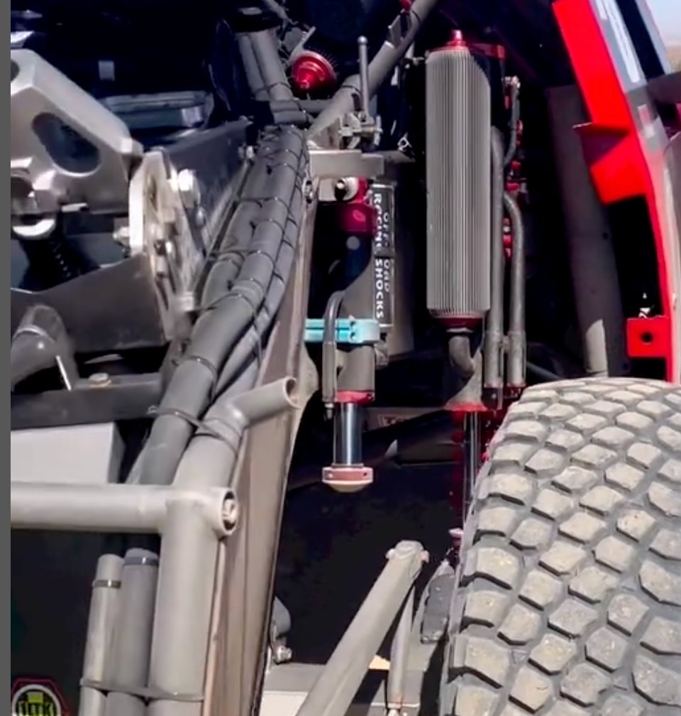

    They do have pretty basic valving, from my understanding. Reports on what pressure to run are all over the map, so I started low (too low) and have been bumping it up. So far I can hardly tell they’re there, super comfortable bump zone since it’s 2” stroke and controls it all the way to full compression.
    They shouldn’t bleed down unless they’re over-pressurized or something. So far mine have kept the exact charge I put in them.

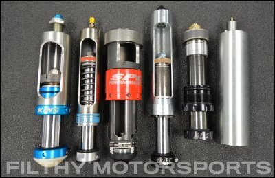

    Depends on how crazy / expensive you want to get
    Here’s a good cutaway -
    Mostly just adjusting pressure rather than changing out shims is what 99% of people I’ve seen diy tuning will do. At some point the shims would make a difference but that’s after all the other variables are dialed for most trucks.

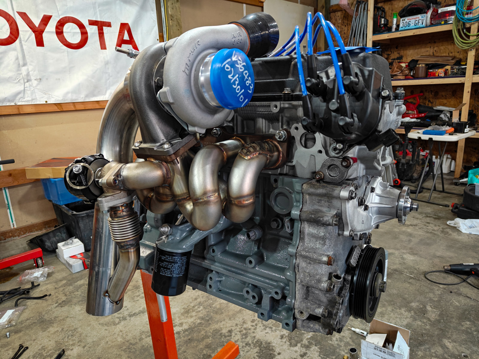

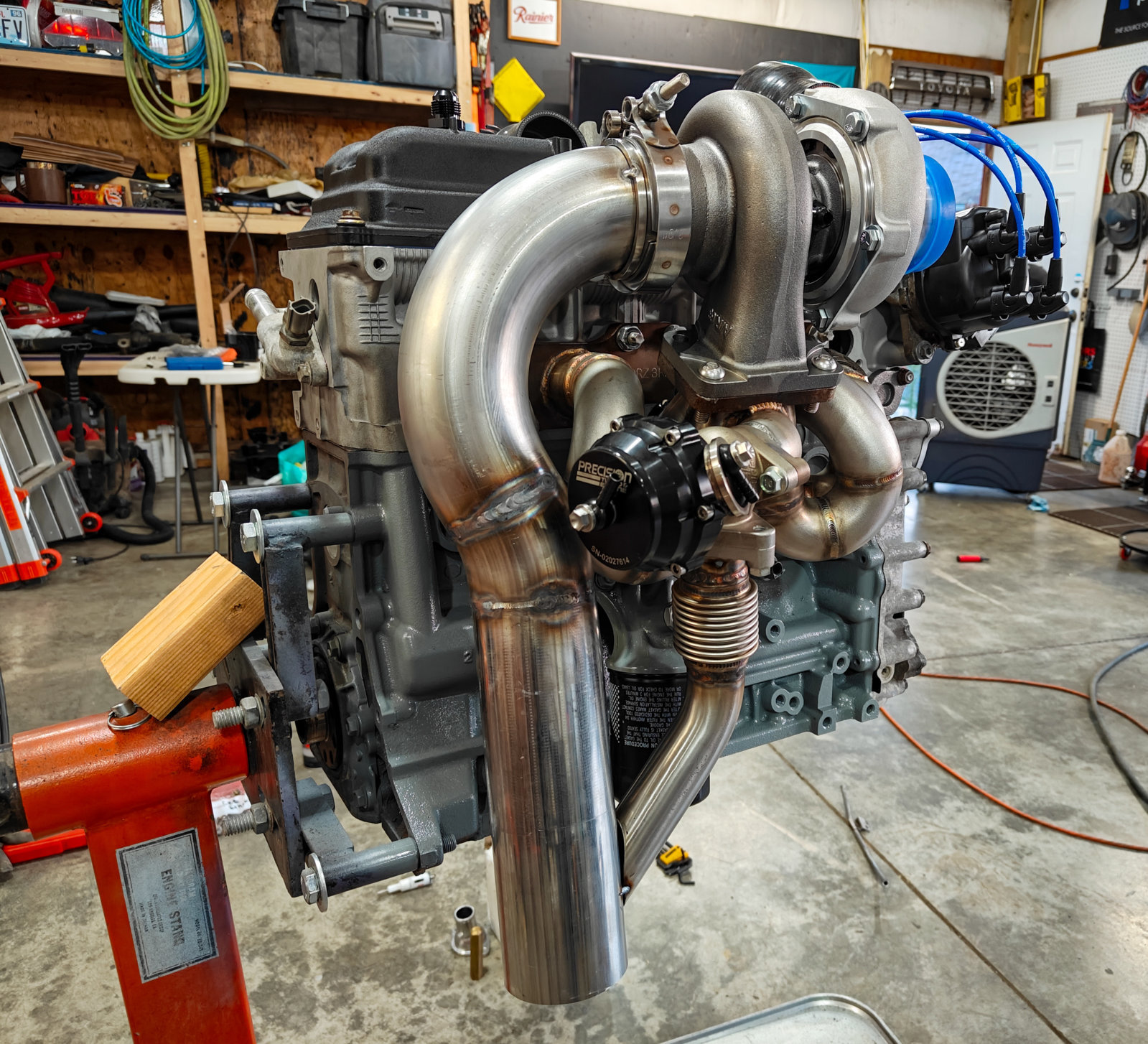

    Things are happening but on a multitude of levels, truck has been running excellent. Pretty sure I need a new alternator, but that's a minor problem. I am going to make my own E-Fan housing so I can have stronger cooling at slow speeds and more potent A/C as well. This week I will likely try to do the whole fan thing, nothing much going on. Been filling up my free time with work and building engines.
    Purchased a used 5VZ with a "tick" from a local guy that parts out wrecked yotas, pretty excited about building it up for power actually. Went out to the junkyard with a friend and harvested a forged VZ crank out of a 3VZ-FE powered 94 Camry as well. Working on sourcing forged connecting rods and pistons now, yes there are forged pistons on the market but I am not interested in lowering my compression ratio. May end up having to commission a set of pistons from Wiseco or CP-Carillo.
    The new 5VZ in question, dunno about the "tick" it has/had but the timing was off two teeth so its got the going for it, which is nice...
    Camry crank in all its relatively rare glory...
    And when I said I was building engines plural... I meant it... buddy is getting his wheeling truck back on the road for camping and winter beater duties again so naturally we had to completely overdo the engine for funzies. Currently in the stages of building a harness for the Haltech Elite 750 and reassembling this nice little 2RZ with some fresh parts including a freshly machined head with a valve job.
    The four banger engines are pretty fun to play with
