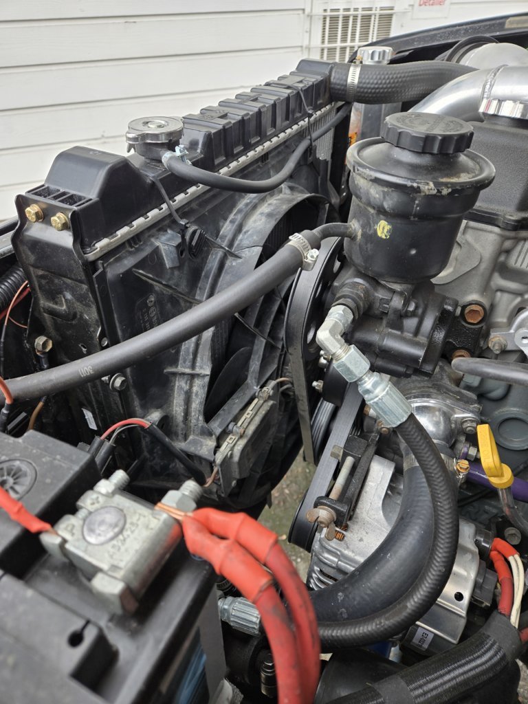

    How's the efan working? Any changes there?
  10. Jan 13, 2025 at 8:23 AM
    #370
    Speedytech7
    Feb 20, 2014
    #123587
    58,363
    FCQM+VG Cheney, Washington
    It's less Tacoma and more mod
    eFan works excellent, no changes there. After I dialed in my PWM map I haven't changed it at all. Most of the time it is 33% DC or less, haven't had it go over 50% at all. Thing has more sauce than the 5VZ needs, it's never had any cause to come on at all over 50mph

    Got details on what specific parts you used to make this happen? I've got a 180 deg tstat on mine. Would a single ignition output on the HT suffice?
    Did you make a shroud for it?
  13. Jan 13, 2025 at 9:47 AM
    #373
    Speedytech7
    Feb 20, 2014
    #123587
    58,363
    Yeah you only need one DPO (Ign out will work), the E46 puller fan (some models have a pusher) comes with the PWM controller mounted to it. The E46 fan is almost the perfect size for the old Toyota pickup radiator that he uses. But you probably want a fan for a Tacoma radiator size like I've got in which case I can put together some details.

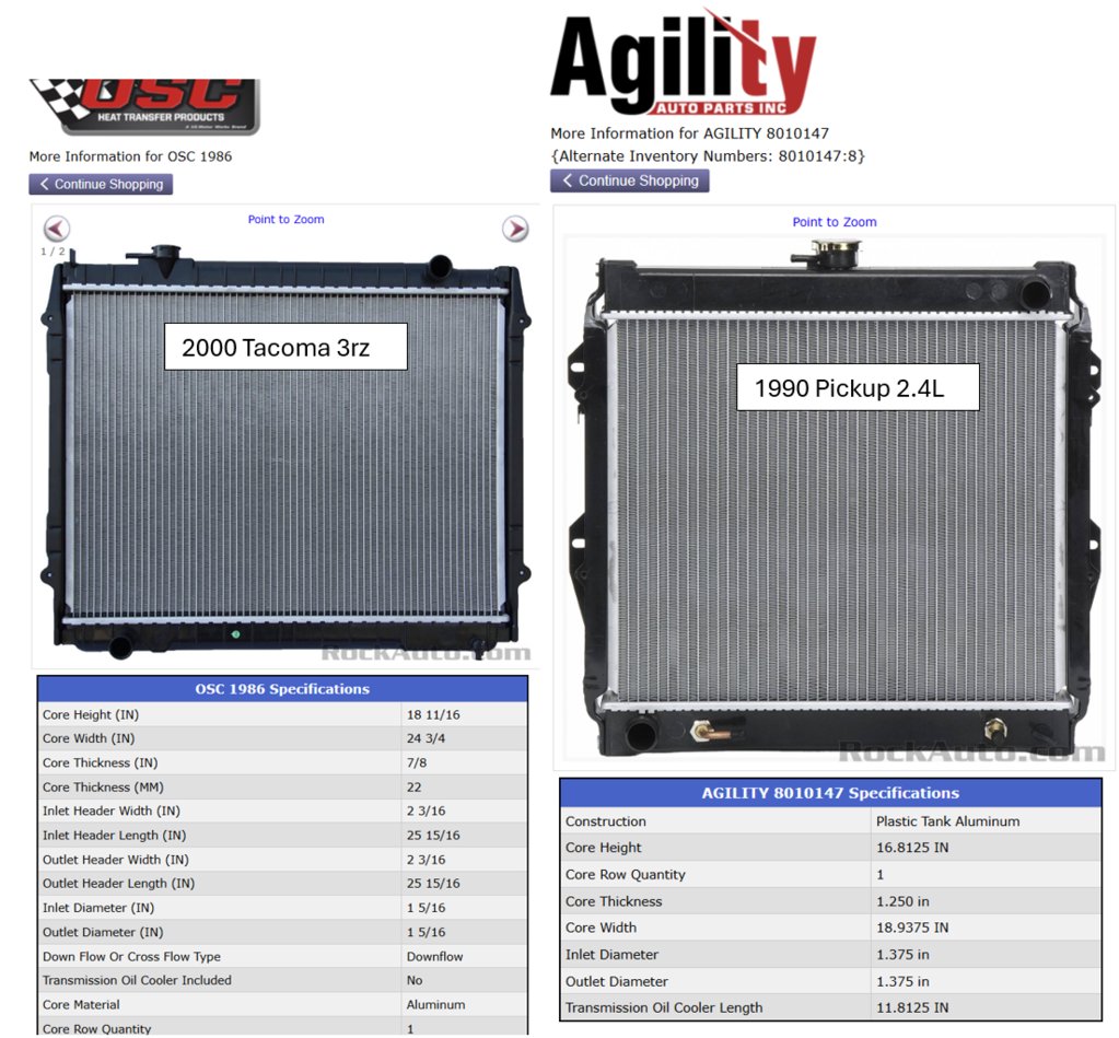

    That would be helpful. Sounds like I could probably get away with a smaller fan too given your DCs.
    Do you and Jayson have the same e46 one? From the same year?
    Looks like the pickup radiator is pretty close to my 3rz rad, so might be the same case for me.
    When you say perfect fit, do you mean into the existing shroud or overall fit for the rad size?

    No, my fan is entirely different, came from a big Ford crossover thing and is large in every dimension, actually a near perfect fit for the Tacoma radiator with the extension at the bottom that Jayson and I made.
    The E46 setup fit his rad as is with the BMW shroud because the pickup radiator is that nice squareish shape.
