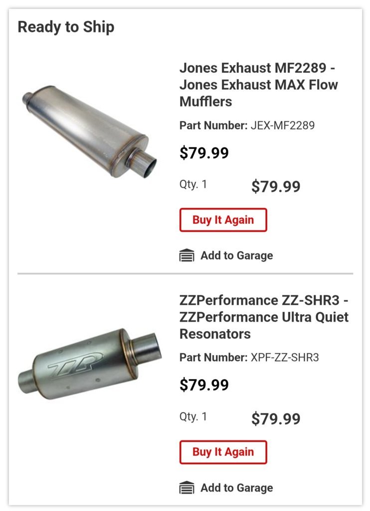

    And because I've hated the way this V6 sounds I bought two things to hopefully quiet it down a bit more.

    This will be the 4th(?) exhaust on this truck since I've owned it and the 5th overall haha. And it will get changed again I'm sure when the camper is ready because the large gas tank will be in the way of its exit path again, but hopefully when that time comes these parts can be reused and the exit can just be rerouted. As for the flatbed frame, that should be together by the end of this week so I can put the truck back together and build everything on the frame in the shop still leaving a bay open for the drag truck project and any other broken thing that find its way here from the fleet of shitboxes.
