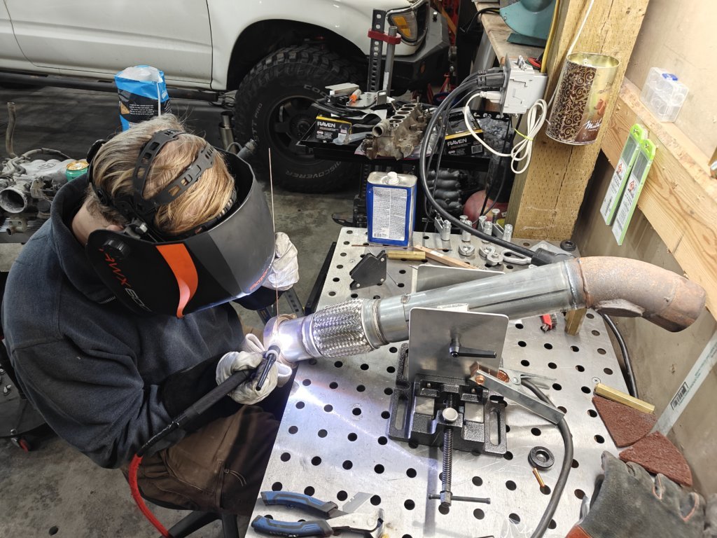

    Nearly done with the frame boxing, buddy wanted to practice tig on the end piece, but the rest I migged in. Didn't make it to pick up my metal order before the metal supply closed for the day tho :(

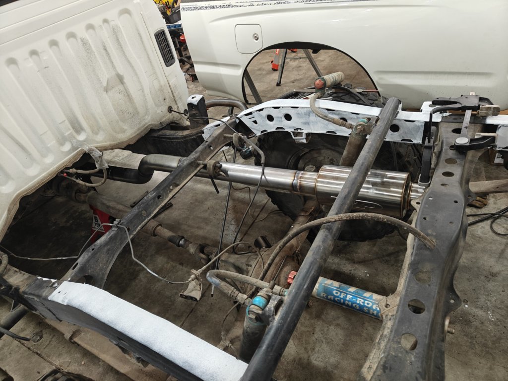

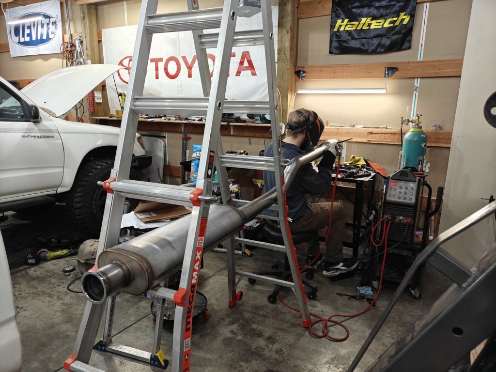

    Doing exhaust things, trying to keep busy, trying not to think too much.

    Tired of hearing this thing so much. Love the turbo noises but the V6 trumpet drone noise is annoying. Still have plenty of turbo noises I think but hopefully this turns the volume down a bit

    I feel ya there. What muffler did you go with?

    Jones MAXFlow (24" muffler) and then further down the line under the bed a ZZP Ultra Quiet resonator. Hopeful that moving the muffler forward in the system (it's basically right below the passenger seat now), putting a resonator in, and getting the exhaust out from under the truck, will ultimately make it more quiet for me in the cab. It was fairly loud outside with only the single FlowFX muffler before and it dumped right behind the cab. Sounded good on idle but was a bit much most other times, and higher RPM under power it had a pretty wicked rasp.

    Just routing it back out the back will be a world of difference. I remember when I dumped mine out behind the cab it was obnoxious

    I'm currently trying to figure out a good exhaust setup for mine rn. Currently 18in magnaflow with an 18in glass pack resonator, but it's still way too loud on the pipe and has a shit load of rasp like what you're saying. Even with it routed out the back. Not sure if a bigger resonator or muffler is the right move, but I think moving it up in the system would help because I can hear a lot of resonating in the test pipe under the passenger seat. Might have to copy you, if you like that muffler

    I’m running a flowmaster high flow cat (single), an 18” magnaflow, and Vibrant Ultraquiet resonator, in that order. Probably louder than Zane likes but no rasp and very little drone. Would probably be even better if I routed it all the way out the back instead of dumping under the bed.
