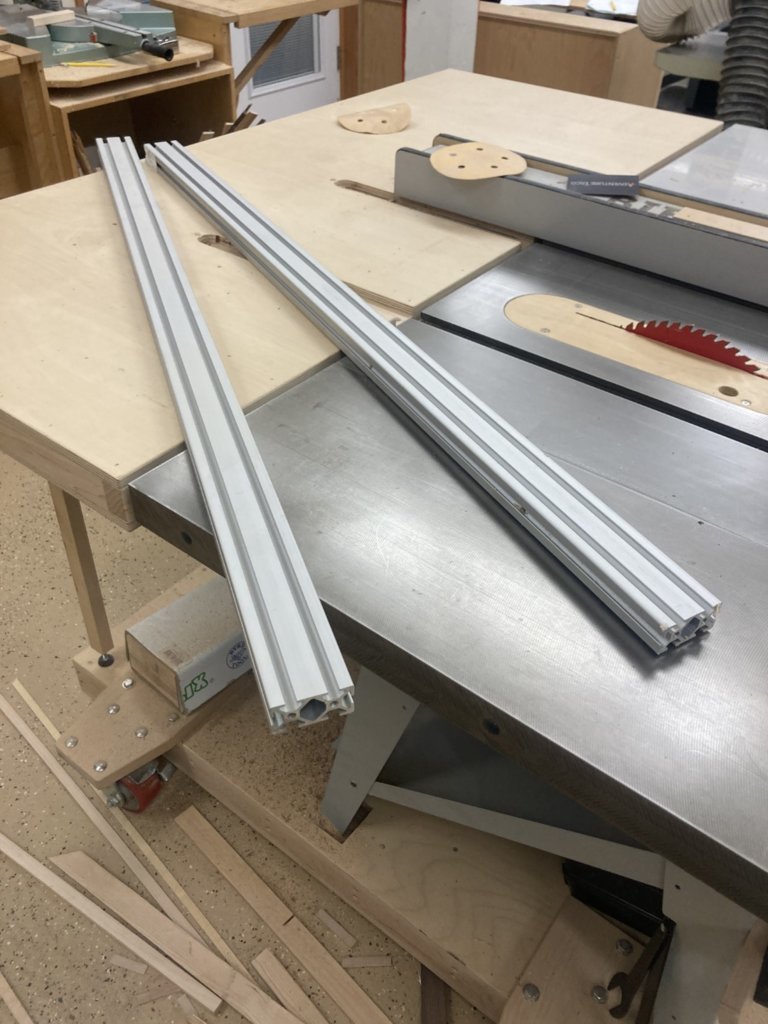

    No schools nearby? Prison doesn't have bleachers? ('cause I know you have a grinder :p) :anonymous:
    Not sure what your actual design is, but I used some 1x2 aluminum extrusion for my 4Runner roof rack, and I bet if you stood that on edge, it'd be stiff enough to be a structural crossmember. Worked great for the RTT and wasn't even on edge.
    Actually, I've still got two 48" sticks if you're interested...though not sure when you'd get out here to pick them up.
    That span for TT (or trex, which is 16", though you really want to support Trex every 12" to prevent warping in warm conditions) is for a no-load installation (i.e. only intermittent foot traffic). Neither is structural.
    Edit: although, as I read again, maybe Zane is looking to fill the whole space as a floor... in which case... MDO plywood and a crossmember would be a good weather resistant way to go.

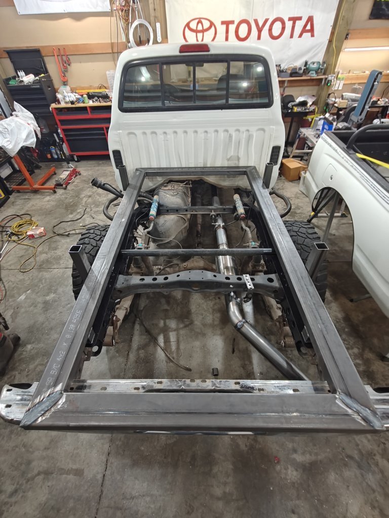

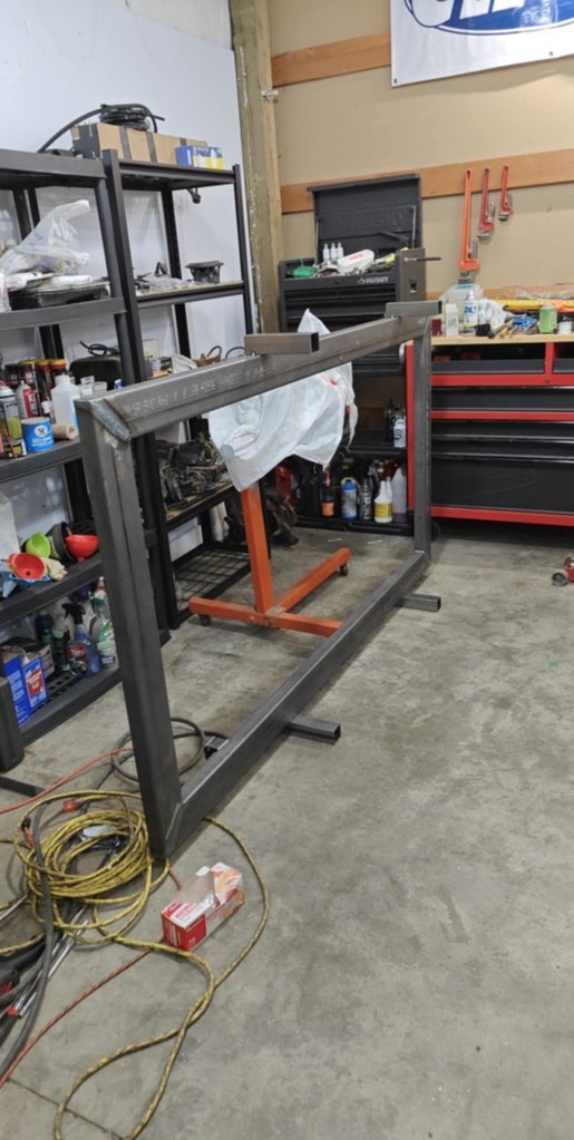

    Frame is done and important marking and outlining is done as well, can build this off the truck now I think. So time to put the bed back on.
    Bed is back on!
    Frame set to the side for a second pending a shop reorganization/cleanup and the integration of some new tooling.

    Prison doesn't have any bleachers I can get to easily enough haha. But yeah I am looking to fill the floor part of the frame using the bleacher extrusion going width-wise to keep the span short. Bleacher extrusion is ideal for its high strength and low weight but I can probably find a substitute.

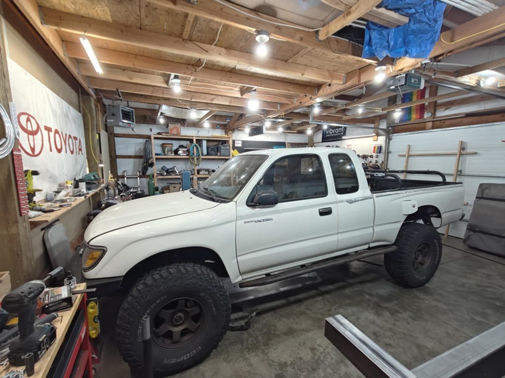

    Aired out the tent and checked some wiring, also test fit the new set of wheels and fresh 35s. Pretty stoked on the wheels actually, truck is just old enough to pull off the retro rims.
