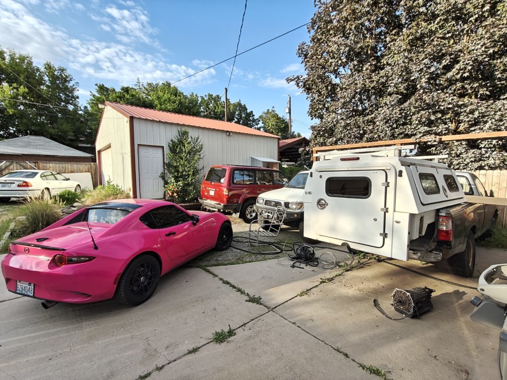

    So anyway, predictably... I own it now. It's in the gentle caring arms of the T-100 for the moment

    Well we took all the stuff out of this one. Minus the doors, I don't have a big scale but I'd guess it is 250-300lbs. I can lift half of it easy enough and it didn't strain a single ratchet strap at all. So uh, a little heavier than my bed slide haha

    Yeah, I was pretty stoked on how easy it was to shed most of the weight out of it, this camper plus the frame we've already built for the new flatbed is maybe within +/-100lbs of the stock bed with nothing in it. And I still have to finish removing the bed slide frame that came with the camper, so it has maybe another 30lbs to lose. A lot of things are made cheaper and simpler with this as the base for the design. Most notably I don't have to make an aluminum camper frame now or figure out how to bond FRP panels weather proofed to it. Downside is the modifications and repairs I do have to make will have to be done with fiberglass, which I don't look forward to but at least is straight forward and after a gelcoat is very weather resistant.
    Also finally found a makers mark on the damn thing (it's maybe a 2003 or so BrandFX body), it was for the weirdo 7' bed Ford Rangers... which in some clandestine turn of fate is the overall length of the new bed frame we knocked up. The design of the slide in structure has it focusing its weight on two big structural rails underneath so only those really need direct support form the truck, everything else is cosmetic to make it fit the vehicle it was designed for.
