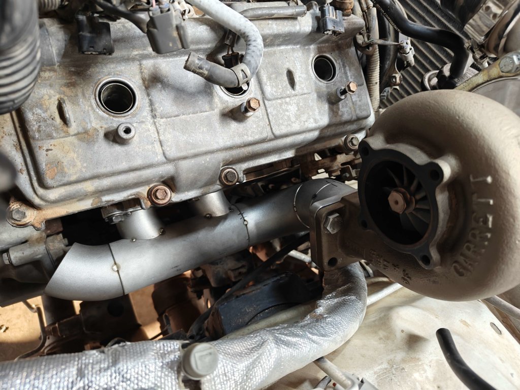

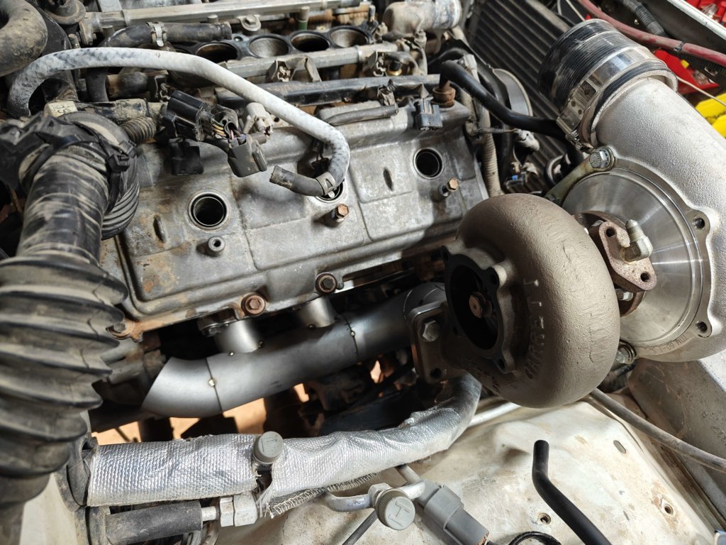

    Took all of the old turbo kit off last night, will modify it to have better crossover fitment and fix the couple of cracks that resulted from that tight fitment, should clean up very nicely for the next person.... But who will that person be?
    I have been eyeballing a new turbo so I am considering selling this WHOLE kit now. That means it would come with the manifolds, the intercooler (no pump or heat exchanger, you'll have to find those for your build), the turbo (genuine Garrett 60-1 with Stg 5 turbine wheel), the intake piping too. The only things you'd need to provide are a wastegate, blowoff valve, intercooler pump, and a heat exchanger that fits your truck. For the right price I can rustle up a blowoff and wastegate, a new blowoff that fits the intake from Summit is $70 and I think I have a Precision wastegate I could be parted from as well on the shelf somewhere.
    So... anyone interested? Say $2200 with the turbo and piping shipped in the lower 48? $2500 with a new blowoff and a lightly used Precision wastegate (gate is worth $250 I'd basically toss in the blowoff free at this price).

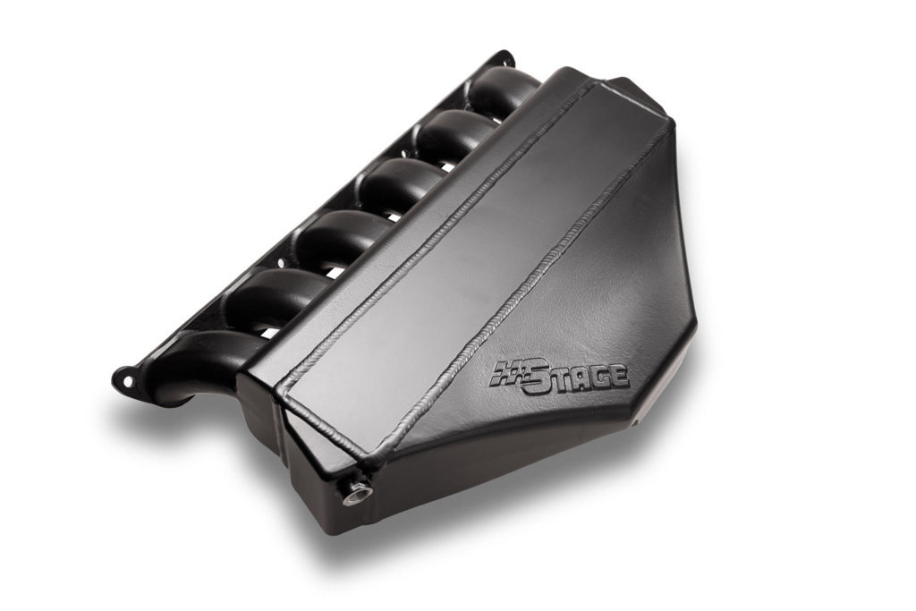

    Still going to be water to air so no major heat soak to worry about, and we are designing it as a replacement for the top plenum piece, drop in, fits like stock type of deal. If you have an electric fan like I do you also draw a ton more air through the AC, radiator, and IC heat exchanger, so heat soak risk is mitigated even more.
    I'm not in the shop where I can show you the mockup parts yet. We've been in contact with Bell intercoolers and they're recommending a core to weld into the manifold for us.
    Going to be something like this but obviously for the 5VZ, I have no idea what this actual manifold I'm showing the picture of fits it's just going to be this type of design.
