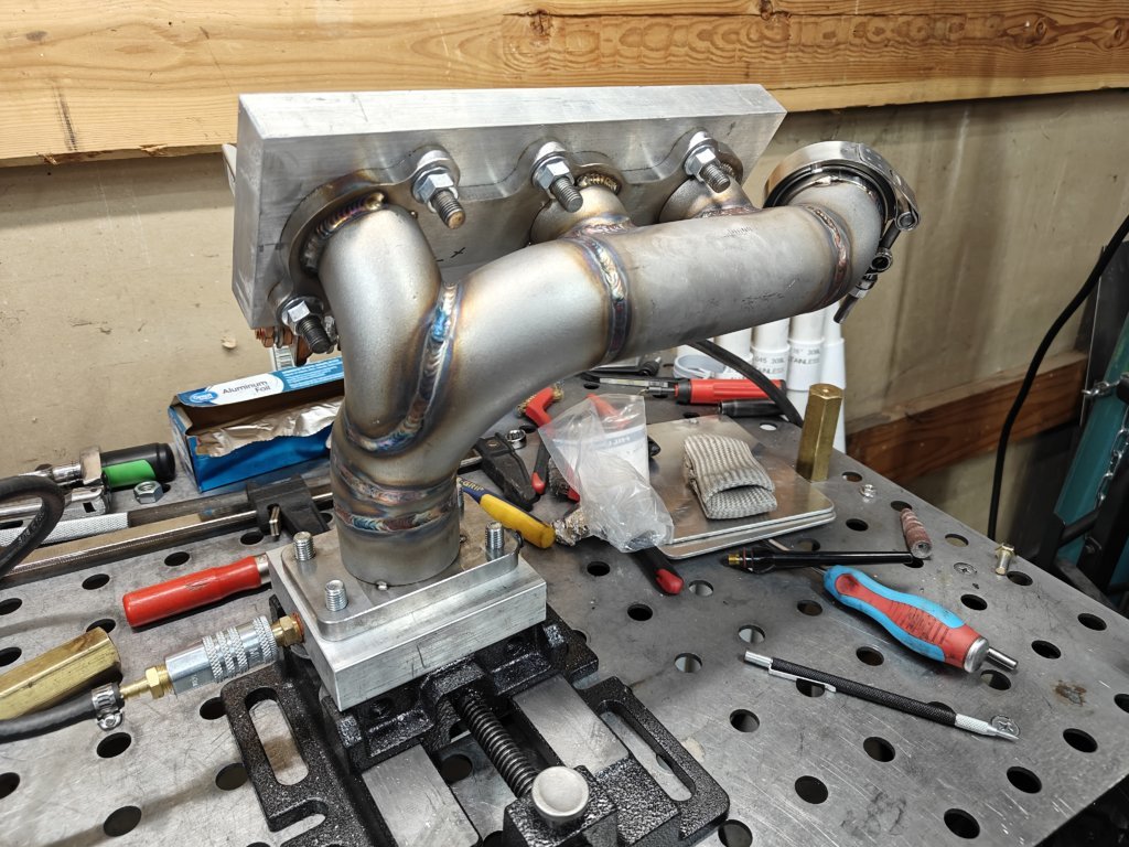

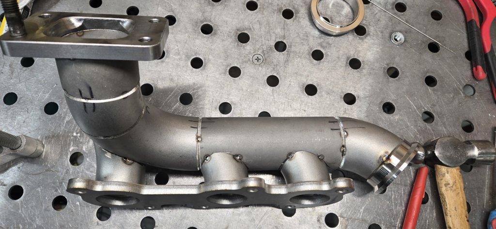

    20250627_215033.jpgWell, here is the final tacked passenger side. All the runner merges drilled out and smoothed, the super fun front runner merge is fitted up nicely! Should get to finish weld this section soon!
    Finished the twin scroll t4 manifold for my rx7 as well! First complete manifold build! Very stoked to be making them!

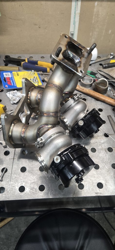

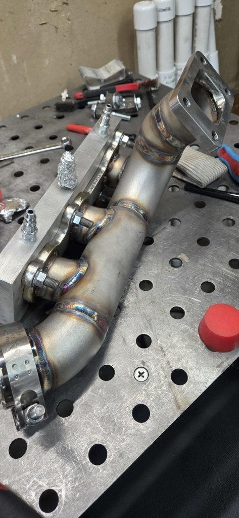

    Progress is occurring. Heat sink purge blocks really help keep the warpage from welding at bay. After going over the flanges with a straight edge and a set of feeler gauges I wasn't able to get more than a .004 feeler in anywhere... that's nothing for a gasket to seal... and it was sort of a flawed test since I didn't think to check for warpage before welding.

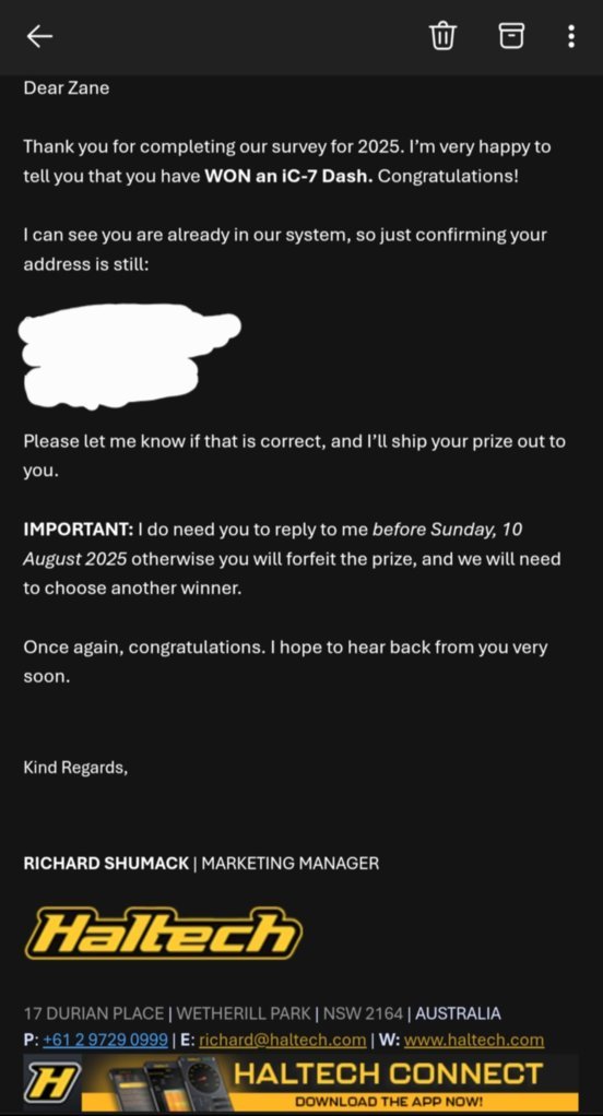

    Got mad lucky and won an IC-7 in the 2025 Survey drawing from Haltech... so I guess this has to go on the truck now.
