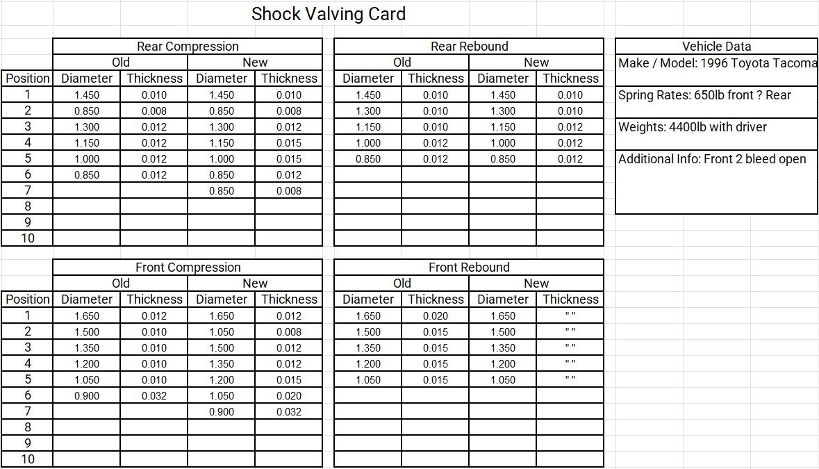

    Did you post what you ended up valving to? the stack you posted earlier doesn't seem to have a flutter in the rear?
    also the quote from expo forum guy is... uh... but either way High speed video of your truck hitting the type of obstacles you want to improve performance on is going to be more useful than an accurate understanding of the maths.

    It's the same, can see there is a flutter on the compression side of the rear. I won't argue that Expo forum guy is 100% right or wrong, but it's decent perspective to focus less on the trucks weight. I have two ideas on what to do with the rear and I'm going to consult with Ben from Filthy motorsport once more before making up my mind I think. I know these 2.0s aren't my forever solution but they're a good set of shocks to get a feel for this process on.

    So pretty sure in the rear I am going remove the flutter and make only the smallest shim a .015 on compression and going to change the rebound stack to a straight .008 stack. Aaaaand begin gathering parts and pieces for a rear 3 link, my truck is light enough to get away with it.

    Ordered some shims to get this job done again. Rebound on the rears is going to a straight 8 stack with a 10 in the smallest position and that's it for rebound. All three bleeds are open by default but I am considering drilling one out a little larger too but I will send it as is first to gauge the change.
