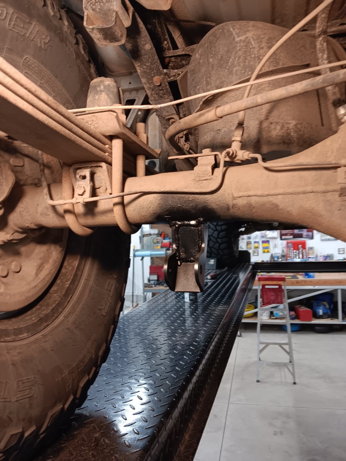

    Okay, revalve done... again. This is what I ended up with...
    And I have to say wow, what a difference. Finally think I am really on the right path and so far this is the best any of my trucks have ever rode. Definitely a little room left for improvement but it would just be nit picky at this point. It's nice to know that my gut feeling that it was "packing" was correct, too much rebound damping for these springs. I just bombed a washboard road aired up and with a mostly empty truck and it was buttery smooth, like a normal road.
    Also welded in a replacement lower mount and a reinforcement plate to both.

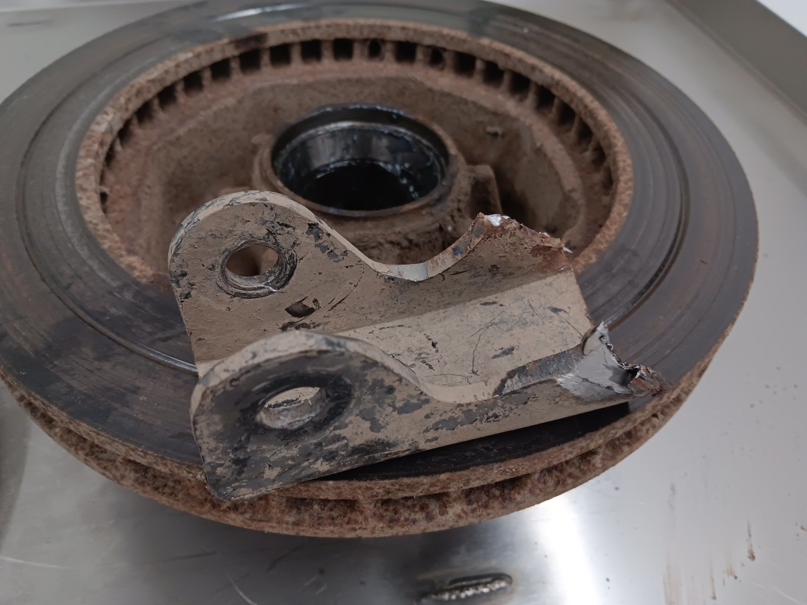

    Man those shock mounts hang down so low. Those would be complete rock magnets on the trails I frequent
  4. Nov 6, 2023 at 9:15 AM
    #104
    Speedytech7
    Feb 20, 2014
    #123587
    58,555
    FCQM+VG Cheney, Washington
    It's less Tacoma and more mod
    They are on mine too haha, the shocks were purchased for a different location and I'm making do with what I have in the mean time. The last mount didn't bend on it's own lol
    Believe me I'd love to move em but I've got to get the sequoia axle on since there isn't enough room outboard otherwise even with 2.0s

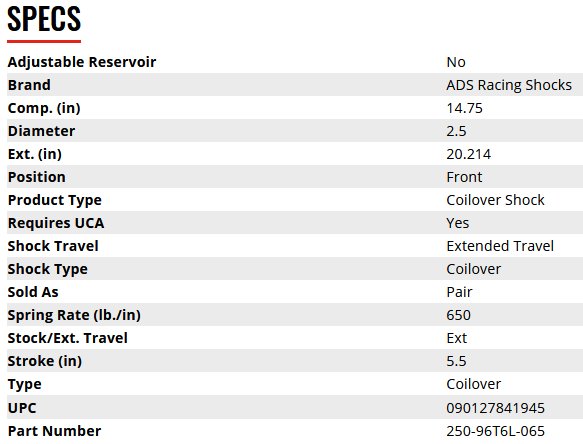

    The thing about factory fit coilovers is they rarely tell you extended and collapsed lengths... really why would they, they already told you they fit :p
    But ADS is different, they give specs...
    So that means an ADS extended travel shock measures out at 20.214 extended... and it just so happens I have this on hand still for the SAWs
    Looking at this we can see a SAW "standard travel" has two measurements... and that brings the question of where ADS measures from on a factory fit coilover... the top of the tophat to the lower eyelet or from top eyelet to lower eyelet. The number that makes the most sense with what I've heard and observed about our front suspension would be from tophat to eyelet (also the safest number to work from), otherwise there's a whole inch of shock travel missing from these SAWs and an inch of shock travel on our IFS is much more at the wheel. From what I've seen extended coilovers generally provide another inch of wheel travel over standard, maybe up to 1.5" depending on CO brand. So a little over a half inch of shock travel is actually missing. I need to chop off .634".... totally doable on that spacer.

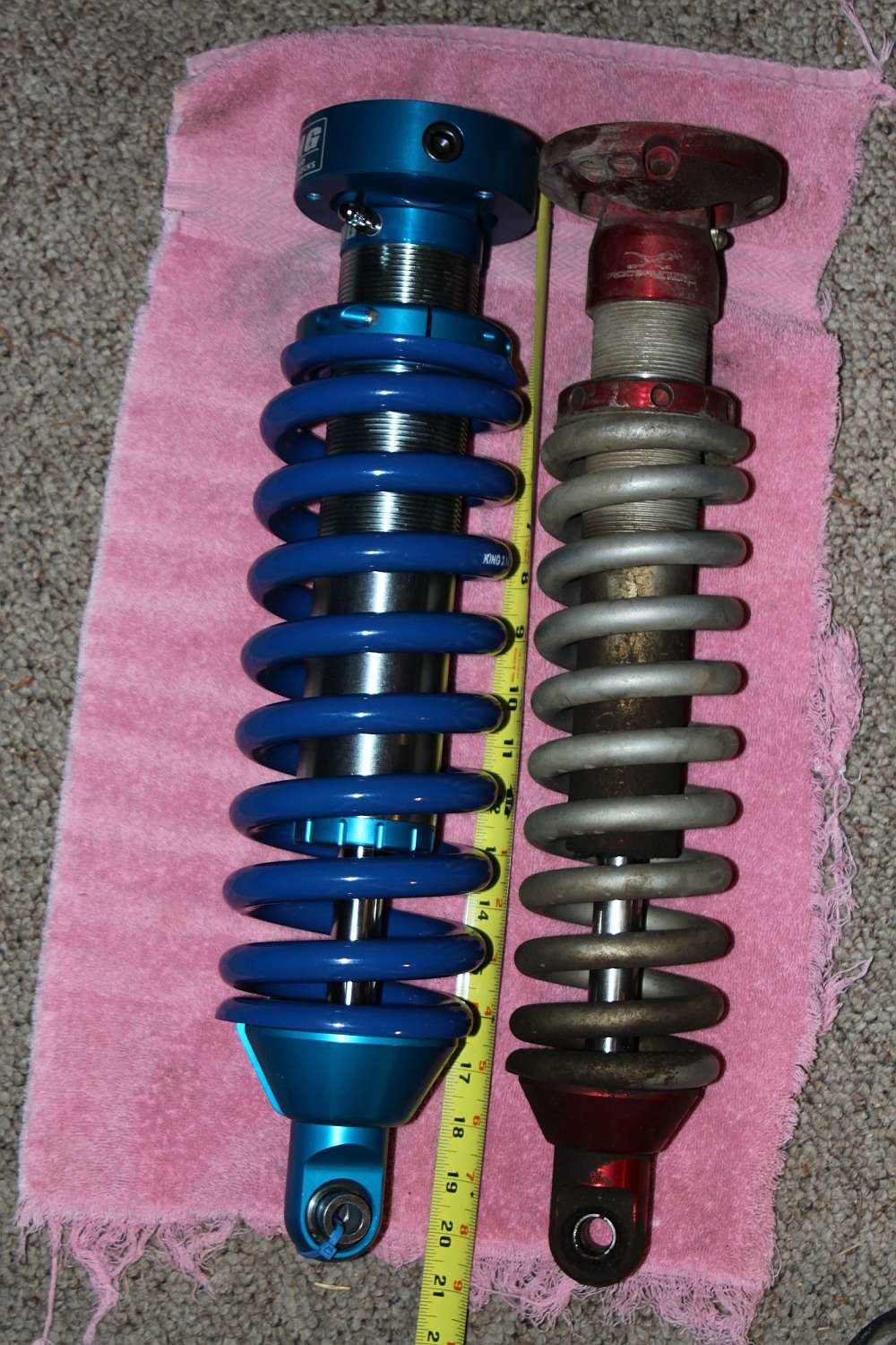

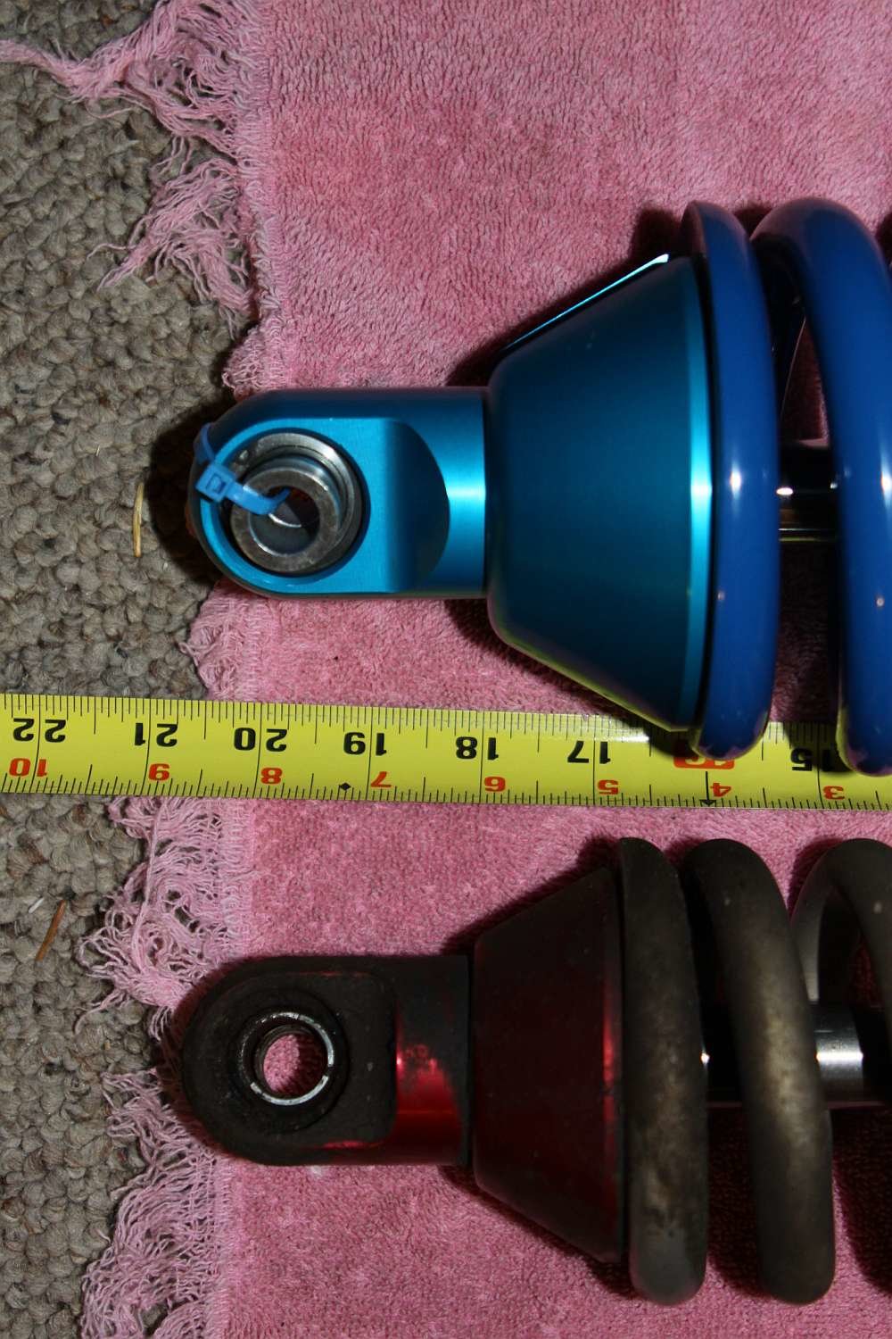

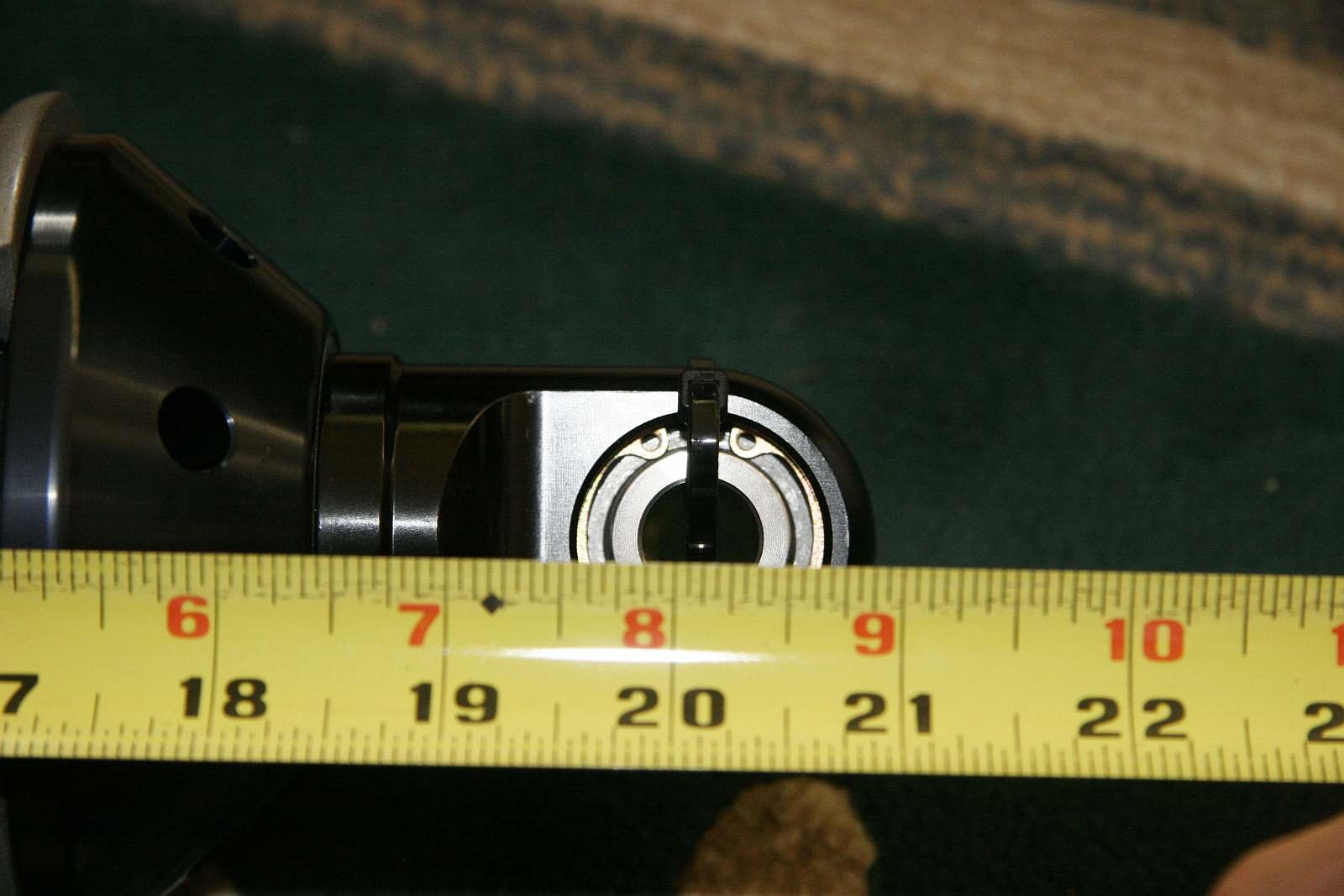

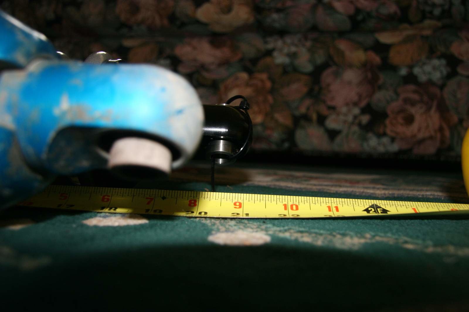

    I've had SAWs, Kings and now ADSs. They each do 'extended' differently in terms of talking about it. Like SAWs = not at all. Kings were conservative and their extended version is the least extended of all. The ADS extended version extended length is a good 3/4" longer than the King extended version.
    A couple of photos from back in the day comparing SAWs and Kings:
    The SAWs were purchased in 2010 and may be an earlier spec compared to what they do now.
    Some photos comparing the Kings to the ADSs:

    It kind of looks like your sway away 2.0 had the same as your king extendeds. Which begs the question how short are King standards? I have sway away 2.5s which are pretty much similar extended length as the two in your picture.

    From the image and from what I recall, the SAWs were maybe 1/4" longer than the Kings. I remember being very surprised by this and a little concerned.
    Before anyone questions whether my Kings were in fact the extended version, I asked this of Tim. When he rebuilt them he confirmed they met King's specs for extended.
