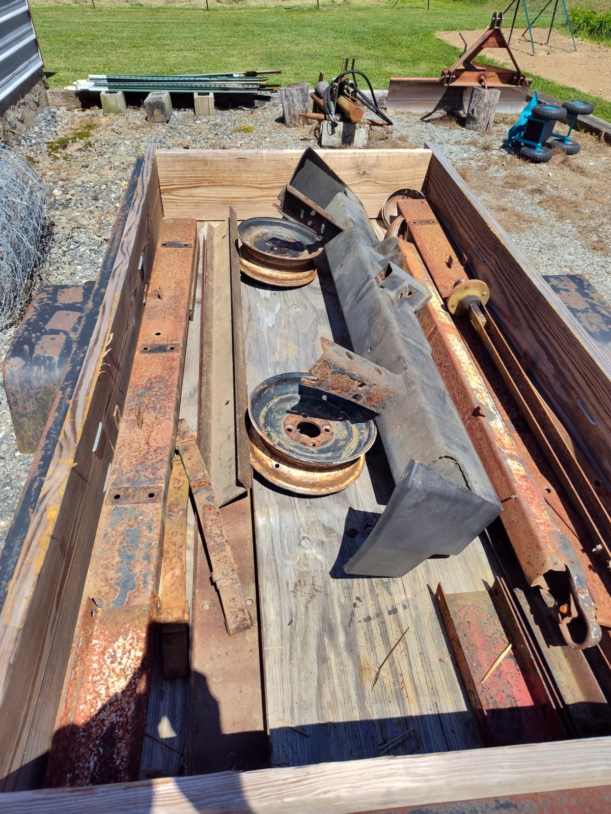

    Gave away my present utility trailer. Wasn't exactly what I wanted. I've built and sold around 200 utility trailers, so you would think I could get it right.
    Number "A":

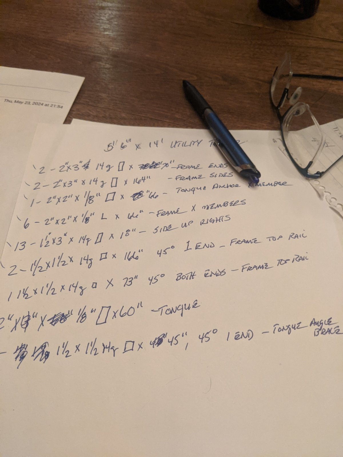

    Chicken scratched a rough material list.
    This is not complete, but will allow it to become a rolling chassis.

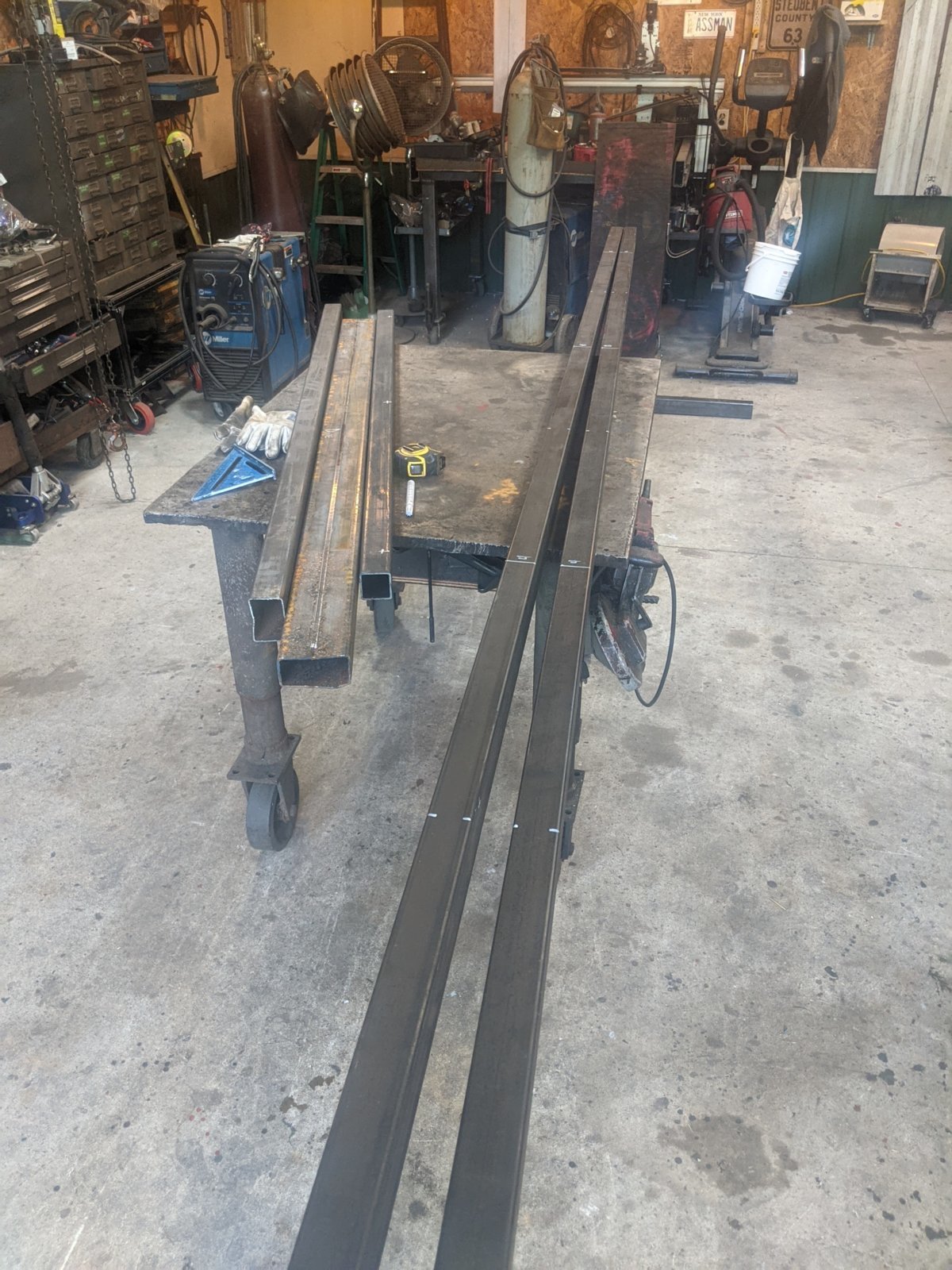

    This what $550 in iron looks like.
    At least they threw in the cutting to size.

    Yep, they old as shit! There has been very little change in the trailer axle industry in the last 50 years...except thinner axle tube is used.
    These are 1/3 heavier than what you can buy today.
    Bearings and seals are still the same and can be purchased at any NAPA.

    A little better version:
    2- 2"x3", 14 gauge, 70" rectangular tubing-frame ends
    2- 2"x3",14 gauge x 164" rectangular tube - frame sides.
    1- 2"x2"x1/8"x66" square tubing-tongue anchor/cross member.
    6 - 2"x 2" x 1/8" by 66" angle iron-cross members
    13 - 1.5"x3"x 18", 14 gauge rectangular tubing-uprights
    2- 1.5"x1.5 " x 14 gauge x 166", 45° one end -side top rail
    1 - 1.5"x1.5" x 14 gauge x 73 in 45° both ends - top rail, front
    1- 2" x 4" x 1/8" rectangular tubing 72"- tongue
    2- 1.5" x 1.5" x 14 gauge x 45" square tubing 45° one end - tongue angle braces.

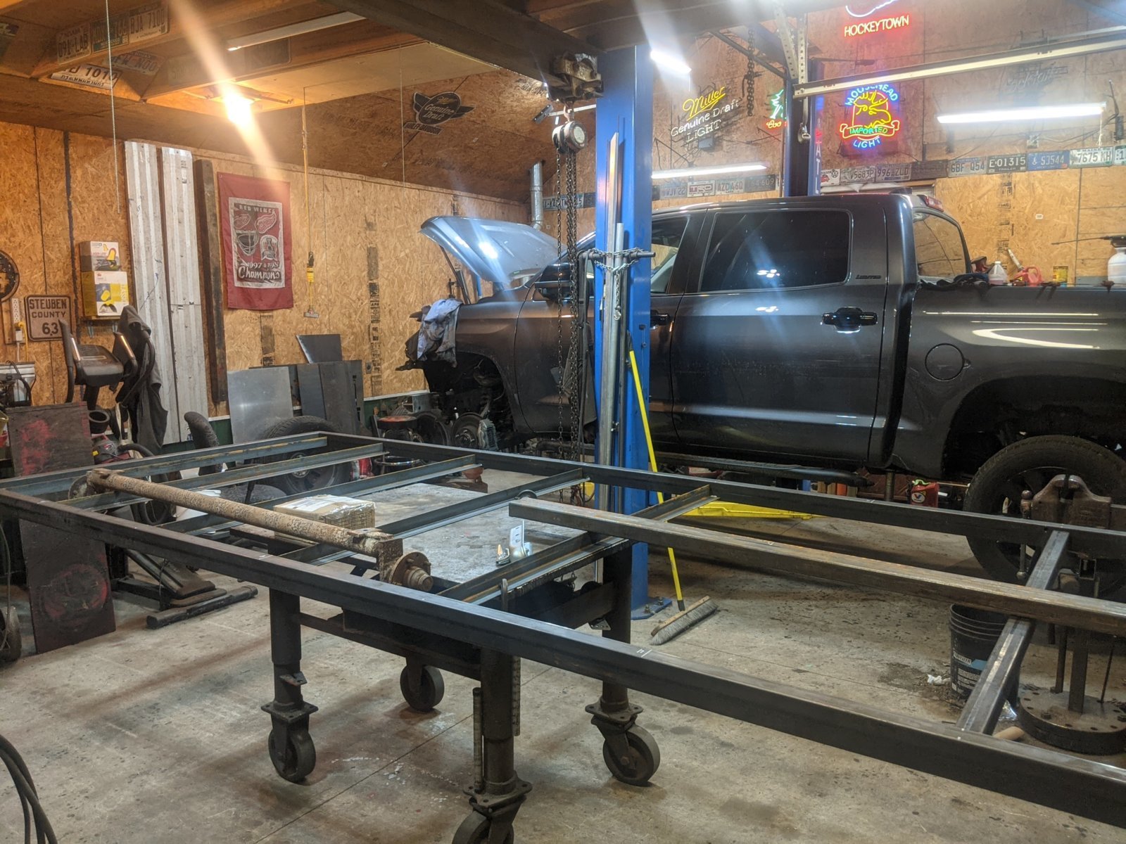

    Rough layout of the frame. Now to square it up by measuring diagonally.

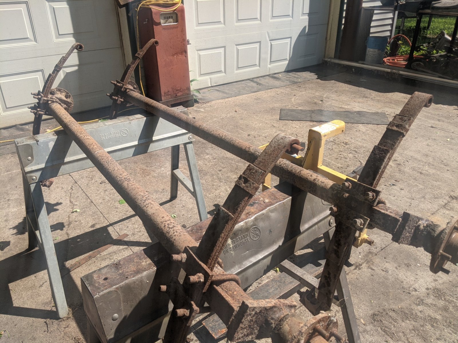

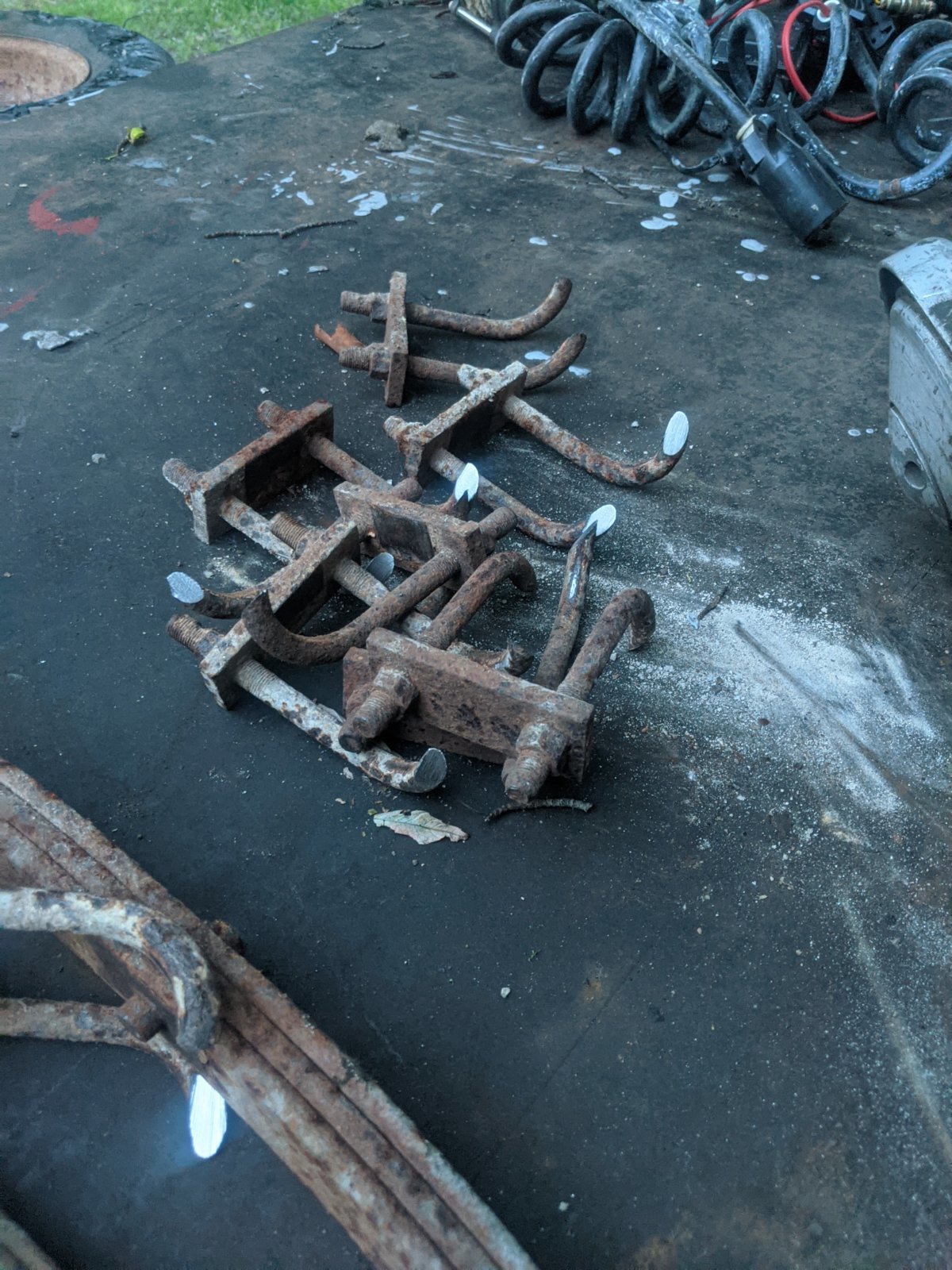

    Cut the ubolts off the donor axles.
    I went back and forth on saving and using them. $40 bucks for new ones and I know they quality.
    With doing that I was able to inspect the springs. Springs look great. The only thing I need to decide is if I want to remove a leaf.
    This trailer is only going to haul 2600 lbs max. Half the time, I will be hauling it empty. Removing a leaf will make it less rough when hauling empty...of course will be half the time.

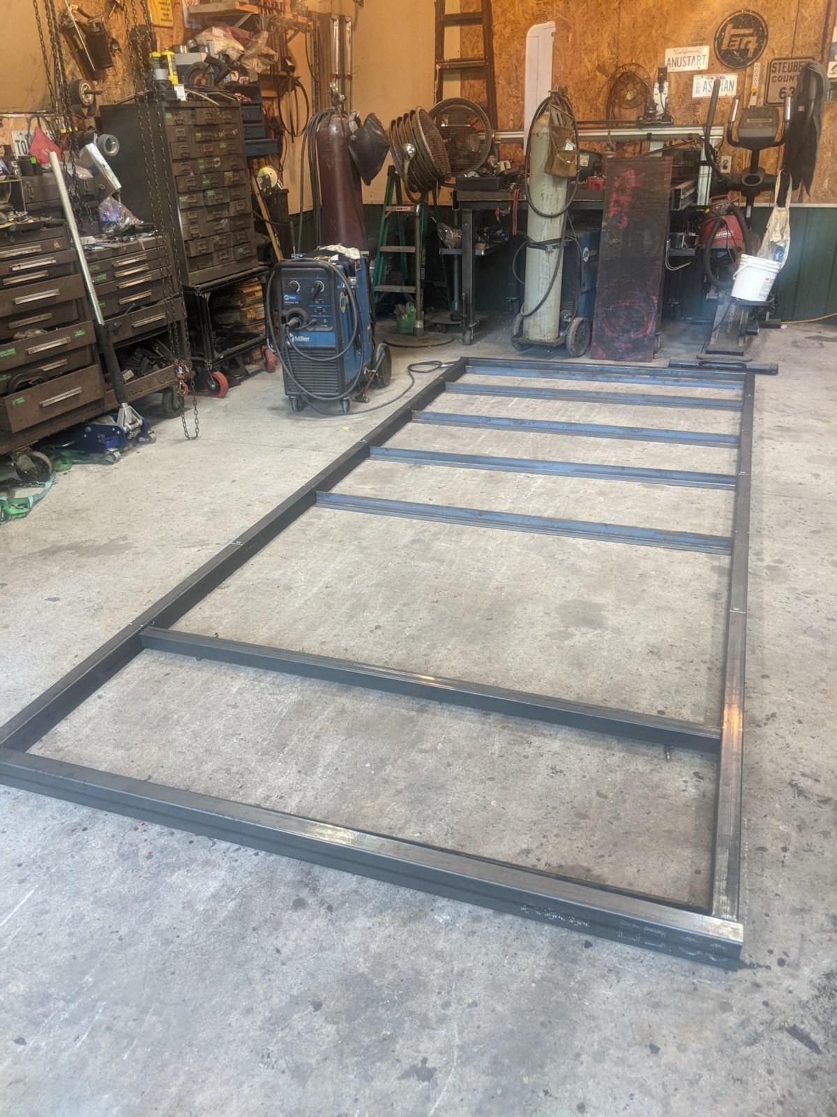

    Frame is squared and most of the x members have been tacked in place.
    It will sit like this for a while. I need to fab up a bumper for the Tundra that is in the background.
