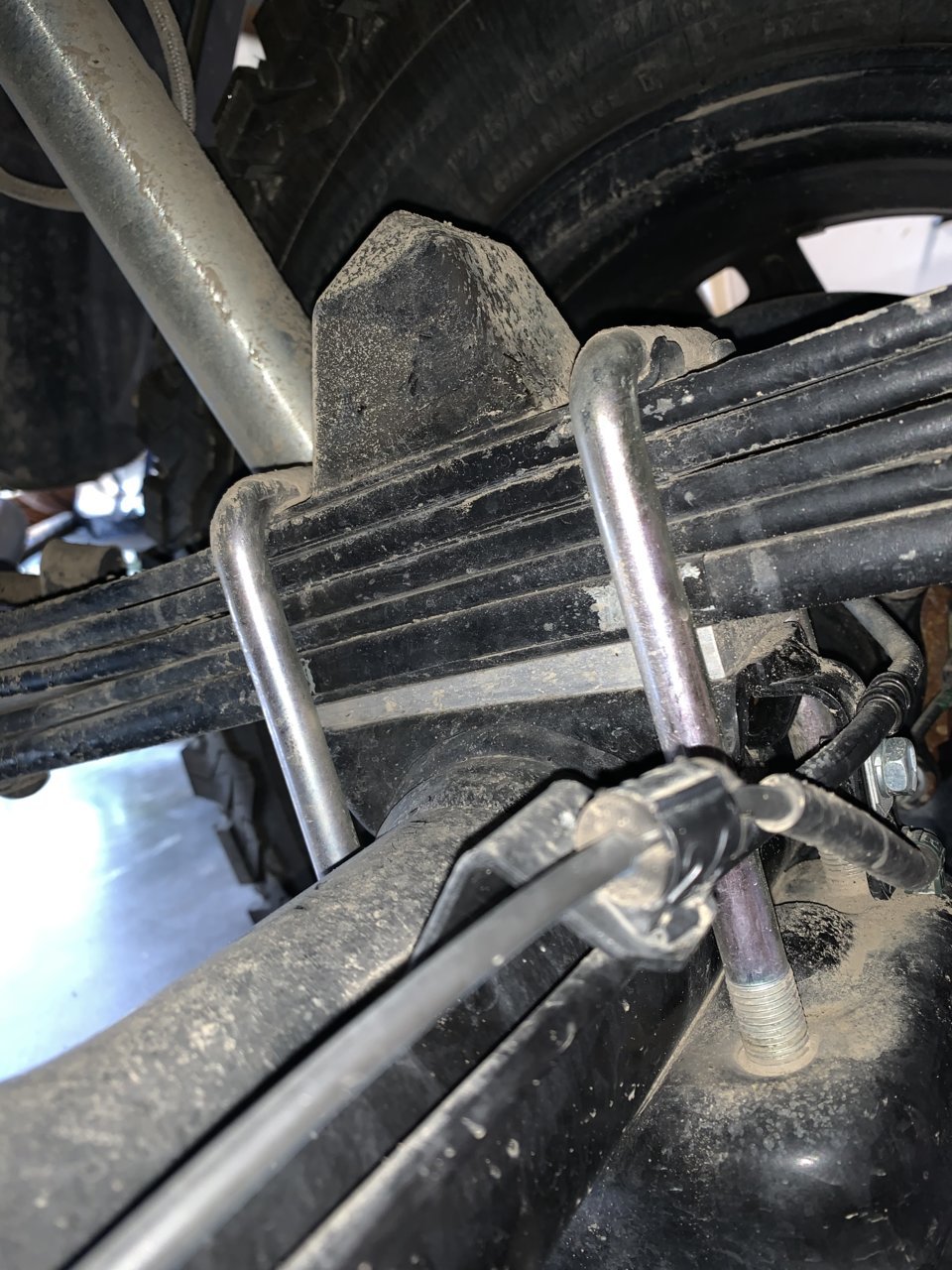

    I haven't installed them yet. I have them though, just waiting for a chunk of time to put them on. I went with the slotted shims from Head Strong.

    I'm following this thread. Just lifted my '19 TRD OR. Guessing it was 2.5-3" Immediately had a low speed rumble-strip vibration. Today I got the truck aligned , ECGS swap, CB drop, diff drop and a leaf spring shims put in. The shims were 6 degree which sounds like a lot. The vibrations are lessened but still there at low speed. Gotta find time to check my driveline angles to see if I can tweak anything. Might go away if I put the RTT on the truck.

    Im getting ready to mount my RTT once my bedrack gets here next week so ill let you know if it takes care of my vibes. My buddies 2020 SR5 has the same vibe and he has 800 miles on it and its bone stock.
