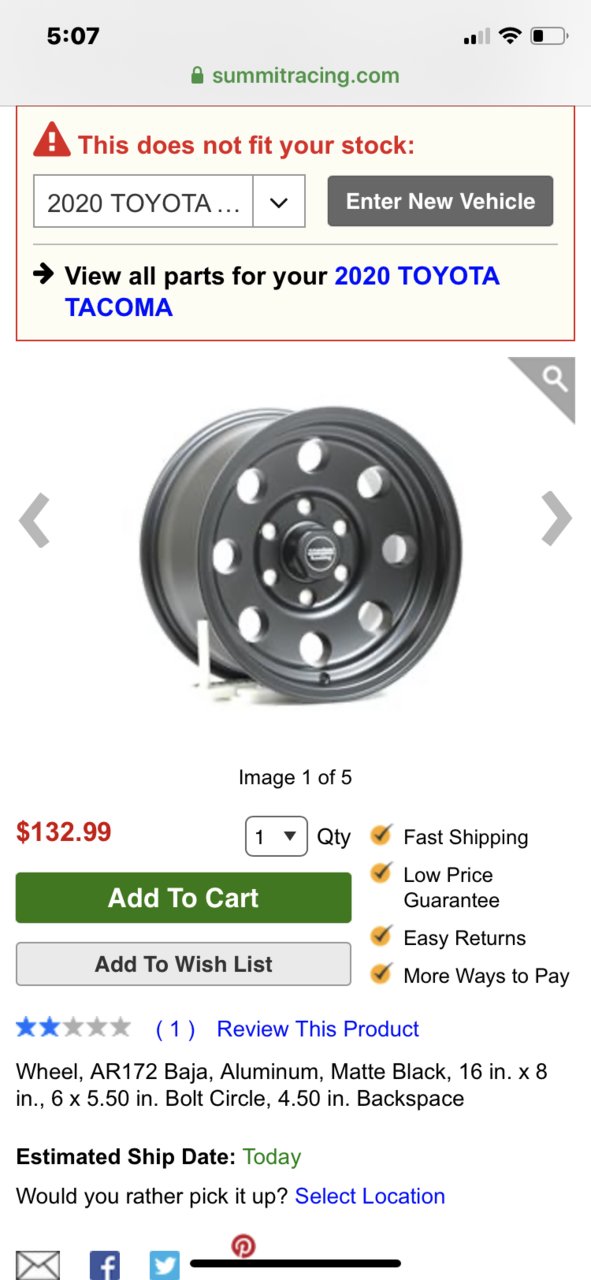

    Just found these online but it says they don't fit my 2020 OR model. 16 x 8, 0 offset, 4.5” bs. Shouldn’t they fit?
    I’m thinking about going to -6 or -12 offset. Anyone using this measurement??

    Hub bore might not be right Tacoma hub bore is 106.1, Tacoma's are hub centric.

    Looked on AR website the bore for that wheel comes in a 108 mm hub bore. You could get hub centric ring's to bring it down to the 106.1 Tacoma hub size. Never done that, always bought wheels that are made for truck/car. But I know others that have, if your heart is set on them.

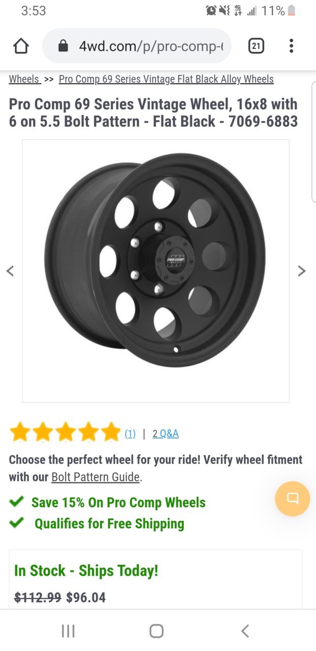

    These will fit. I'm not sure about the ones you posted.
    tomwilson74[OP] likes this.

    Aren’t TRD OR wheels 16 x 8? I put the info of my vehicle in and all the rims listed to fit are 16 x 7.

    Stock is 16x7 or 16x7.5

    Pretty sure they're a 16x7 with a 25mm offset.
    If that's the case, based off of the wheel size you chose, a 16x8 with a -6 would stick out past the current edge of the wheel 1.72" and a -12 would protrude an additional 1.96". You'd gain 0.96" of backspacing with a -12 and only 0.72" with a -6. I'd advise against it for the simple reason that the stance of the truck will have the tires past flush with the fenders and they won't tuck properly under suspension compression.
    Feel free to stick a tape measure against the top lip of the rim, look straight down and where the 1 3/4" and 2" marks are about where those rims would sit.I hope that helps you visualize and understand why they'd say it doesn't fit.
