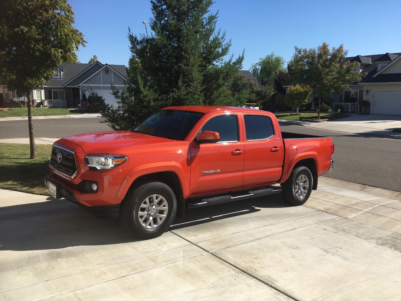

    I've done a fair amount of poking around on the site but was hoping to get some feedback before I pull the trigger on the purchase.
    I've attached a picture of my current set-up - 2016 2WD SR5. What I'm wanting to do is add the 2" leveling kit to the front & add AR127 17x8 rims w/ BFG A/T KO2s. Everything I can tell with the offset from the current wheels (75190) 25mm offset to the AR172s 0mm offset 4.5" backspace is that I won't have any issues with the rim hitting the brake caliper or anything else. Can someone with good knowledge of wheels confirm this? My intent is to create a wider stance with the wheels and tires protruding out of the wheel well more than what the stock does.
    2nd question is what is the biggest tire I can fit with the 2" leveling kit and still not have any rubbing? I know if I kept the stock rims and suspension I can fit 265/70 R16s, but with the extra room I'd like to fit as big a tire as possible.
    Please save the barbs on the leveling kit, I understand what I'm getting in to. This is after all my daily driver and a 2wd, so any offroading is done very sparingly.

    The AR172 Baja wheels in 17"x8" 0mm offset and 4.5" BS will clear and fit just fine. You can easily fit a 265/70-17 tire as well. If you'd like to go to a larger tire be ready to do some trimming, the wider stance paired with a wider tire will create some areas that rub and need to be trimmed.
