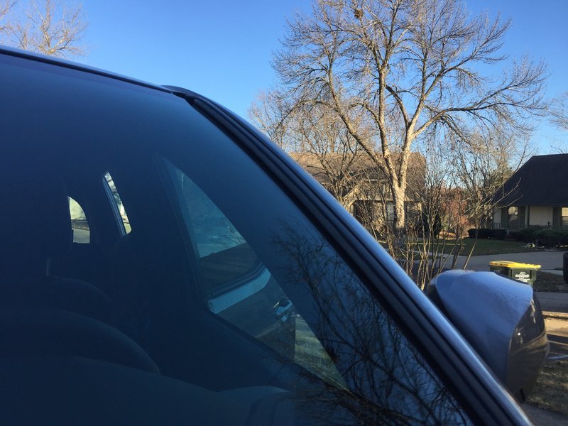

    I have a 2017 DCSB that I like. I have no transmission issues. I think the truck has good power, gets decent mileage and I am generally happy with it.
    However, it has wind noise. Nothing strange, just loud, like the windows are open.
    I checked my gaps and seals and they are all tight. I tried putting some 3/8 round foam under the door seal and maybe it made a minute improvement, but I don't think so.
    I did take 3/8 foam and put it in the channel on the sides of the windshield. I'm not sure why there is moulding with a channel and sharp edge on the side of the window, but there are. The stuff I used is called caulking saver and I got it at the hardware store. It's 3/8" and round. It's foam so it can be easily stuffed into small places.
    I noticed a large improvement in noise, but I need to leave the foam in there for a week and see if that changes.
    Has anyone else experimented with this?
    If it is an actual success then I will find a black more rubber/silicone material and make it permanent.
    Thoughts?

    Call Toyota customer service, get a incident #, and take it to the dealer, that's what warranties are for. There are some other threads about this, and other people think it's the A pillar causing the noise.

    Hopefully they do. I don't see any point for the channel in the moulding. Maybe they can make a replacement

    I think the channel is meant to divert rain up and over the truck so water doesn't come in a partly open window. My 2004 Tacoma had the channel but when I had the windshield replaced they used a flat insert and water would dribble/splash in if my window was partly open (didn't before).

    I have the same noise. But I know its not from the A pillar ,my wires for roof lights go into that channel. I let someone drive the car while i sat in the back seat. The noise is definitely coming from behind the seats.

    There is a lot of noise that comes from behind the seats when you lay the seats down because the back of the cab has no sound insulation. Toyota's depending on the seat cushions to be the acoustic absorber. I know this because I removed the interior of my truck a couple weeks ago for some aftermarket projects.
    The channels on the sides of the window frame are to channel rain water up and over the top of the cab rather than push the rain around to the side windows. It's useful to us guys living in rainy regions.
