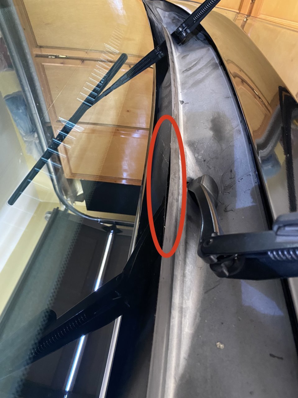

    Recently had my windshield replaced and noticed this gap at the bottom plastic cowl. Is it fine like that or should it be pressed down all the way? Is the glue suppose to hold it down? I tried pressing it down and it still lifts. Where would water lead to:confused:

    Who ever replaced the shield didn’t do a good job, It may not leak today but I would have them redo the gasket

    See if the plastic shroud is secure, when I got my windshield at safe lite they broke most of the plastic pins and it was just flopping in the wind and they replaced it and the window because it was instald wrong to.I will not take it there again

    It probably won't matter much cause it's not a perfect seal from the factory It will not leak in your cab if they put the window in correctly

    Ah crap guess I’ll give them a call. Would you happen to know where water leads to under the gasket? Looks like it’s just into the engine bay.

    Just checked the shroud and the pushpins. Drove it around around today and it’s secure along with no additional wind noise so i would say seal around the windshield is good. Hopefully that stands with no water leaks after I wash it next weekend.
    Agreed. Noticed some slight distortion on the upper right corner. Not enough to bother me though. I ended with a Fuyao aftermarket replacement.
    Guess this answers my previous question. Thanks a bunch. What brand windshield did you get? I’ve always read threads about how easily chipped 3rd gen windshields are and how some are on their 3rd replacement. My OEM lasted 5yrs, 90k miles. I’ll be happy if this Fuyao does the same. I know Honda uses them and they have a plant in the US.

    Whoever set the windshield set it too high. If it was safelite then have them warranty it.
    Third gen glass is tough to set for people who aren’t use to working with it. The side moldings come pre installed on the glass so if you set it incorrectly the installer is screwed because the moldings fit so tight against the body you can’t make height changes after the initial set. Most glass has distortion some are worse then others at certain angles. The urethane is used to seal the windshield. No urethane is used on the cowl. On the third gen the windshield needs to be low enough to the cowl to hook on the plastic fingers but not to low to have a excessive gap on top. The top under lay should have around a 45 degree angle from the glass to the roof line.

    Oem windshields can have distortions as well. Pilkington is Toyotas oem. But I’ve noticed glass quality has gone down across the board since Covid. So it’s hit and miss. Even if you inspect the glass prior to install you may not see a distortion until the glass is set at the right angle.
    As far as shitty installers… yeah like any job some people are hacks and don’t give a shit.
    Also check the a pillars inside to make sure the urethane isn’t oozing out from the glass. Could indicate improper gun angle when shooting the bead.

    I would want it fixed. But looking at the trim… as stated above throw some trim dressing on that plastic. I use

    After a second look after this guy comment I think he is right or is that the reflection from the cowl

    Either way I would not attempt to seal it myself I would take it back and tell them to look it over and fix it.

    That's a pretty good gap. Better not touch it. Let them fix it.

    Spray the windshield real good with a garden hose. If you see water below the dash take it back to the glass place.
